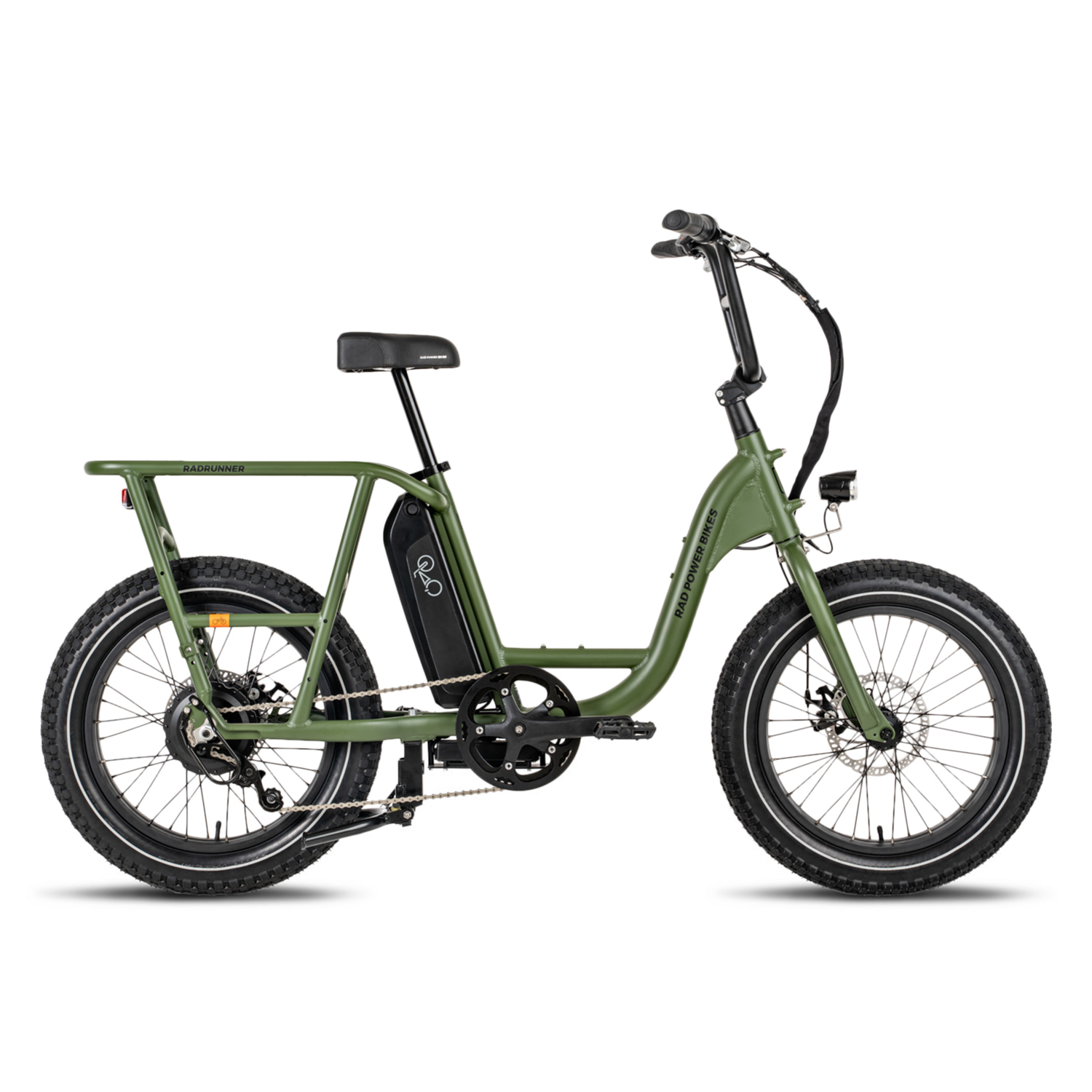

I just found a product image that has no background obscuring anything and bright lighting. Its a vertical dropout. I'd have been very surprised if it was anything else.
This is so commonly done I don't blame Rad for doing it, but its such a long-known problem it was only a matter of time before a lawsuit came about over the issue. That article I originally linked was from 2016 and was a more recent arrival in terms of defining the problem. BTW google 'lawyer lips' if you are not familiar with them. I would imagine the Rad forks must have them.
One fault I do see is that I always put the quick release lever on the brake side of the fork and as shown in the pic above it is the opposite which I am not saying is the bike involved in the accident? Not sure if it really makes any difference as it is the correct amount of tension that is applied to it that assures it will not come out as the lawyer lips that should slow things down if it does. So many new riders don't understand how a quick release works IMNSHO and in this age of online sale bikes it is at least a good thing that youtube is around for guidance if anyone cares to look for information on the correct way to do it.
Maybe I am seeing it wrong but looks like a sloping dropout to me?
I also missed where it said that the front wheel came off vis a vis out of the dropouts to begin with? The way I read it was that they experienced a speed wobble effect that I would attribute to the small wheels and 11yr old girl arms on the handlebars compounded by the weight the other girl on the back going downhill and not being able to brake properly?
100% it's a skewer with obvious offset from the photo...
Looked up the EBR review (where the pic is from) - "135mm Hub Spacing, 9mm Axle with Release Skewer" (and the same as the RR 2).

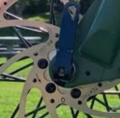

I think the pic I posted from the EBR review shows more clearly, even with the QR, that it's a closed, offset dropout.
I mean, you can clearly see the green fork underneath the QR. If it were a vertical dropout, the slot would be an inverted U shape, not circular, and we see the bare steel of the disc brake, as opposed to the continuous green paint of the rest of the fork - using lawyer lips ;)

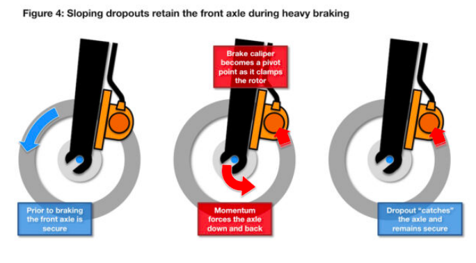

QR on a fork with a disk brake is USUALLY prevented from being an issue at high speed with putting the fork dropouts angled forward. I'd bet money the Chinese didn't bother with that and used old-school vertical dropouts. Which is fine so long as you keep enough tension on the QR bolt. But you can't control whether that happens when consumers who don't pay attention to basic maintenance are factored in.

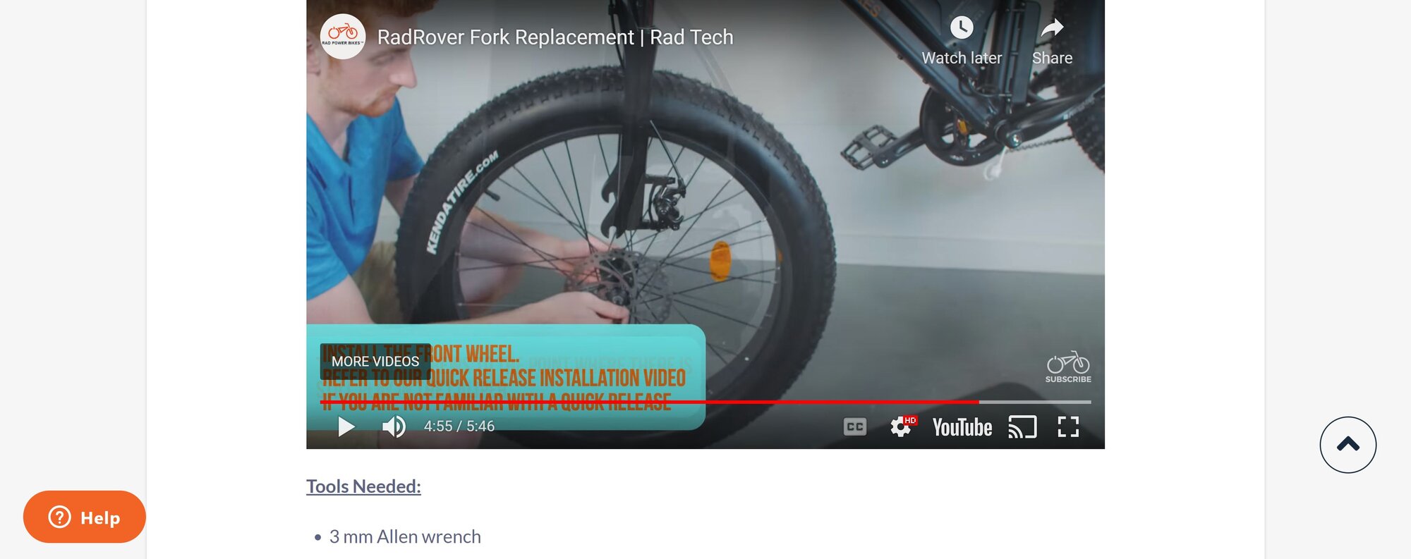

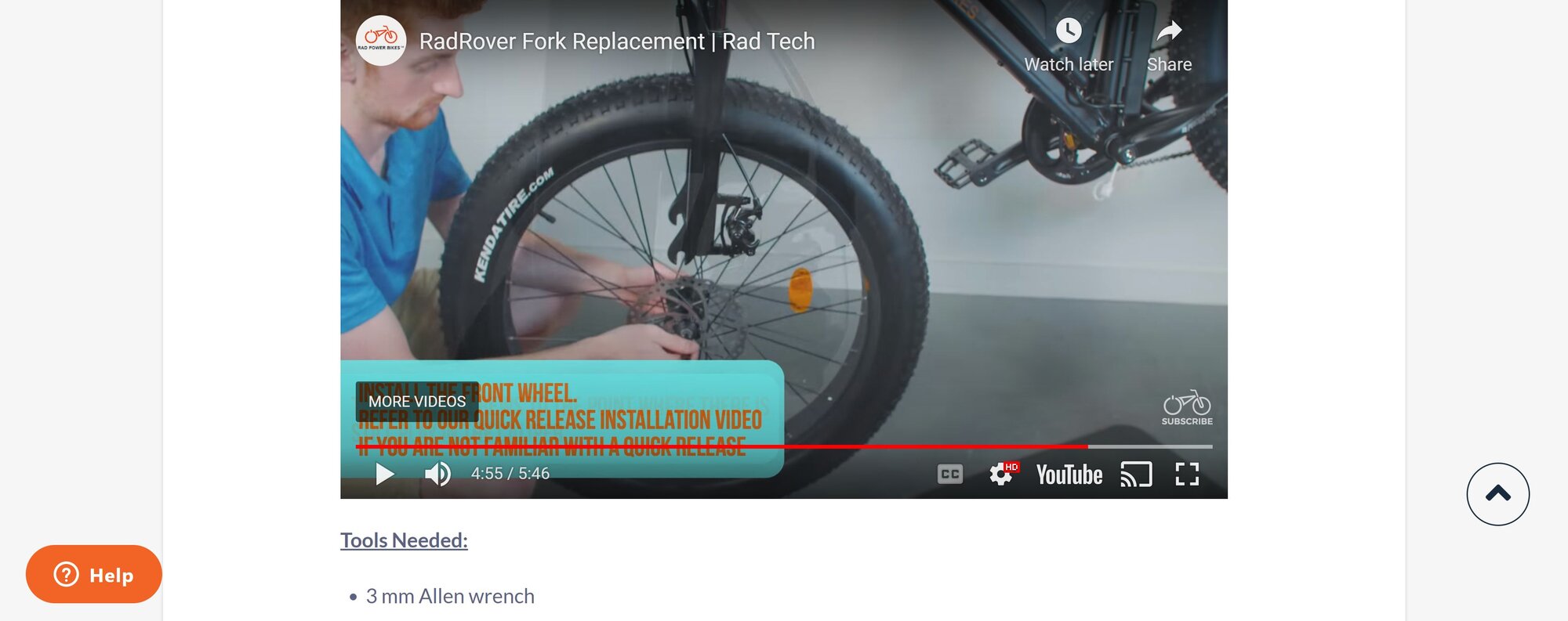

screen shot off Rad tech page with video of how to replace a fork on the Rad Rover. Clearly a straight up and down dropout.
FireShot Pro Webpage Screenshot #042 - 'RadRover Front Fork Replacement Guide – Rad Power Bike...jpg
Thats not a circular shape. There's a break in the bottom - the black segment - which is the QR dropout and thats your inverted U. A 'vertical' dropout doesn't have to be dead on vertical to be so. This is a 2048x2048 image that is pretty clear. Its a typical dropout. Look at the QR skewer and picture how that must be the center of the dropout at its apex. It is probably a hair set back. But if so its nothing like it would be to address the issue.

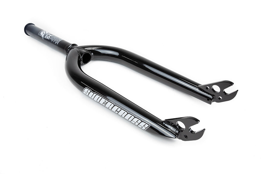

here's what an updated style of fork actually looks like. Quite different and VERY obviously more extreme than what the Rad Runner and most other QR forks have. Pretty much a 45-degree angle and thats before you factor in the extra rake that comes with being installed on the frame.

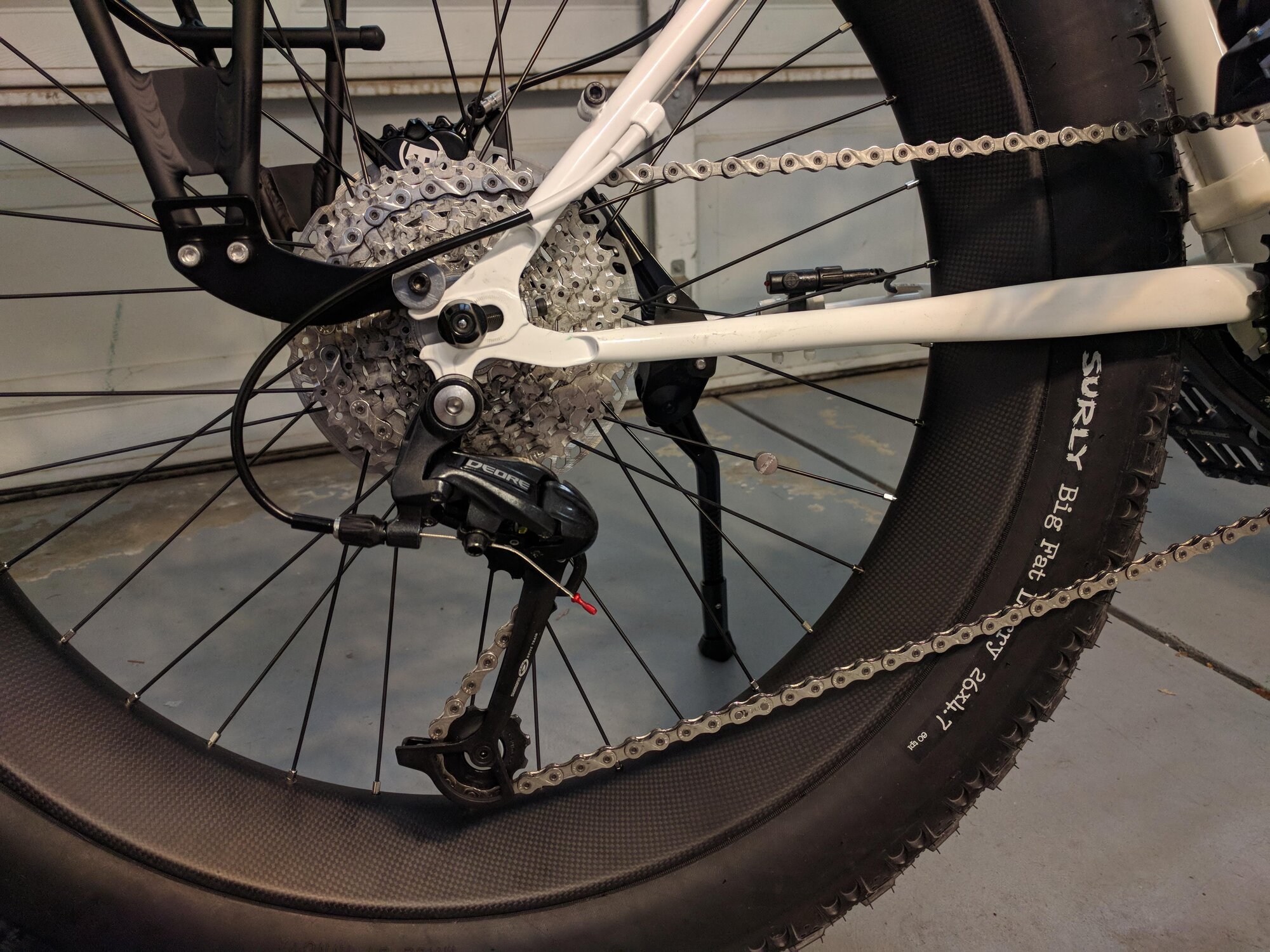

That can't be a problem on the RR rear wheel due to the egg shaped washer that is screwed to the frame.
It can't be because the RR has vertical dropouts in back. I don't know why any bike manufacturer uses horizontal dropouts but they are a giant PITA. Not only can the wheel pop out of the dropouts in severe braking, it also - when there are no adjusters inside the dropouts - allows the rear wheel to be pulled forward out of alignment with strong pedaling. The chain pulls them forward on the drive side. Little screw-in adjusters can be built into the frame and fix that problem, at least.
I thought I edited my earlier post to correct myself, but guess I forgot to hit update. Stupid work... :)
The dropout isn't straight up and down though, as the rear of the bike is suspended in that screenshot... it's sloped, but not nearly as much as @m-robertson's example (maybe +/- 20 degrees?). :)
