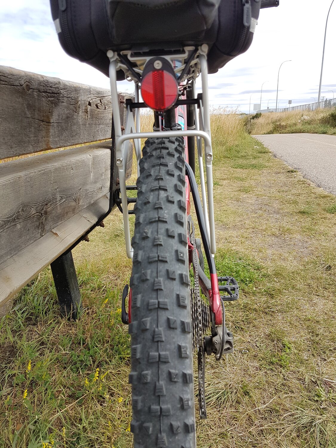

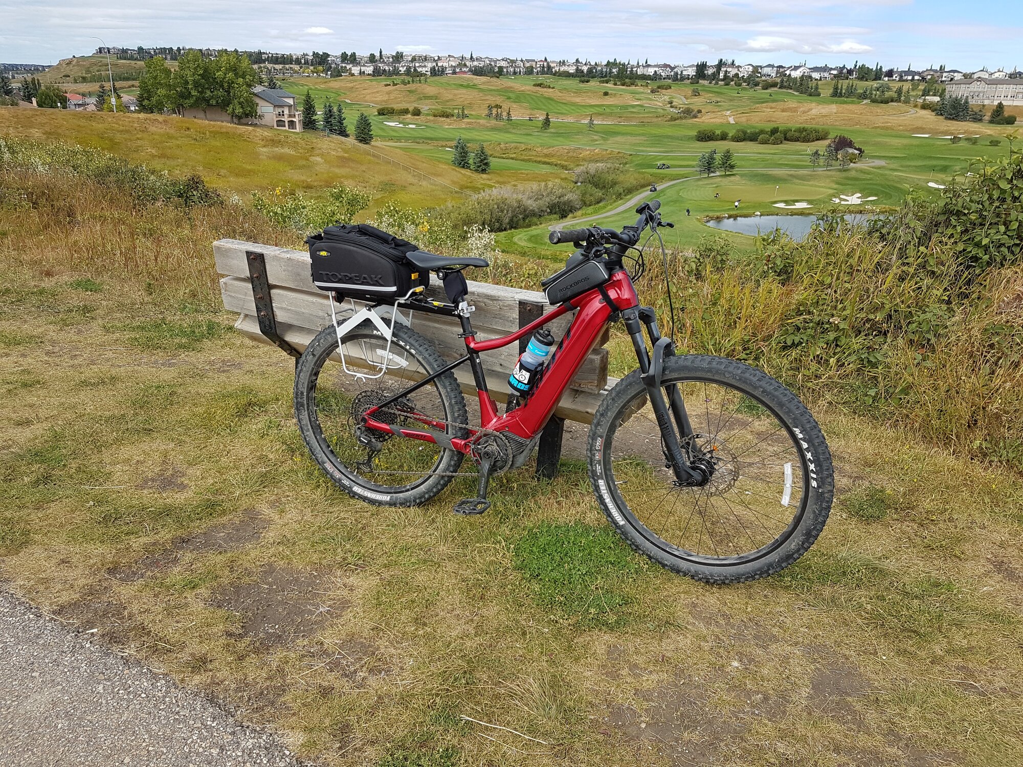

So I finally got back on the bike and tried the new rack assembly. Initial impressions were pretty bang on - very slick product. I rode about 30kms, with only stuff in the main compartment.
My first learnings is it is a significantly higher step over and my hips, especially right now, don't like it. That's OK as it was not dissimilar to my experience with my other bike. Simple solution is to just lean the bike over more.
Second learning is to avoid any significant bumps if you can. This is especially important with the side frames. Bumping around tends to have the whole assembly move a bit and can get off centre easily. I did not have my velcro strap solution installed as I wanted to see if it was needed. Next ride I will install them and see if I notice a difference. Unfortunately I'd forgotten to bring them. Also, I don't think the interaction with the suspension seat post was any problem.
I did not notice any difference in handling nor did I notice the weight. I am guessing that I had around 3.5 Kg in the bag (8lbs). All in all, pretty pleased with the purchase and it's function. Won't be used on "dirt days", but pathway days will be better with this on, especially when there are beverage stops as the trunk bag gives me a place to take a lock or three.
So I finally got back on the bike and tried the new rack assembly. Initial impressions were pretty bang on - very slick product. I rode about 30kms, with only stuff in the main compartment. My first learnings is it is a significantly higher step over and my hips, especially right now, don't like it. That's OK as it was not dissimilar to my experience with my other bike. A simple solution is to just lean the bike over more.
Second learning is to avoid any significant bumps if you can. This is especially important with the side frames. Bumping around tends to have the whole assembly move a bit and can get off centre easily. I did not have my velcro strap solution installed as I wanted to see if it was needed. Next ride I will install them and see if I notice a difference. Unfortunately, I'd forgotten to bring them. Also, I don't think the interaction with the suspension seat post was any problem.
View attachment 64843 View attachment 64844
Looks good, however I would replace the Velcro strap with a metal connection between the seat stays and rack. ;)
Looks awesome! Glad you're back in the saddle.
Just as a reference point I have done lots of shopping with zero fear of the pannier sides getting into the spokes. Yesterday I picked up shoes and 4 shirts, went for a joy ride on the way home. Jumping curbs, potholes etc with no worries. I cinch it pretty tight though.

So today was 50 km of pathway cruising with the rack. First stop was dropping a dozen freshly baked muffins at my mother's place. We just moved her into a Manor about 1.5 km from my place. We did it in March, as Covid was just kicking off, so it's been interesting. It's only been around 3 weeks where we can enter and go to her unit - with masks and other common sense rules to abide by.
Back to the subject. My velcro strap hack is a no go. By exerting the extra tension on the sideframes, each little bump exerts a tiny bit of downforce to the clamp, and at some point I found the rack rubbing on the rear tire at the cross support at the back. The creep is very slow, but it's there.
At about 35km I removed the straps for a comparison, and it worked better. This setup is never going to be as solid as my old bike's rack, but I knew it was going to be a compromise. I think it's a GOOD compromise however, but I think I won't be using it as much as I thought I might. Time will tell.
Try a metal band clamp with a turnbuckle spacer to resist compression... problem solved. ;)
Was considering something like that, but adjusted my mounting today and it was much better. At the end of a 50 km ride I had to stop at Safeways to pick up some steak and a few other things. I think it took me longer to secure my bike than it did to do the actual shopping! Today's ride included some minor single track along the Bow River, and the rack stayed put better than yesterday. I'm still going to have to decide what type of ride it will be before I go out. If off pathways with no security concerns, then the seat bag. If MUP and beverage stops, then the beam rack with trunk bag full of locks.
