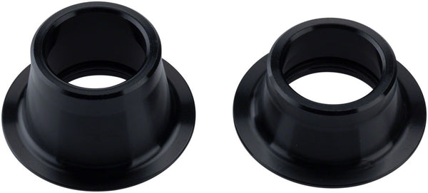

Front hub...my interim solution is these to replace the Giant endcaps:
I have the 15mm and 20mm of those fitted.
Have ordered these endcaps as my good solution and will report if they work:

For the front hub adaption from 12 x 100 to 15 x 100 my local Giant dealer was absolutely zero help, useless actually and couldn't be less interested. Disappointing after dropping thousands of $ there over the years and recommending them to others.
So... I'm trying a couple of options. Currently mounted the wheel up with some 15mm internal diameter/20mm external diameter steel spacers. I ordered these off eBay and they're normally used for ATV axle spacers! Just grabbed a pack of five in random sizing and was able to get two of them to work. My longer term potential fix is a set of Zipp76 hub 15 x 100 front axle caps! They were the closest thing I could find that looked like they would work well. Still waiting for them to be delivered.

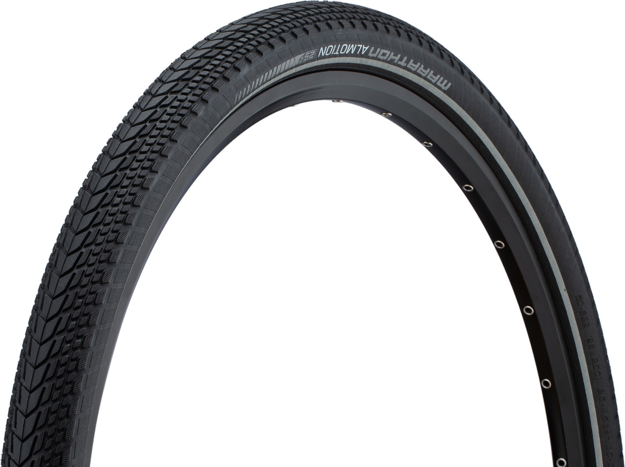

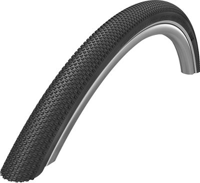

OK I think I have narrowed it down. It's a toss up between these two:-
or
If anyone wants a 2019 Quick e+ in Canada, there's a good deal here:
I decided to wait for next september and see the 2021models!
or
I was once thinking about those exact two tires and I really liked almotion. I'd say go for almotion but the widest one seems to be 2.15.
Was checking out the front wheel today to see what needs to be done to change it to accept a 15x100 thru-axle as opposed to the 12x100 it has now. Easy fix, the end caps just pop out, the rest of the hub is already setup for a 15mm axle. I had a 15mm axle from another MTB and slid it in to check the fit, works well.
I need to find a set of end caps that will work on this wheel for a 15x100 axle, so I will pop down to the local Giant dealer today and see if they can get them. Should be able to, as the same hub is used on the new Explores that have a 15x100 axle. Pics attached if anyone is interested. The setup is similar to a DT Swiss 240, but the measurements are different. Our wheels use 15267-2RS sealed bearings (26mm OD, 15mm ID, 7mm width) and the 240 uses 6803 bearings I think (26mm OD, 17mm ID). I think these hubs were originally based on a Formula hub, but good luck getting anything from them! End caps in the pics are for the 12x100 axle, the shiny bit goes into the hub body and reduces it from a 15mm ID to 12mm ID, I think there's already a 20mm ID to 15mm ID reducer installed in the hub from what I could tell. Everything 'north' of the shiny bit sits outside the bearing.
