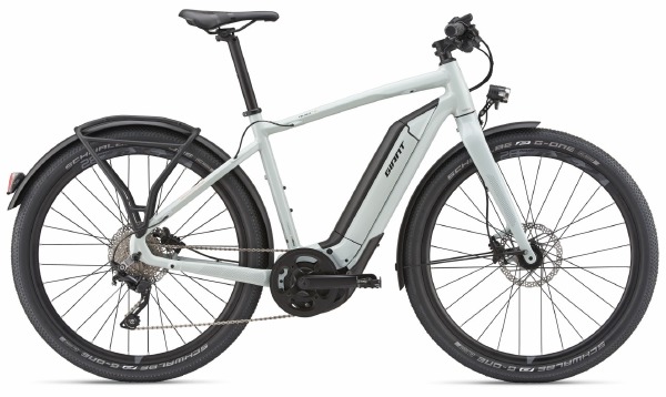

Clearance maybe an issue with the Super Moto X. Perhaps more at the rear.
Would be worth a wander down to Dyson and see if you can find one on a bike there and measure the profile at the widest point. Rim width will affect the measurement but it should give you some idea.
I was able to install super moto 2.4 on my 2016. I had to remove the the cable guide from underneath of the rear fender to get them to fit. It wasn't a problem since I updated my tail light and mounted it on the seat post.
