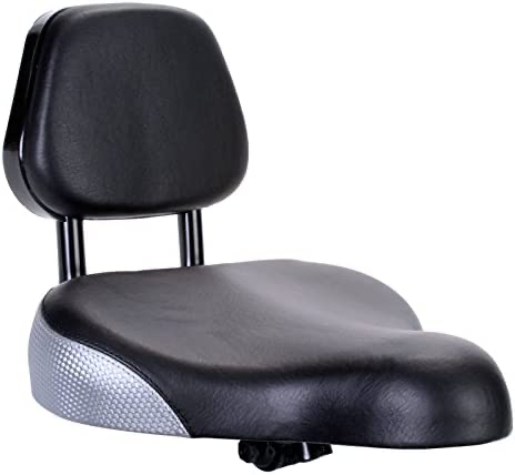

This is my new Day6 seat.
This on Amazon,

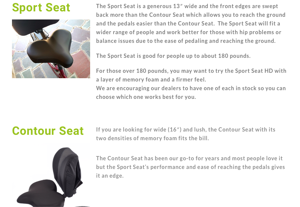

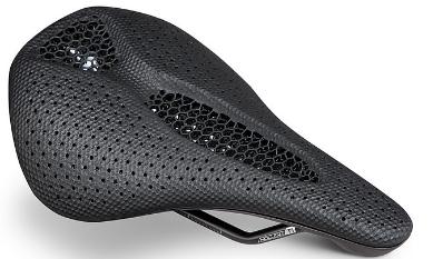

WIDTH is the issue, I'm thinking.
The Specialized Power Pro with Mirror at the back is wide, but not as wide as your reference photo, so I'm of the belief I need narrower at the back.

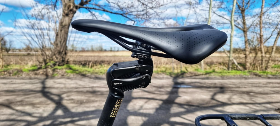

Guru. I have gone through the same for 3 years to understand that you cannot have painless rides if you sit upright on the saddle. A big part of your body weight must get supported by your arms (that's why ultramarathon gravel cyclists survive; same with roadies on the races). It is also good for your spine and lower back, eliminating numb hands.
Eventually, I ended up with two saddles, one for each respective e-bike:
  • The stock Specialized Bridge Sport (Vado SL)
  • Specialized Phenom Expert (Vado 6.0).
What I actually did to relieve my butt was:
  • Lowering the stem as deep as possible (Vado & Vado SL); using a longer stem on Vado SL to increase the Reach;
  • Installing Innerbarends (these two actions let me comfortably ride in the forward position);
  • Playing with the saddle angle and setback, so my perineal area (in chamois or not) resides in the "valley" of the seat, with buttocks almost hanging from the saddle.
This is the setup of the saddle ideal for my body. Neither the "nose" nor the rear part of the seat exerts any stress on my body. (Note: For the final setup, I shifted the saddle towards the front of the bike a little).
Guru: You have my Strava and could see my 50 mile ride of today. Trust me: There was not a single moment I needed to think of my butt! Before, I had serious problem with boils/puss (or whatever the English words for that are).

i am not sure the relatively narrow mirror saddles are appropriate for the riding position of your Vado. narrow road saddles are designed to not chafe your legs when you’re in a low, forward position, with your weight on your legs, not your backside or hands.
that said, i found the Romin with Mirror better for me than the Power Mirror because it is a lot narrower in the area between the legs, where you do not want any contact. getting your sit bones on the saddle is key but i do not believe road bike saddles like these are really meant to fully “sit” on for hours at a time. CG of a road bike rider is way forward of the saddle, roughly over the cranks. not sure that’s true on a Vado.

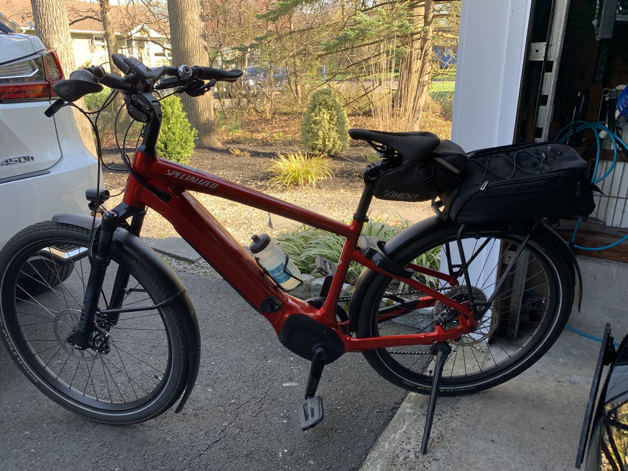

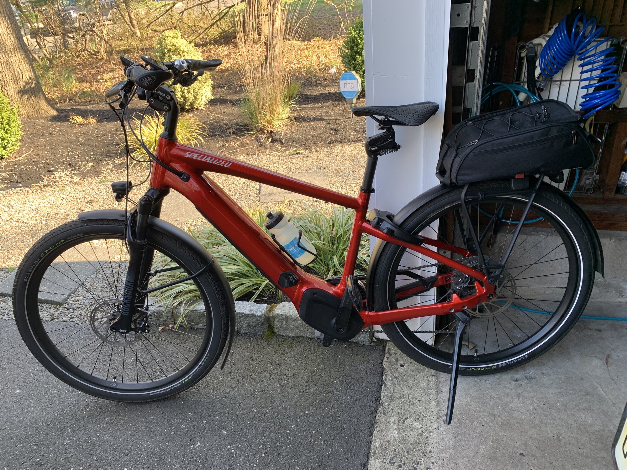

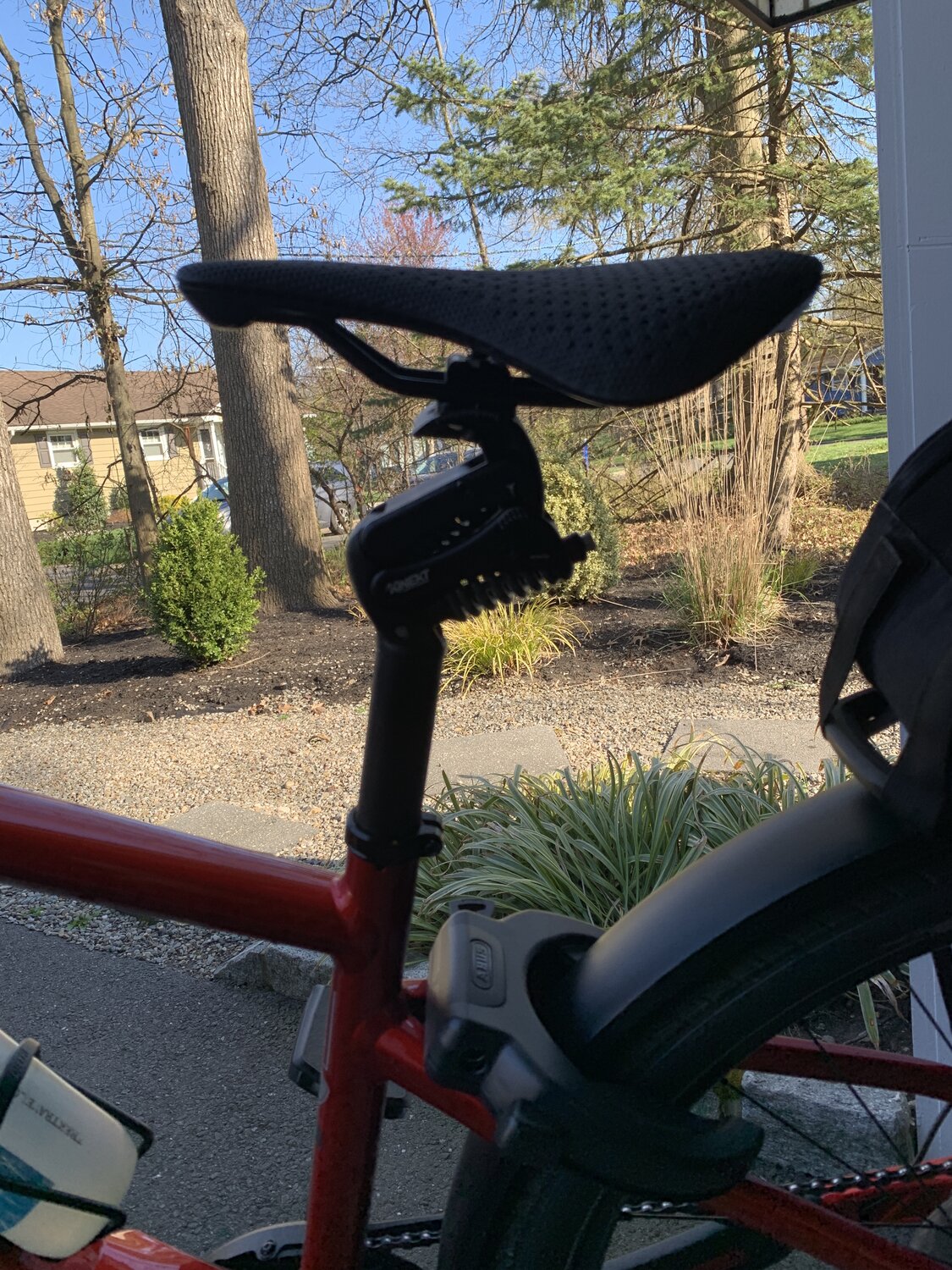

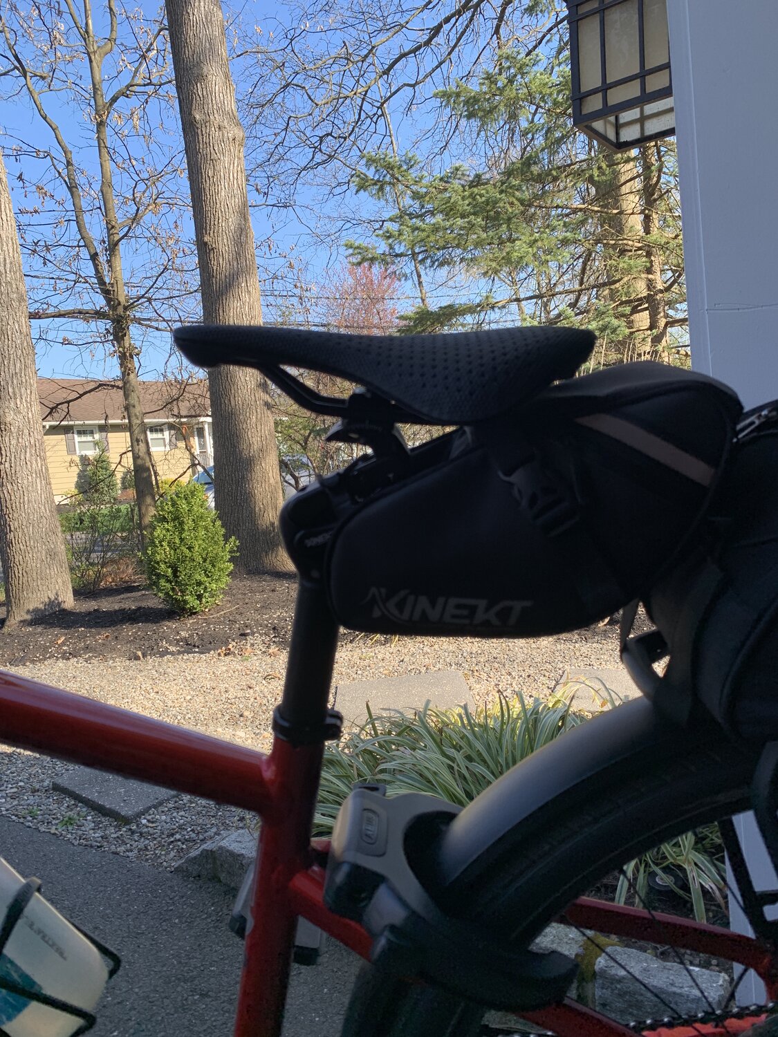

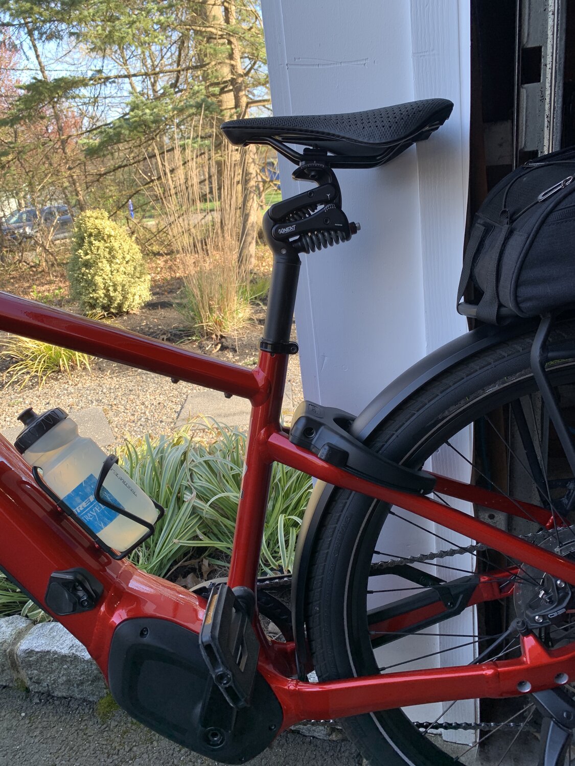

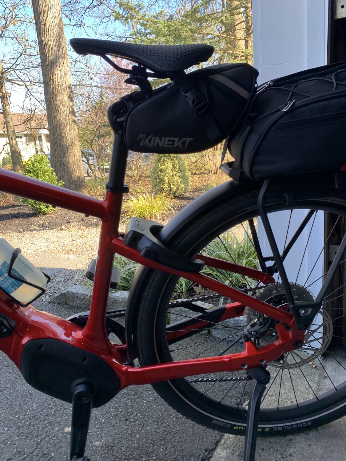

Following up regarding the questions (and answers) specific to this discussion.
I, am 72 years old (in 2 months), 6'0", 222 lbs.
My Vado 5.0 is a Medium size. I had Large before, and came to find out that a Large was a misconfiguration for my sense of everything, and the Medium feels like a well fitting glove in every respect.
I looked at the settings of Stefan's seat, and adjusted mine to simulate to see if it makes a difference. I'll know in a day or two, as I did not ride today.
Previously, I had made many adjustments as with the assistance of a 'professional' LBS fitter, so who is to say what is right or wrong.
HOPEFULLY, it is only these tweaks that make a difference.
The Como handlebars make my riding much more enjoyable rather than leaning forward and putting my weight on the handlebars. I've used a Kinekt saddle seatpost for years, since the day they were invented. I also tried and dismissed the Redshift post.
Attached are before settings of the seat and after.....(not validated as of yet if they made any difference)
(1st 4 are before, last 2 are after)
nice bike!
… but i strongly feel you have the wrong type of saddle for your position on the bike. if getting a little more weight on your legs and hands isn’t an option, a wider, flatter, squishier seat may do the trick. just don’t expect to pedal too hard!

The 'after' pic shows a saddle that has been installed beyond the max limit on the rails, based on the pics I have found for that saddle. That is a dangerous position to put that saddle in. I would expect it to be at risk of snapping. If you need that much setback on the seat, then you have a fitment issue. Ordinarily that means a seatpost with more setback, or a stem with more length (yours is already 90mm) or a longer top tube on the frame or different sweep on the bars. I see you have the Kinekt stem. If you are bottoming that stem at all, be advised there is an extra-heavy spring and a special bump stop upgrade. That finally kept me from bottoming mine on the ones I have.
The only way I can see to keep all your expensive parts is to a) move the seat forward and b) get different handlebars with a reduced backsweep to give you back the 2 cm of reach you need to give up to put that saddle in a safe position. But that will have implications for your wrist angle.
Or just move the seat forward so it is within its safe adjustment range. Doing that, though, might increase leg chafing at the bottom of your pedal stroke. Possibly thats why you moved it so far back.
The angle of the saddle in the 'after' pic looks a lot more appropriate. In the 'before' pic it looked like what you see downhill riders use. IIRC that original upward angle definitely puts pressure on your perineum if you are riding/pedaling.
