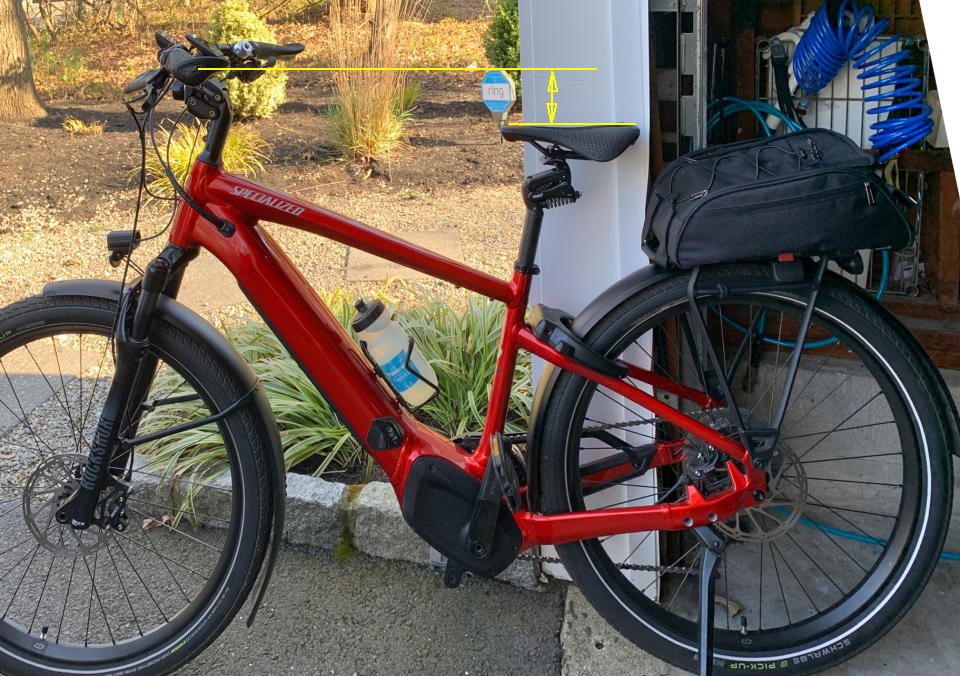

I, am 72 years old (in 2 months), 6'0", 222 lbs.
My Vado 5.0 is a Medium size. I had Large before, and came to find out that a Large was a misconfiguration for my sense of everything, and the Medium feels like a well fitting glove in every respect.
I looked at the settings of Stefan's seat, and adjusted mine to simulate to see if it makes a difference. I'll know in a day or two, as I did not ride today.
Previously, I had made many adjustments as with the assistance of a 'professional' LBS fitter, so who is to say what is right or wrong.
HOPEFULLY, it is only these tweaks that make a difference.
The Como handlebars make my riding much more enjoyable rather than leaning forward and putting my weight on the handlebars. I've used a Kinekt saddle seatpost for years, since the day they were invented. I also tried and dismissed the Redshift post.
Attached are before settings of the seat and after.....(not validated as of yet if they made any difference)
(1st 4 are before, last 2 are after)

The 'after' pic shows a saddle that has been installed beyond the max limit on the rails, based on the pics I have found for that saddle. That is a dangerous position to put that saddle in. I would expect it to be at risk of snapping. If you need that much setback on the seat, then you have a fitment issue. Ordinarily that means a seatpost with more setback, or a stem with more length (yours is already 90mm) or a longer top tube on the frame or different sweep on the bars. I see you have the Kinekt stem. If you are bottoming that stem at all, be advised there is an extra-heavy spring and a special bump stop upgrade. That finally kept me from bottoming mine on the ones I have.
The only way I can see to keep all your expensive parts is to a) move the seat forward and b) get different handlebars with a reduced backsweep to give you back the 2 cm of reach you need to give up to put that saddle in a safe position. But that will have implications for your wrist angle.
Or just move the seat forward so it is within its safe adjustment range. Doing that, though, might increase leg chafing at the bottom of your pedal stroke. Possibly thats why you moved it so far back.
The angle of the saddle in the 'after' pic looks a lot more appropriate. In the 'before' pic it looked like what you see downhill riders use. IIRC that original upward angle definitely puts pressure on your perineum if you are riding/pedaling.
Good catch on the saddle rails.
He could change the stem to 120mm. They are available for both road bikes and MTB. I tried one, they really slow down the steering and offer a lot of turning torque for certain types of riding. It would add a little more than an inch over the 90mm. Fitting is a tricky thing; you change one thing, and it has a ripple effect of unknown consequences. Maybe the medium frame is just too small for a 6-foot-tall rider.

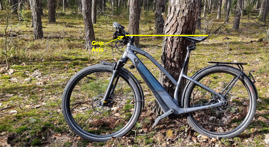

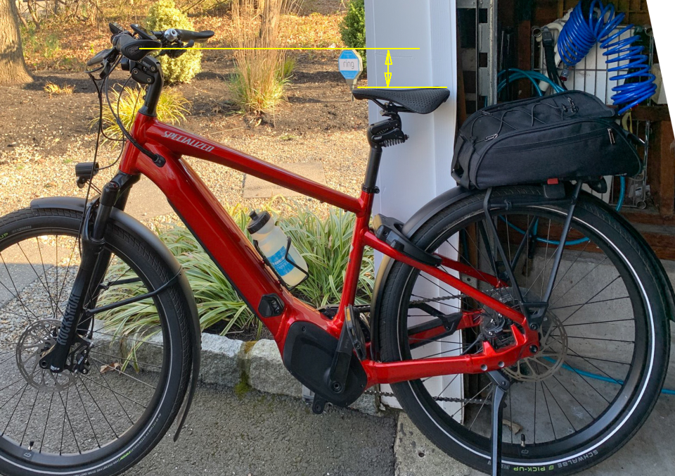

After studying the photos, the very upright position with the drastic seat offset == yeow, easy to see why it's so painful.

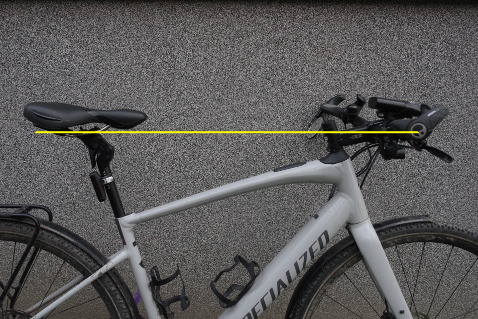

I'm no pro, but after fiddling with my Vado for ~10 months now, imho you have completely munged the bike - you have turned it into an upright riding position with a fitness geometry. I too tried that and immediately realized how uncomfortable it is. Sitting back and upright, pedals/BB somewhat forward of your position - even with a comfortable reach, the position is awful for efficiency and overall comfort.
In addition to what @m@Robertson has shared, let me share an anecdote. I picked up yet another regular bike this weekend - Sirrus X 2.0 in size L. After a trial run, I discovered that most of my weight was on the handlebar grips. While riding, I sensed I could have a wooden or steel saddle and it wouldn't matter (except for thigh chafing) due to weight distribution - it was completely comfortable on my backside since there was so little weight on the saddle. However, my wrists and shoulders were aching.
I then swapped on my Vado handlebars, which have more rise and backsweep - placing more weight on the saddle and much less on the handlebars/grips as it pushed me back & more upright. Then the saddle was very uncomfortable (very low-end saddle comes on the Sirrus X 2.0). Swapped in the saddle from my Vado, fiddled with angle and setback, pivoted the handlebars a bit forward, and the fit, comfort, and "rideability" are incredible. I am in a somewhat "athletic" position with excellent weight distribution, which is the intent of the bike.
Your position is the exact opposite - looks as if all of your weight is on the saddle and the handlebars are there just to hang on and steer, while you churn against and on the saddle.
If I may, in addition to the above, I would suggest fiddling:
  • Pivot your handlebars a bit more forward so you are leaning in a bit and adjust saddle angle.
  • Try the stock seatpost - not for compliance, but solely for position.
  • Heed the words of Mr. Robertson by trying different saddle positions.
Cannot agree more.

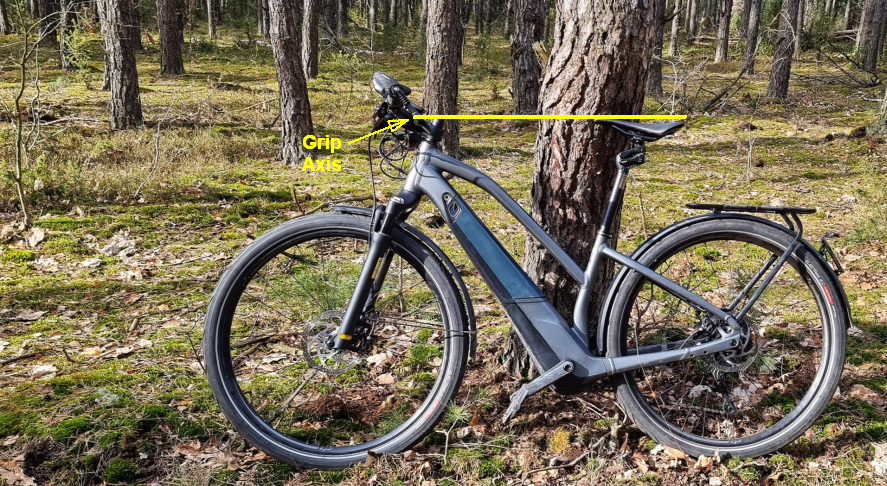

Body weight spread among the arms, legs, and butt. The saddle is level, only it has a "valley" for the perineal area. Note: I currently weigh 214 lbs at 5'8".
Stem riser and comfortable handlebars make almost all the body weight shifted onto the butt.
Also, notice a big difference in "Reach" between these two pictures.

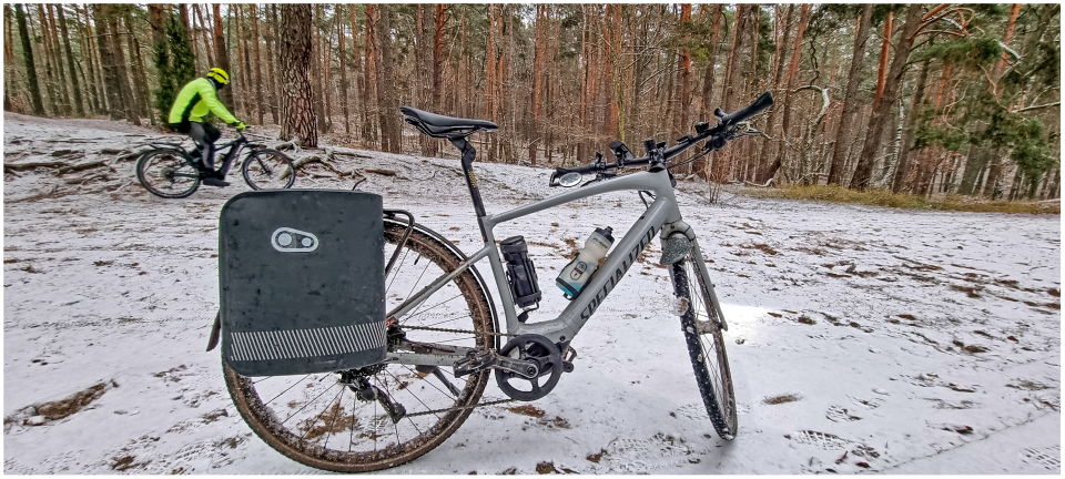

Not saying much, these saddles do not look as ones helping the pedalling. Again, the whole body weight is shifted onto the rider's butt. Good for a 5-10 mile ride maybe.
a sub par ebike
If I ride a sub par e-bike then the OP could feel insulted a little bit :)
It probably comes with $200 saddle.
Ask the OP what his saddle cost :D
This photo comes from the time I could manage my riding position properly, only the "comfortable" saddle was too wide. I made an experiment and restored the stock Bridge Sport saddle to Vado SL. Now, I 'm making a Gran Fondo (80 mi) and the butt is the least of my worries...
A more current photo.
