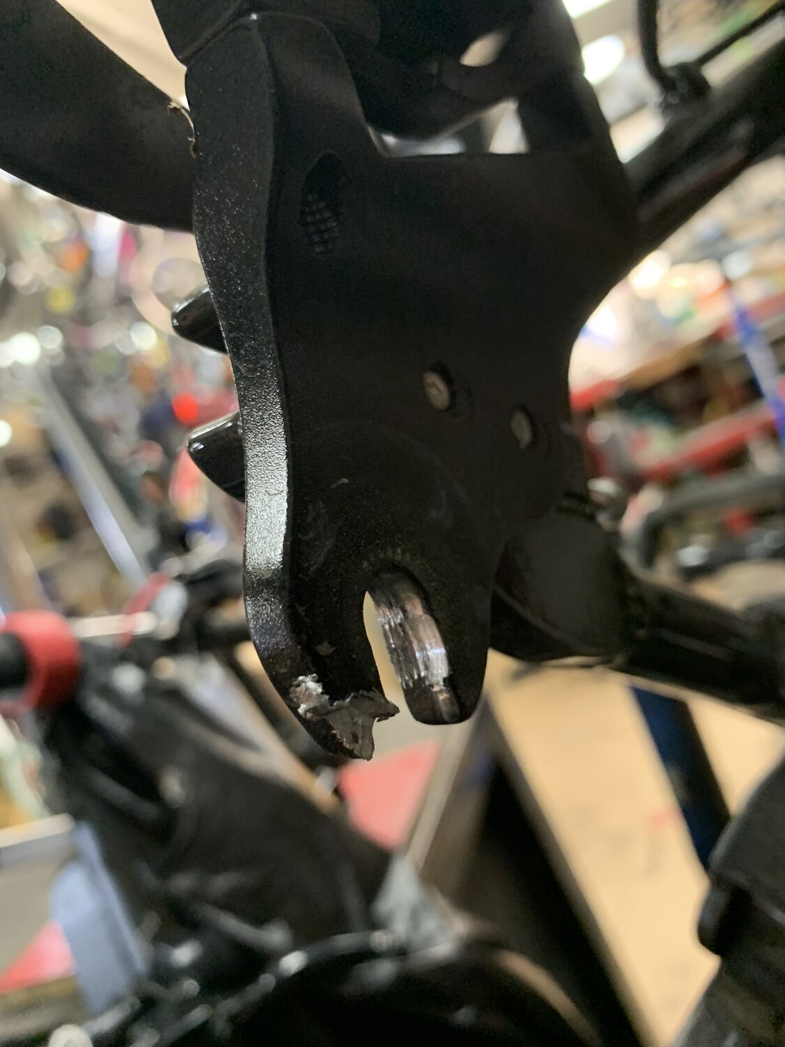

I have had a Priority Current since January. It has been pretty great until yesterday, when the belt popped off the rear cogs and the gear cables snapped.
I took it to my LBS and they found that the the non-belt side dropouts were badly damaged. The attached pictures were taken by the mechanic. That made the rear wheel unsteady and probably caused the belt and cable issues. They said the bike is not rideable.
It only has 1300 miles and hasn’t been in any crashes.
Has anyone else had issues with the dropouts on the Priority Current?
