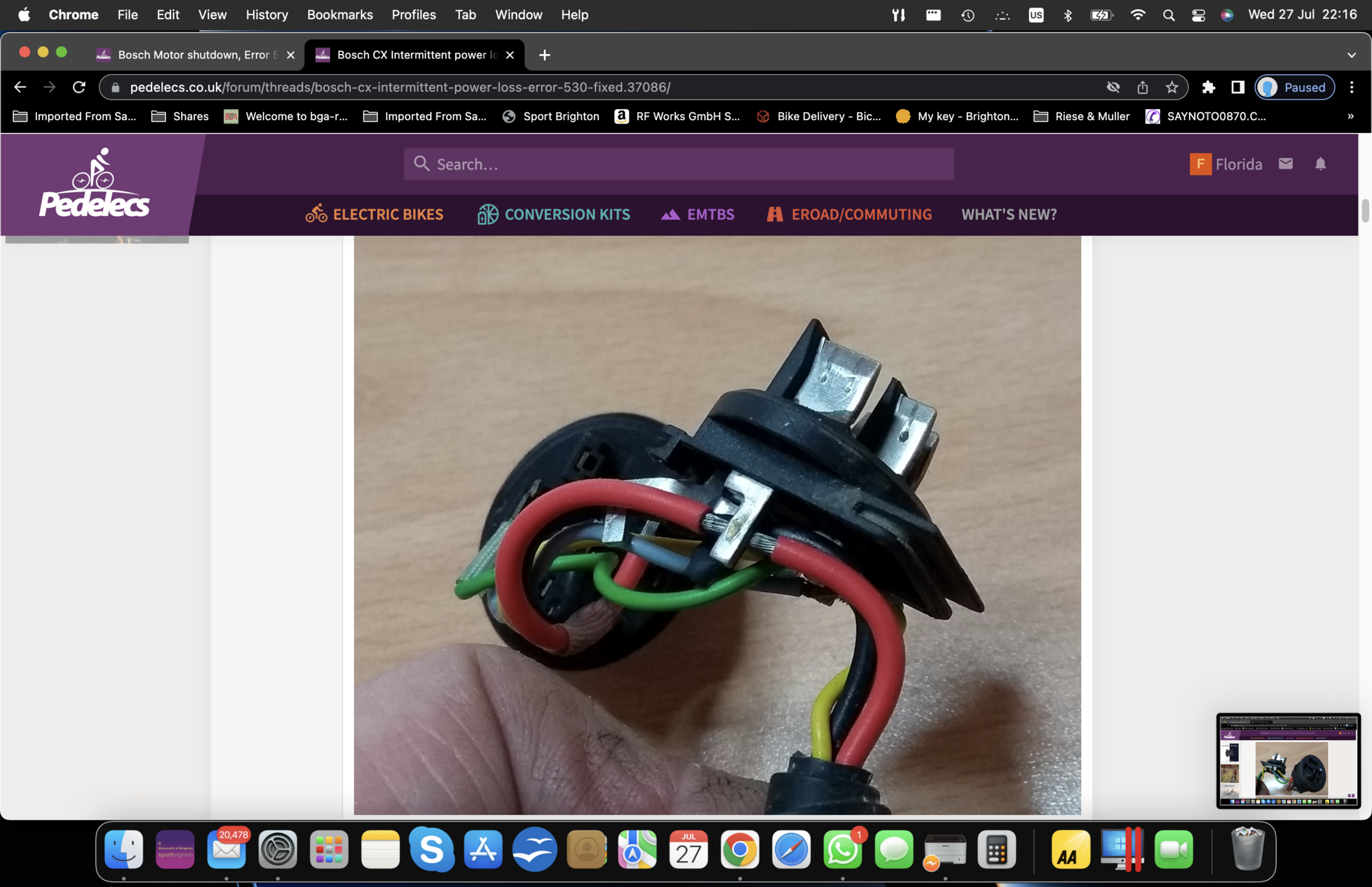

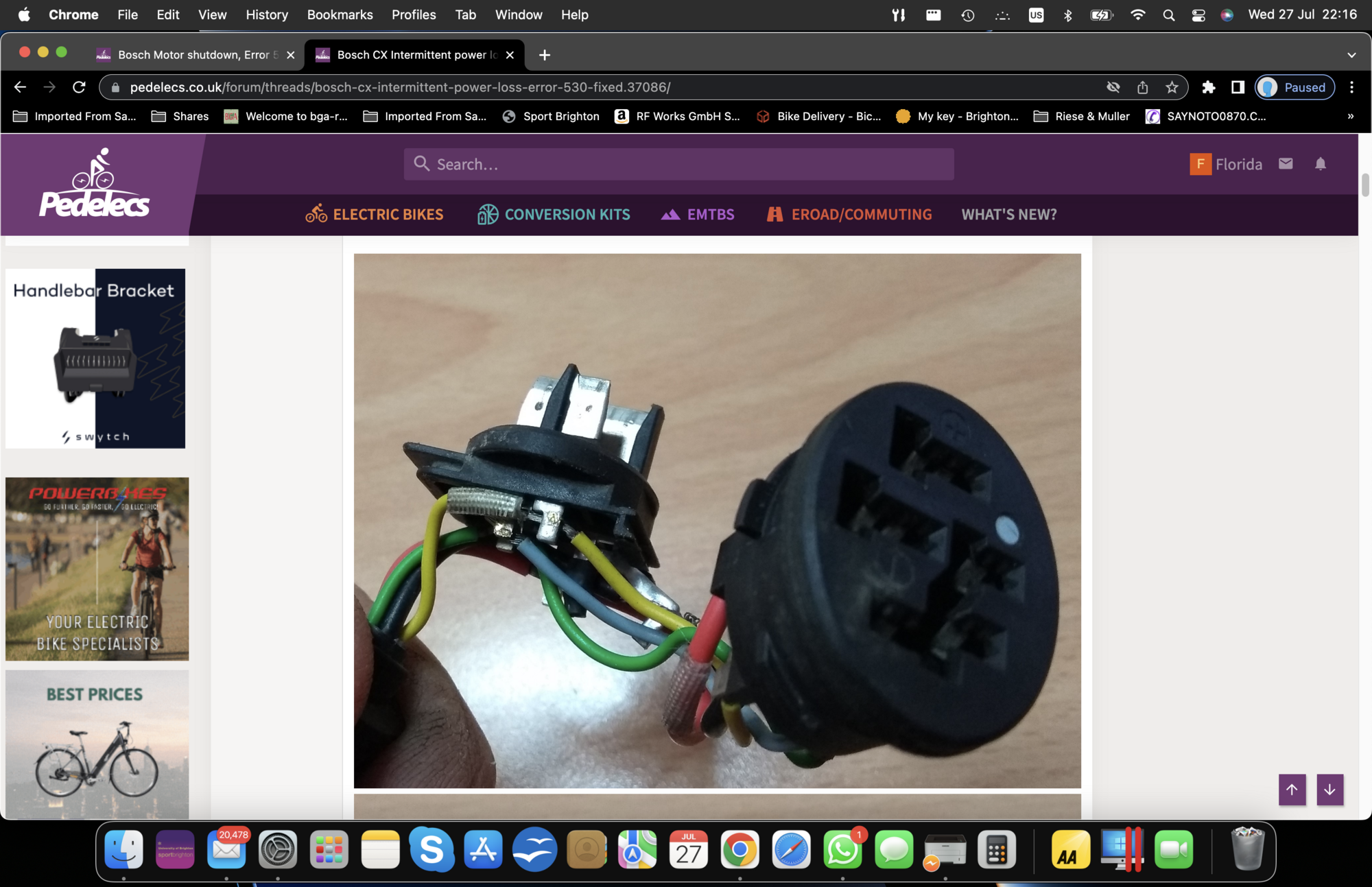

My almost 3-year-old 12000 miles R&M Supercharger 2019 GX model with Bosch Performance Gen 2 motor has recently developed a habit of shutting down at random points in a ride, usually with the display showing a flashing empty power tube, but no error message. It refused to power up again unless I removed the power pack and reinstalled it. A battery reset didn't solve the problem. I cleaned all the terminals and I ensured that both the Bosch 500 wh batteries were properly secured in place and tight as possible but the problem persisted.
I then closely inspected the original socket/terminals and was surprised how badly the terminals had worn and become pitted. To resolve the issue, I have now been looking to find a replacement power cable but to no avail. The UK dealer which I bought the bike from, Fullycharged in London, England, has been unable to help and other R&M dealers are not prepared to assist as "I did not buy my bike from them". Can anyone here help with identifying the cable and where it can be purchased even if it happens to be outside the UK?
