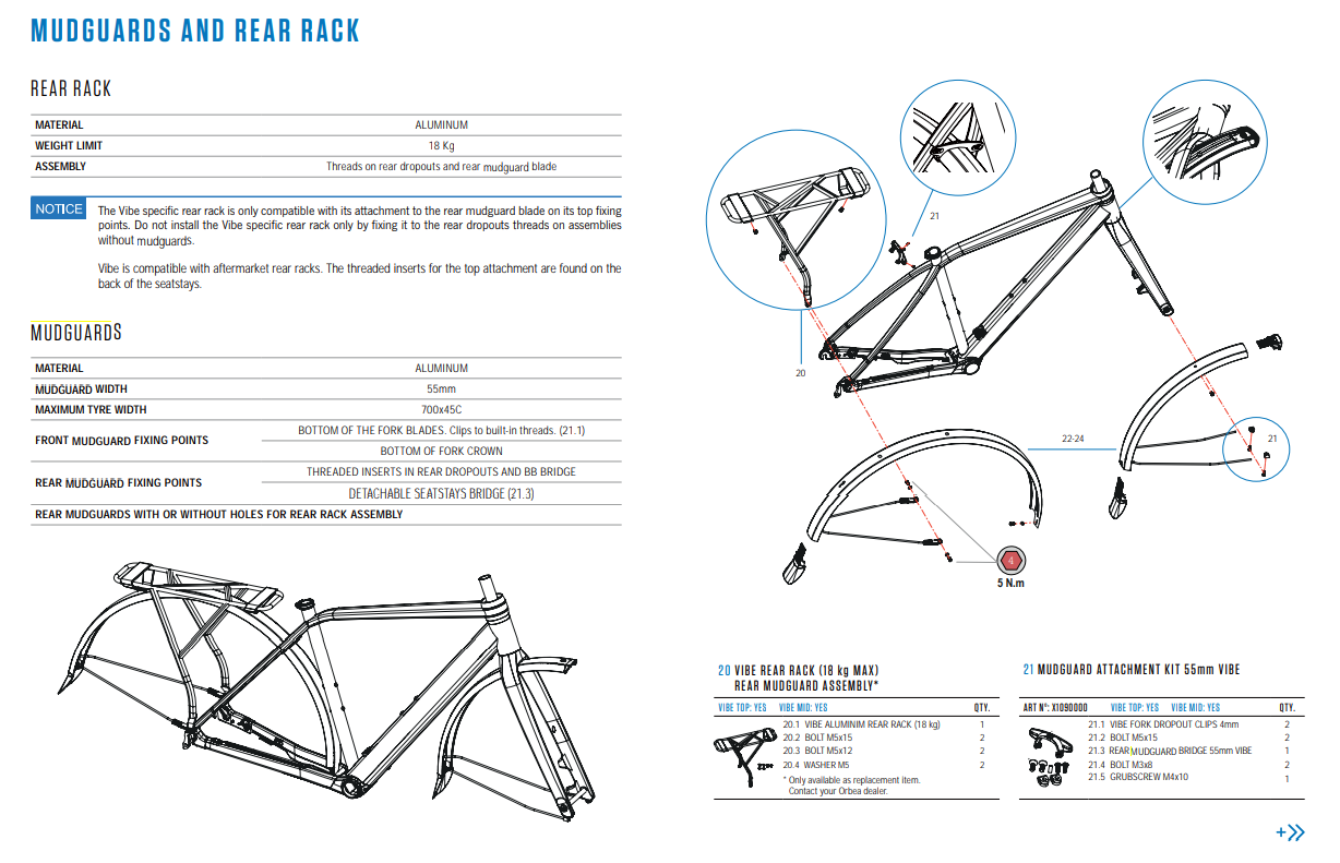

Does anyone have a suggestion for non-Orbea mudguards (fenders) for Vibe?
@Stu14 - can you please share the details of the SKS mudguards you have installed?
Cheers
Hi all,
Cheers
As @ Stu14 has not yet responded, I looked around a bit (because I don’t use fenders).
As far as I could see, the Curana mudguards were originally installed. The first image shows the fender data I found in the Orbea Bluepaper for Vibe (the entire Bluepaper can be found on the Orbea web). But other manufacturers also have interesting solutions. It may be best to inquire at the nearest service center based on the information provided in the attached Bluepaper.

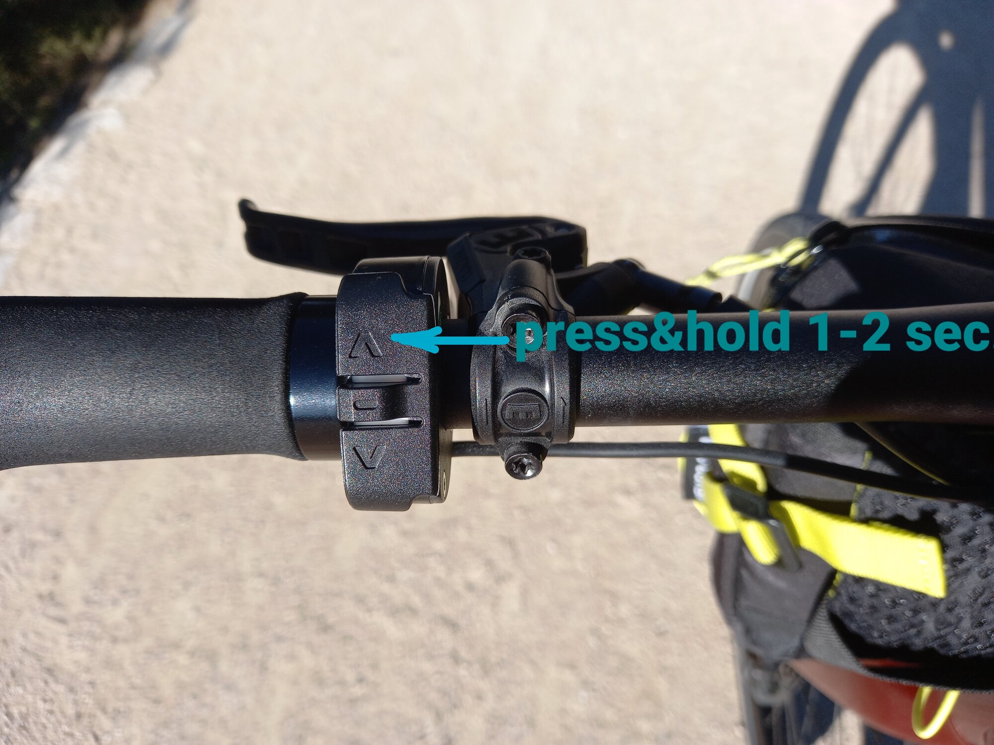

HI there, just received my Orbea Vibe, on Red Weather Alert day in the UK!! It wont stop me doing a quick run around the block though!
First three of many questions I am sure:
1) Is it possible to have the lights flashing? I think this is better for 'being seen'
2) My rear light is on while the bike is charging. Normal? Can it be turned off?
3) I'd like to try the autoassist, wherby the assistance changes based on your heart rate. I can get a hr strap to link to the App, but is it possible to get a watch or Fitbit type device linked? I havent been able, despite the watch running Bluetooth 5

1. Lights flashing is not allowed by law in Europe and the UK. Lights flashing is reserved for emergency services. Lights flashing can also be dangerous as it prevents a good estimate of distance for other road users.
2. To turn the lights on and off (front and rear) see picture below.

1. Yes, it is really illegal (EDITED) in EU.
2. Press and hold a little longer until the lights go out.

Hi
thanks, I do that and the rear light comes on/goes off, but not the front. The bike was shipped to me and I think as I straightened the handlebar the light became disconnected.
