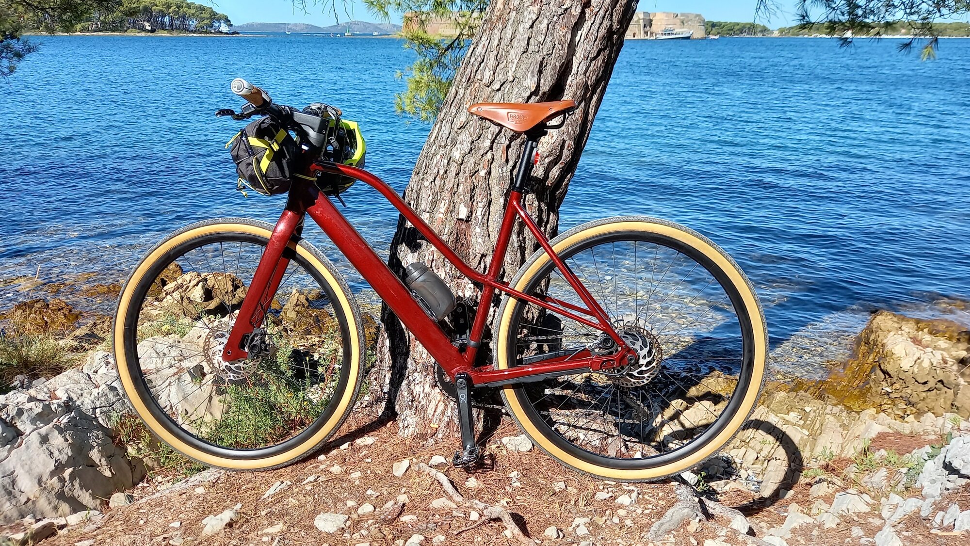

Vibe in an appropriate environment. It suits him really well.
Hello everyone. I hope you are well and happy with your bike.
Is it one of the original color ? when i bought mine i had no choice at all, i could only order the black unequiped H30 and i was even lucky to get it.
It seems that you changed the saddle and the handle/grip i like them, so could you provide us with areference.
Thanks in advance.
Thanks in advance.
yes, it is the original red-metallic color. and yes, I changed the saddle and grips.
The new saddle is BROOKS B17 Standard "Classic" and the grips are ERGON GP1 BioKork.
The saddle is more comfortable, easier to get on and off. The grips are slightly more ergonomic and more comfortable due to the natural material. Overall, visually more impressive.

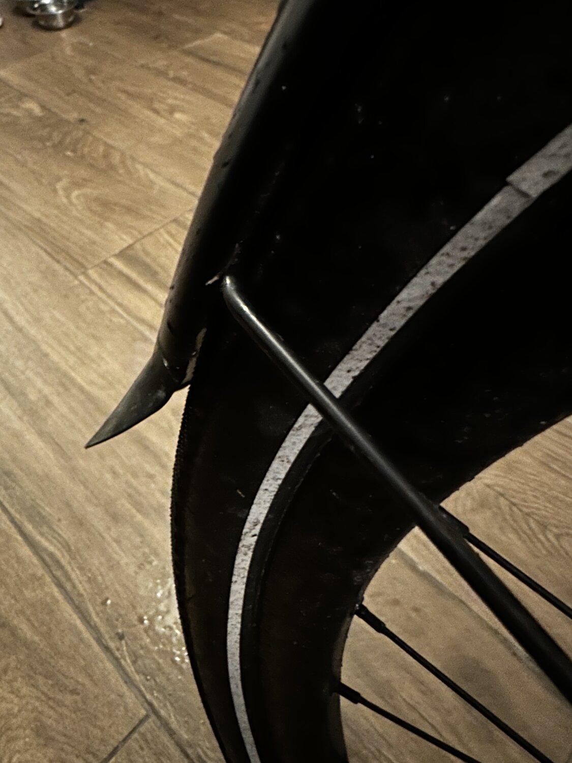

Hi all .... question for EQ version owner out there .....
A nuisance issue which one of might be able to help ...
My back mudguard is off centre and is rubbing off the tire slighty. (I an guessing that the garage door banged off when it was closed).
If I push the mudguard back it sorts the issue ... but after riding again .... it slips back to rubbing again.
Does anybody know the proper way to adjust it to fix the issue?
The photo below (you can see) shows the mudguard too close to the tire
Otherwise I am Loving the bike I must say!
Thanks in advance!
Keith.

Do you have a picture that shows the arm attachment to the frame to see if there is adjustment available there?
If not, you may need to remove the fender and check if one arm needs to be bent back to be symmetric with the other
Thanks for the reply ...
There are 3 places where it's attached the frame ... this is the one that probably needs adjustment ....
I have tried but it's finicky .. and there is nothing in the manual on how exactly to adjust
(No luck on google/youtube either)
The arms don't look bent in any way ... trying not to bend either in case I make it worse

If they do allow adjustment, you would unscrew on one side and screw on the other.
But I am not sure what is there is adjustable.
If you look at the arm on both sides from the back, you should be able to see if the arms are bent in a specific way.
If so you may be able to only unscrew the side mounts to let the side arms loose, then based on their position, bend them back until they are symmetrical, then re attach.
Took a look - they are adjustable alright.
Took a closer look .... It's not just off centre at the back ... it starts going off-centre under the carrier (which on the EQ is attached to the mudguard).
It's only a few weeks old - will bring to to the local Orbea dealer tomorrow.
This would mean the bolt under the carrier is on a wider slit that allows some lateral adjustment. If so, loosening the bolt would allow to slide it back to its middle position.
Carrier looks welded to the mudguard.
It’s looks even where it is connected to the frame but goes off-centre after that
All sorted now.
Scrambler you were right ... the attachment nearer the saddle post was adjustable.
Issue was caused by using a single pannier bag on 1 side. Advice was to alternate which side I put the pannier bag on.
