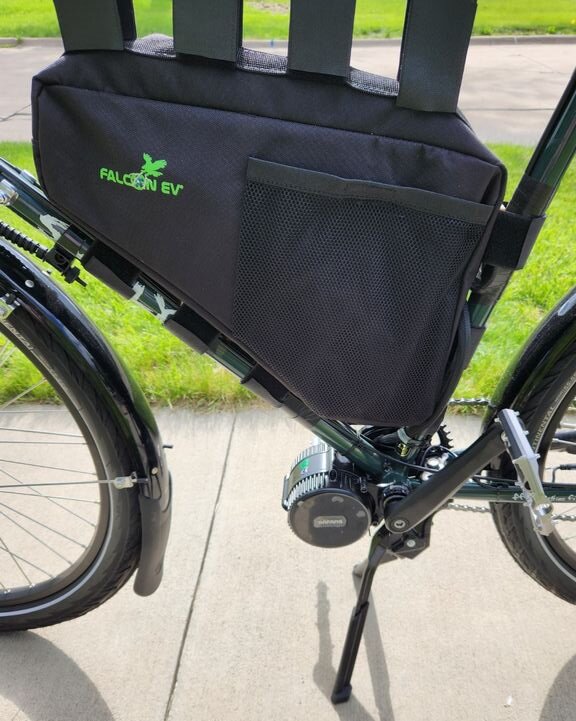

I tried putting a BBS02 on that exact bike. Even with a 42t Lekkie with the most inward offset, the chainline was on the smallest cog due to the use of spacers. Couldn't overcome the chainstay clearance angle. Re-assembled and returned 5 days later. For a suitable bike, I would always begin with the chainstay clearance angle near the bottom bracket, then frame integrity, frame triangle, then the ability to install 2.2" - 3" tires. I like having a frame triangle battery bag.
