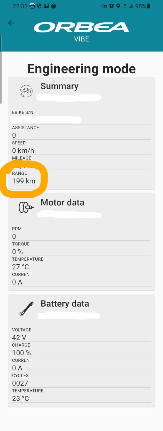

I did get out for 2 or 3km yesterday, I mean, I had a new toy to play with, and I deliberatly cycled up a steep hill (10%, 30m ascent) into 30-50mph winds on full assist cos I wanted to see how easy to was. I know thats not a 'fair' test of the battery, each climb cost me 8-9% of battery!!! So if it is mapping range on usage (which is a great way to do it) then 19 miles makes sense. I'll do my test tomorrow and see what I get
According to my last battery charge, as of last night, the expected range is almost 200 km or 125 miles. I deleted the serial numbers of the engines and batteries, so that no one would come up with the idea to hack me.

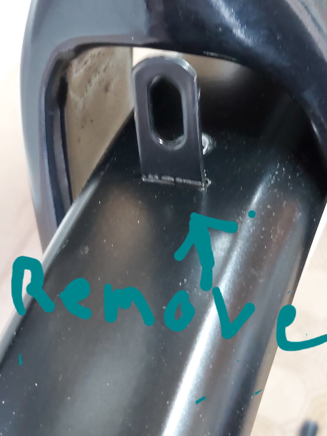

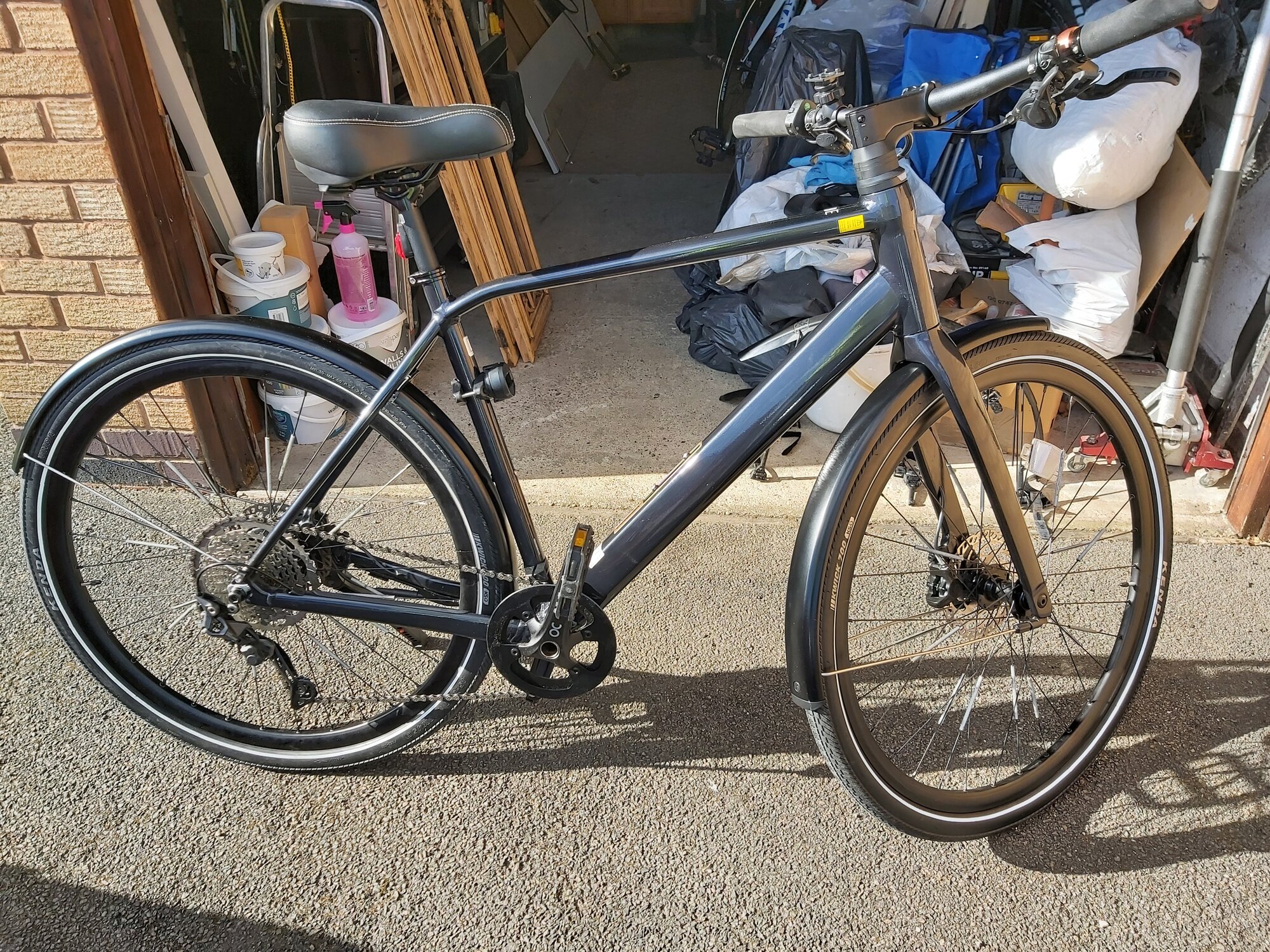

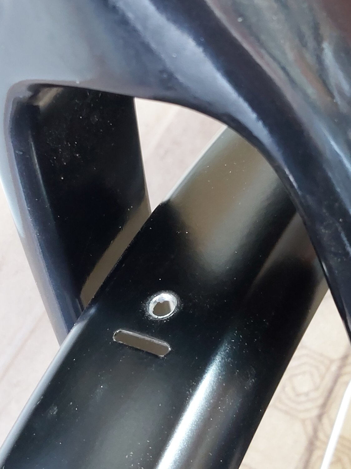

Hi all, new member here. I have a Black Orbea Vibe and I want to share which Mudguards I chose and how I fit them.
I chose the stylish looking Curana Apollo 28" 55mm Fender set
  • Item number: 720751
available from Hollandbikeshop.com
I recommend you also get the additional bag of bolts and nuts and washers from them. Item number (720756 )
You will also need a
Mudguard Bridge vibe 21 Ref. X109 available direct from Orbea.
To fit the front Fender you will need to remove the unneeded attached braket by drilling out the rivet. Use the hole to fix the Fender to the underside of the wheel arch using an appropriate length bolt from the kit. Follow the fender instructions for fitting the stability rods.
Regarding fitting the rear Fender. Remove the rear wheel. Slide the Bridge onto the mudguard do not attach it to the frame yet. The Fender has a supplied plastic fixing plate for the bottom end of the Fender, again this is not needed on this Bike. Use the existing hole in the Fender to bolt it to the bottom fixing point. I used a large and a smaller washer to make up the space between the Fender and the bolt head. Follow the instructions to attach the stability rods. You can now afix the Bridge.
Hardest part for me was putting the back wheel on.
I hope this helps someone out.
Regards,
Mark...

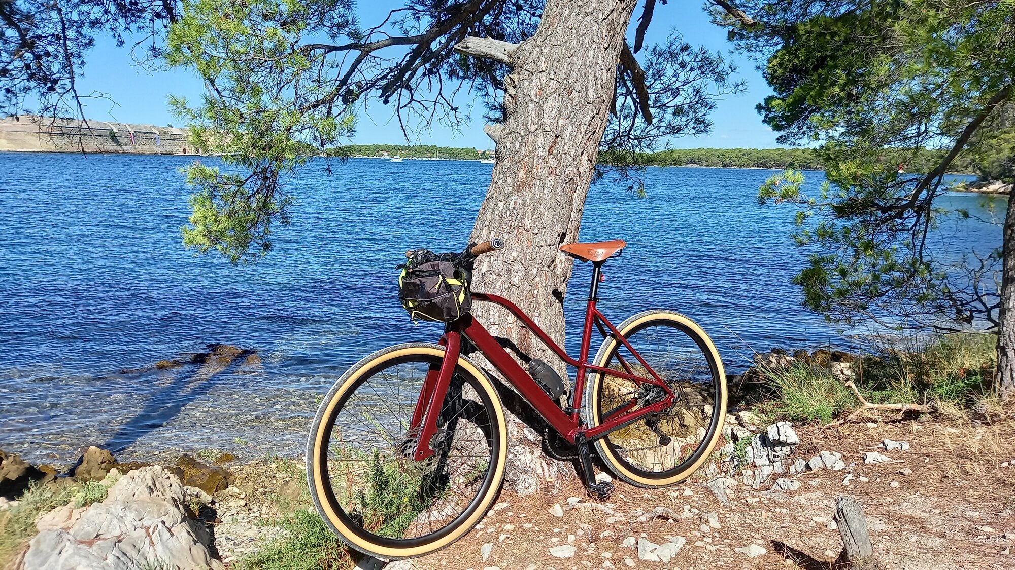

Tire effect

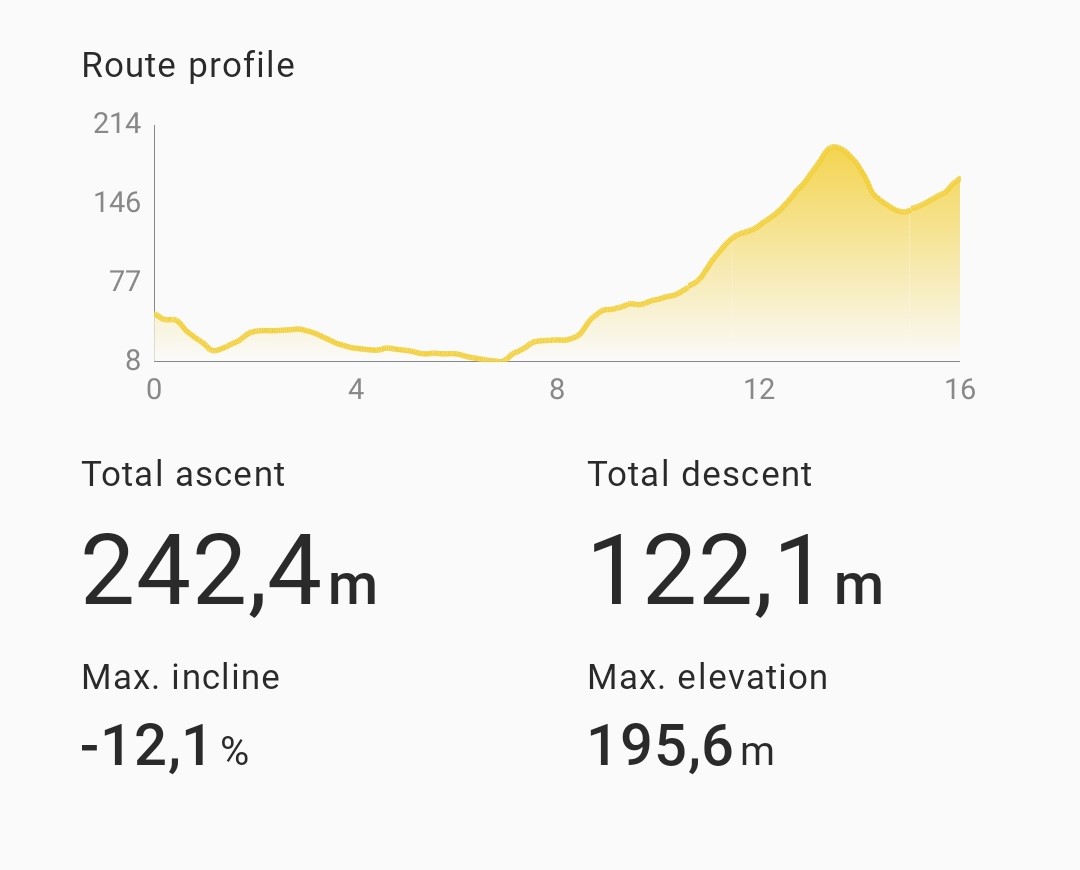

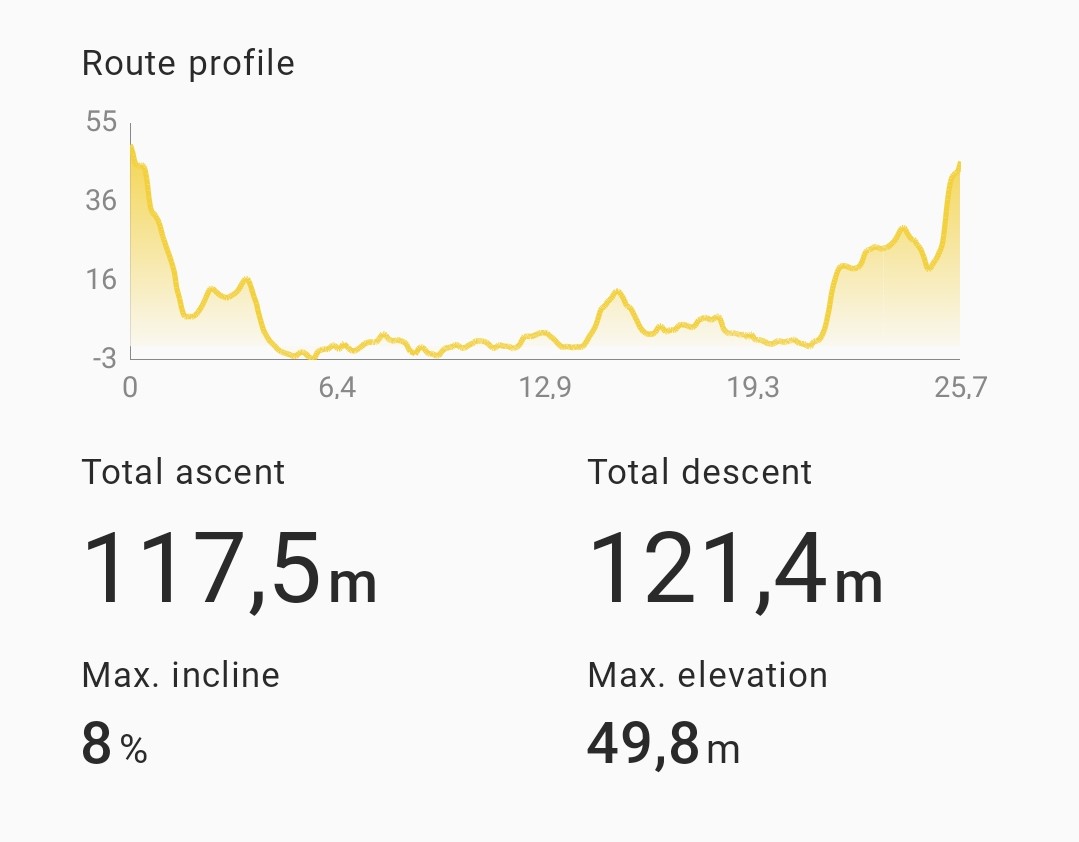

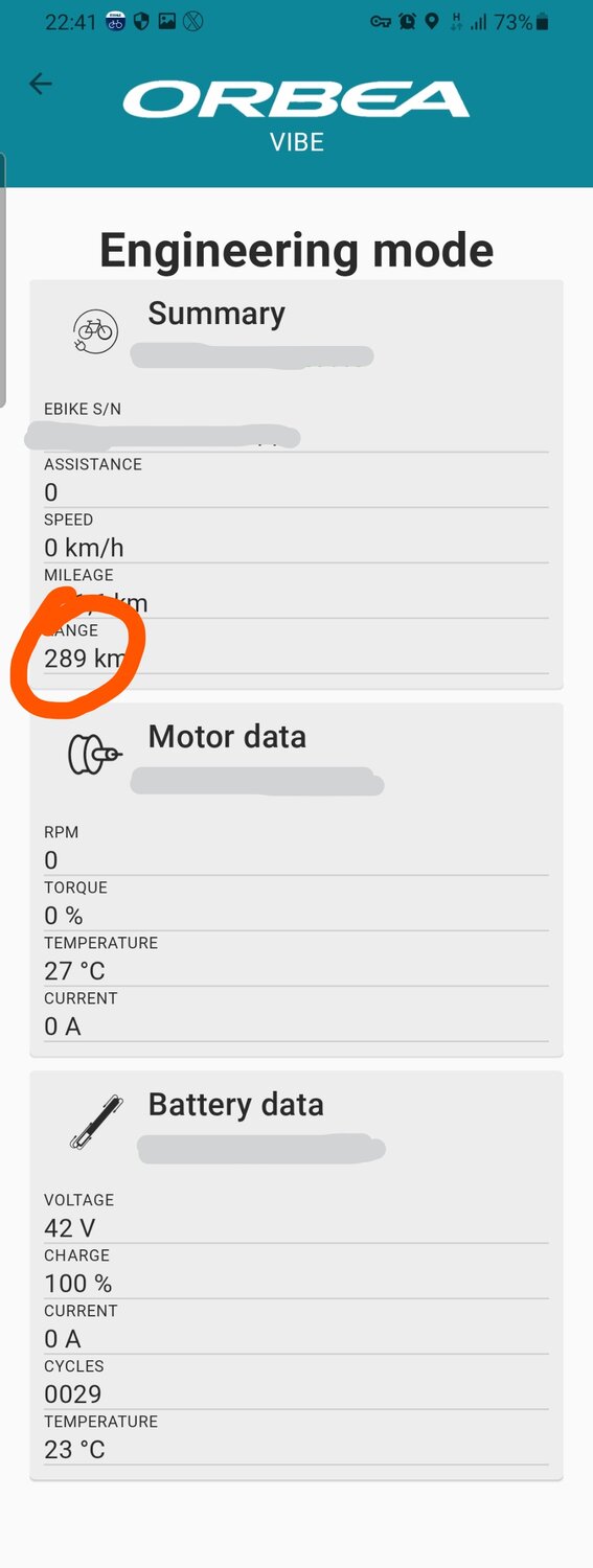

I changed the tires a month ago. Instead of the factory-set Kenda Kwick700 (700x45C) I installed the Panaracer Pasela (wire bead 700x38C). The Pasela wire bead weighs 470 grams (folding bead 420 grams) and is much easier to accelerate and overcome uphills than the Kenda Kwick700. According to the BRR, for their rolling at a speed of 29 kmh / 18 mph and a load of 42.5 kg / 94 lbs per tire, it is necessary for the cyclist to engage about 38 watts of power, total for both tires.
A big advantage of Pasela is her suppleness, which makes her very comfortable to drive. Where Kenda bounced off the bumps in the road and slowed down, Pasela passed as if there were no bumps.
According to data from the Mahle app, and after last night’s battery charge, I’m now able to cover almost 290km, as pictured below. Previously, with Kenda tires I could not cover even 200 km with one battery charge, on the same tours. I note that these are tours where it is necessary to master the climbs up to 12%, and the height difference of 200 meters, as in the pictures below.
So, if you ride a bike in a hilly area, I recommend changing the tires. If you drive mostly on plains you can stay on Kenda tires until they wear out.

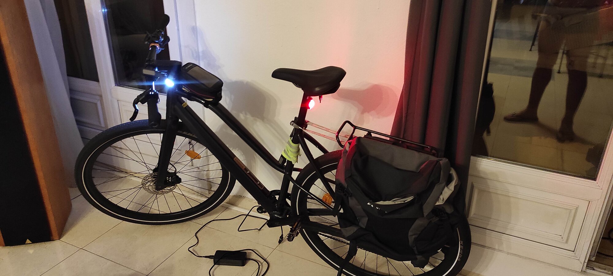

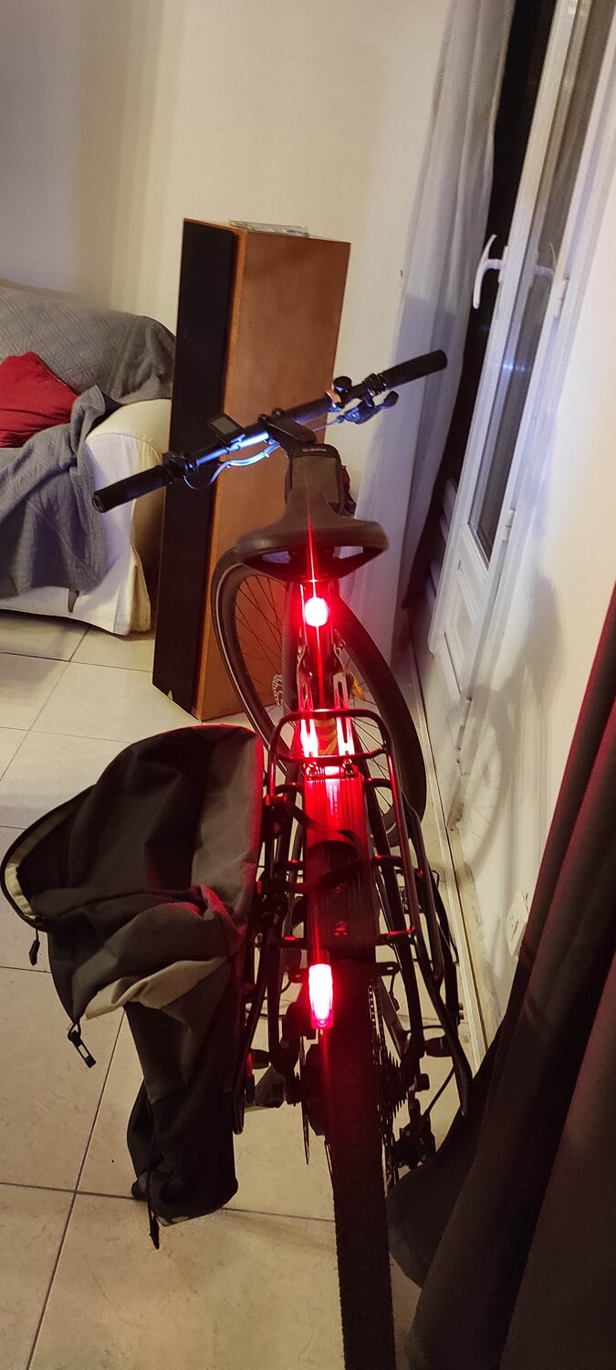

My Vibe with its rear carrier.
I got a topeak standard model for bike with disk and 29 or 28 wheels. I had to by an extra piece to attach the carrier on the seat locker.
I have two vaude on-tour bikepacks, only one is attached. It takes 5-20 seconds to install or remove them and they have plenty or zipped secure pockets.
I added a chinese back light that use a gyroscope and works as a fire-break (it gets very bright when i slow down). On the handle bar i have a super cheap wireless decathlon speedometer that use a sensor around the wheel hub, it uses a garmin like attachment which is nice. I have another garmin-like support for my olight Rn 800 (it paid like 59 euro for it but the price has increased a lot, indeed chineses were managing to escape the VAT for a long time but the EU custom got serious about it last year).
The bikestand is from Orbea (19 euros)

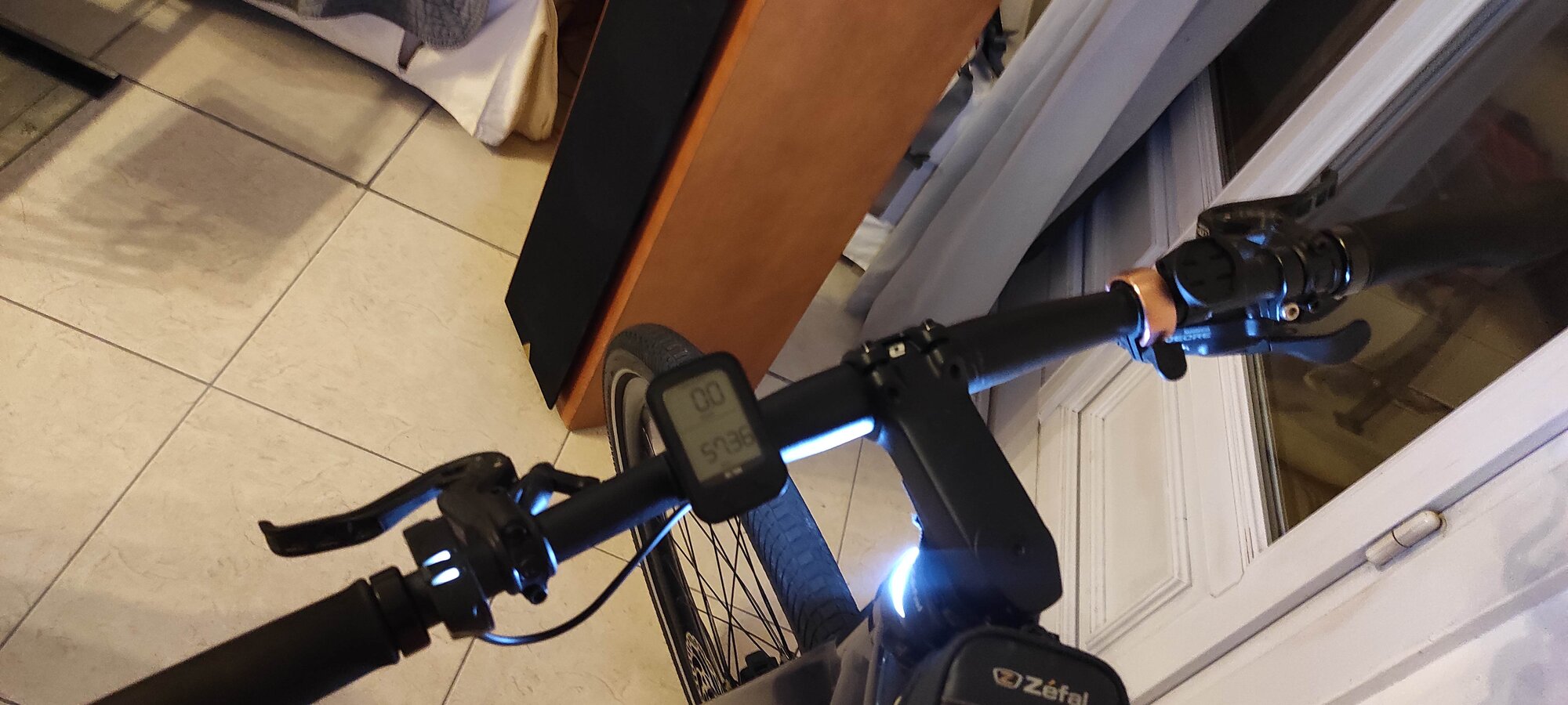

To all Orbea Vibe owners with external light option
Good evening, I have an Orbea Vibe H30 EQ with external light option,
when I press the top button of the Iwoc Trio control, the rear and the external front light turn off, but the integrated headset light never turns off, it is alwais on.
Is this normal behavior? is there anyone who can confirm or deny this?
Please my dealer says it is normal behavior, but don't think so, I think that the cables of the external light and the integrated light are reversed
Look at the Vibe manual pag 69
Thank you
Thank you
It seems weird, o my Vibe I just have to be seen light (rear and front)., i switch them off pushing the iwoc central shortly then the up button. The external strong light that comes on EQ version should in my opinion turn on and off when the integrated light do. It is weird since the power cable should just be parallel to the one powering the integrated front light.

@PlanBee, You missed the main question (problem), and it was - when @Andrea-Vibe press the top button of the Iwoc Trio control, the rear and the external front light turn off, but the integrated headset light never turns off, it is alwais on.
If we are talking about the light integrated into the head tube, in the rubber grommet there is a small on off switch. Hold it down it should work.
I didtn realise it was there, not evident inany manuals, and managed to 'destroy' the switch......long story
