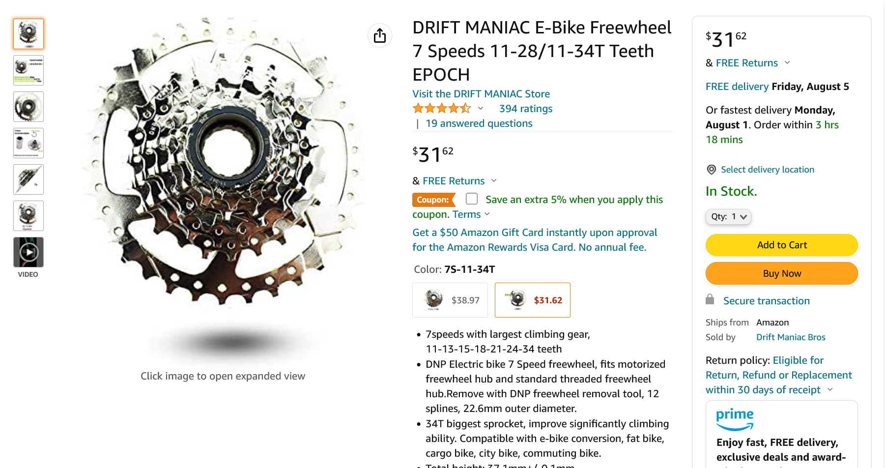

There are some inexpensive 11-34 seven-speed high quality freewheel clusters on Amazon and eBay. They are about $20. I need to order one today. I am tired of the 13-34 Tourney on one bike. It spins out at 21. The 11-t will be 18% faster. So, it will hit 25 without changing the ring. The swap will take 10 minutes.

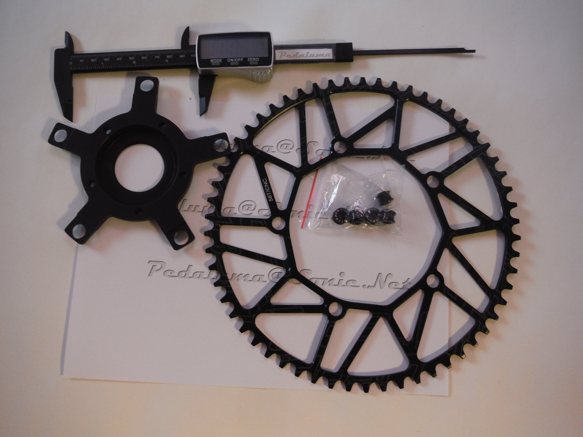

What happened with the huge-ass chain ring? Firstly, it took two chains. When I installed it I could only use the three highest gears because the cassette worked like a front derailleur. It would just throw the chain right off the ring. I am still dumb and screwing up everyday. I am just trying not to repeat the same mistakes and keep moving on to bigger ones. I did get it up to speed and that was fun for like six-seconds. Bikes are not meant to go that fast. Sheldon Brown's gear calculator says 39.5 at a cadence of 90. If you haven't seen that site, look it up. It is a great resource.
When I was dumb I used a 58-t ring on a bike. I wanted to go 50.

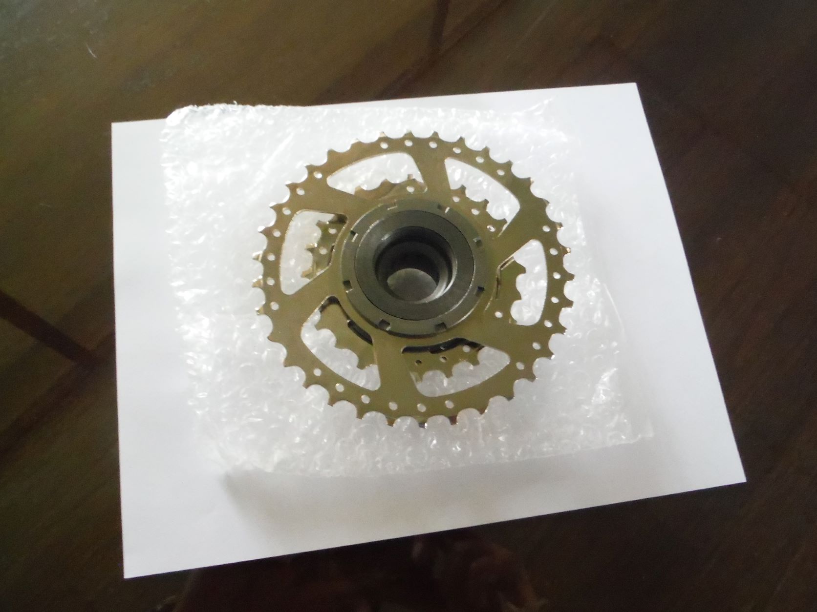

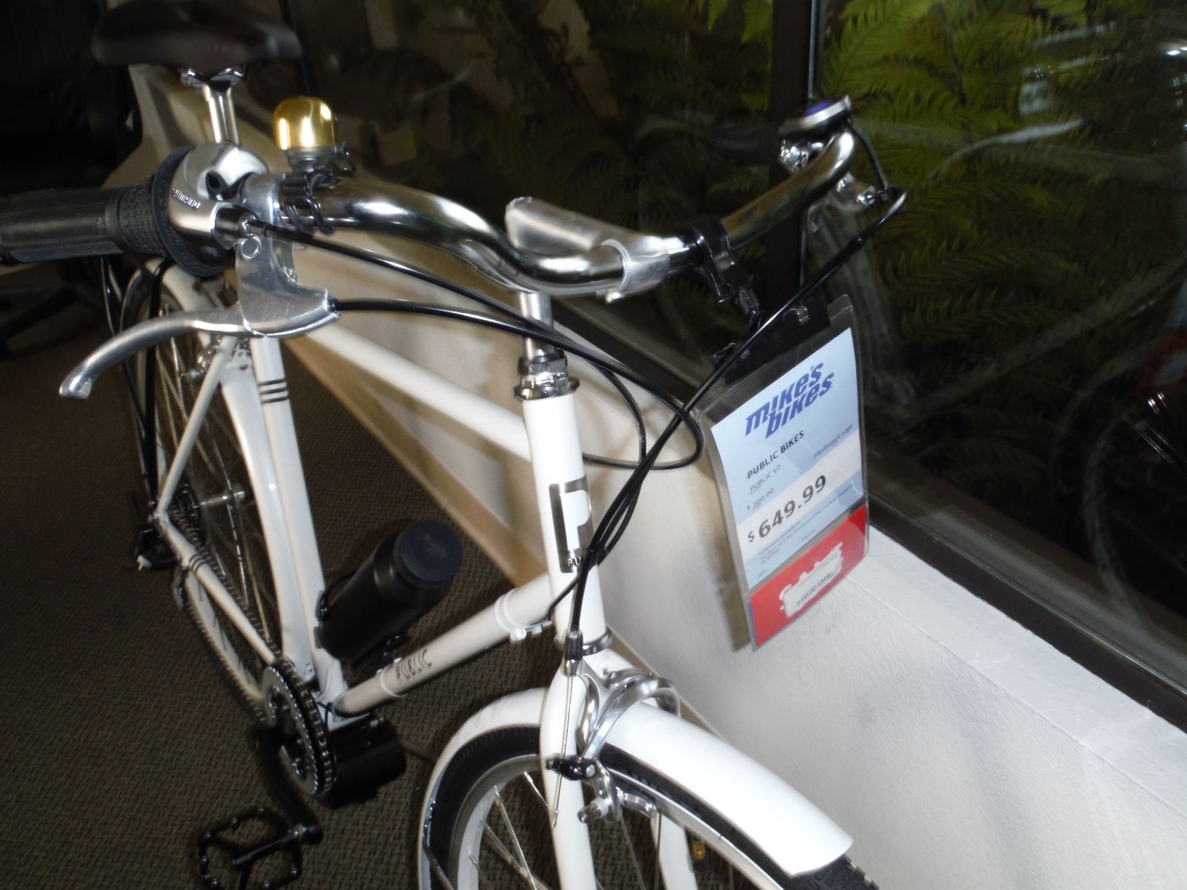

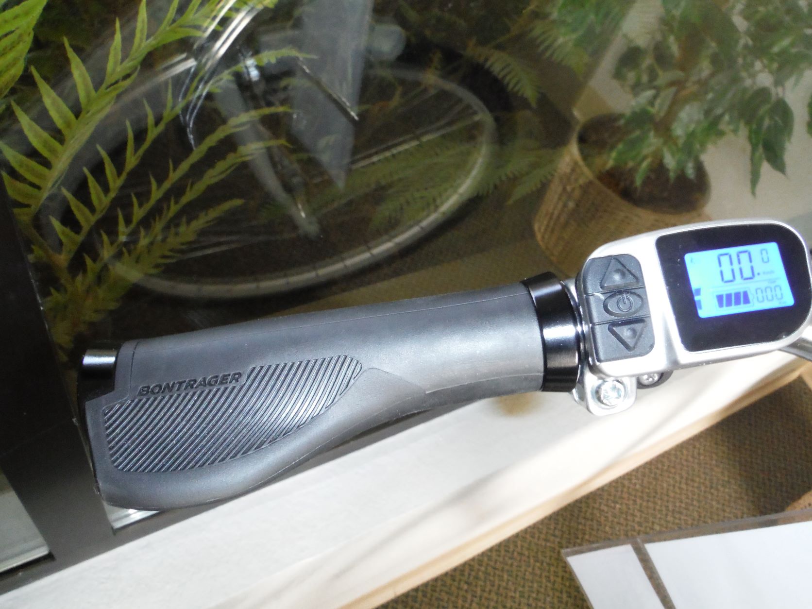

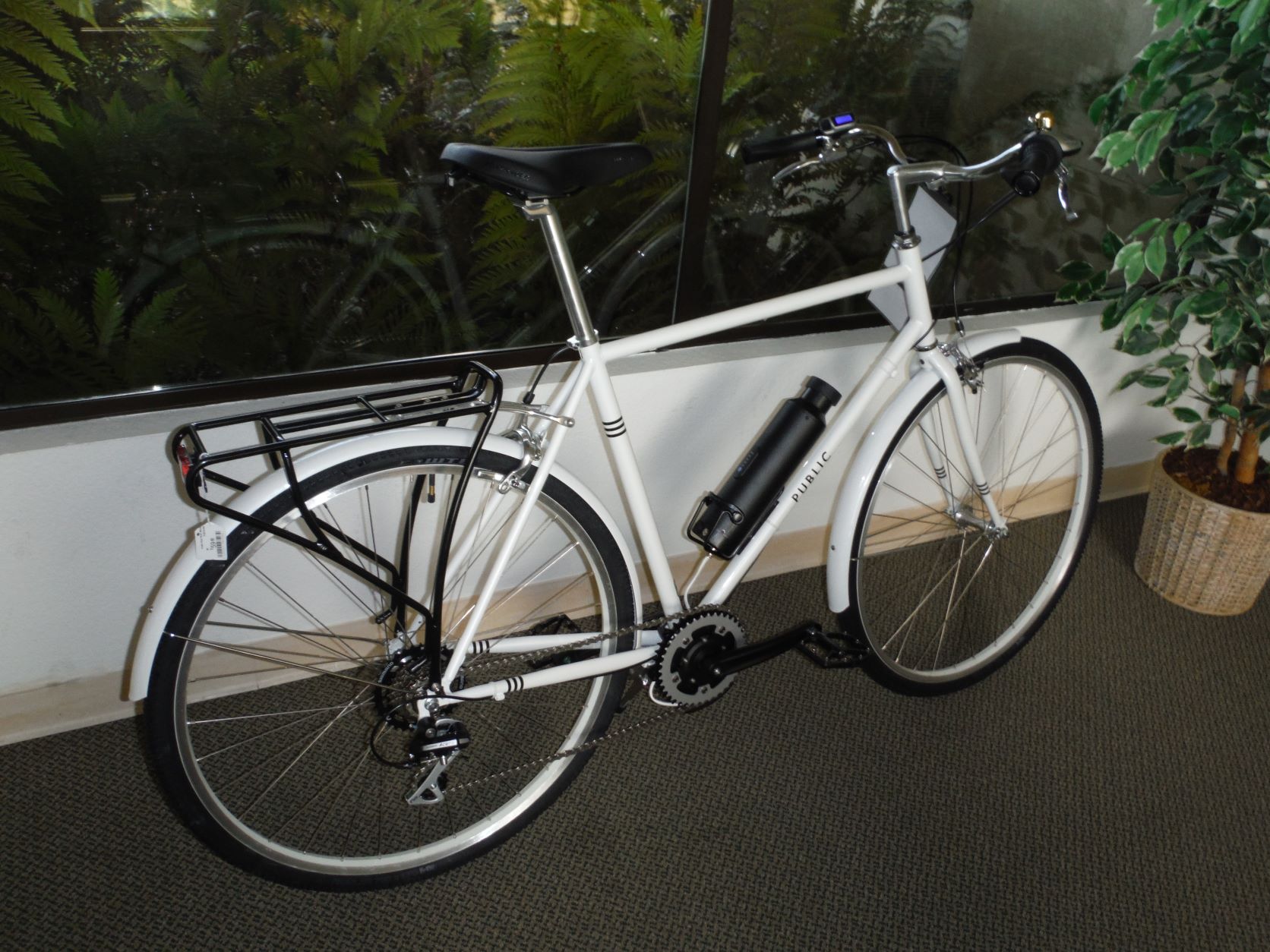

The freewheel 11-34 arrived today. I rode that bike earlier today and it was spinning out on the freewheel 7th. 11-T will be nice. It is this Public V7 with a motor and some upgrades. A city bike with a motor and gravel tires.
