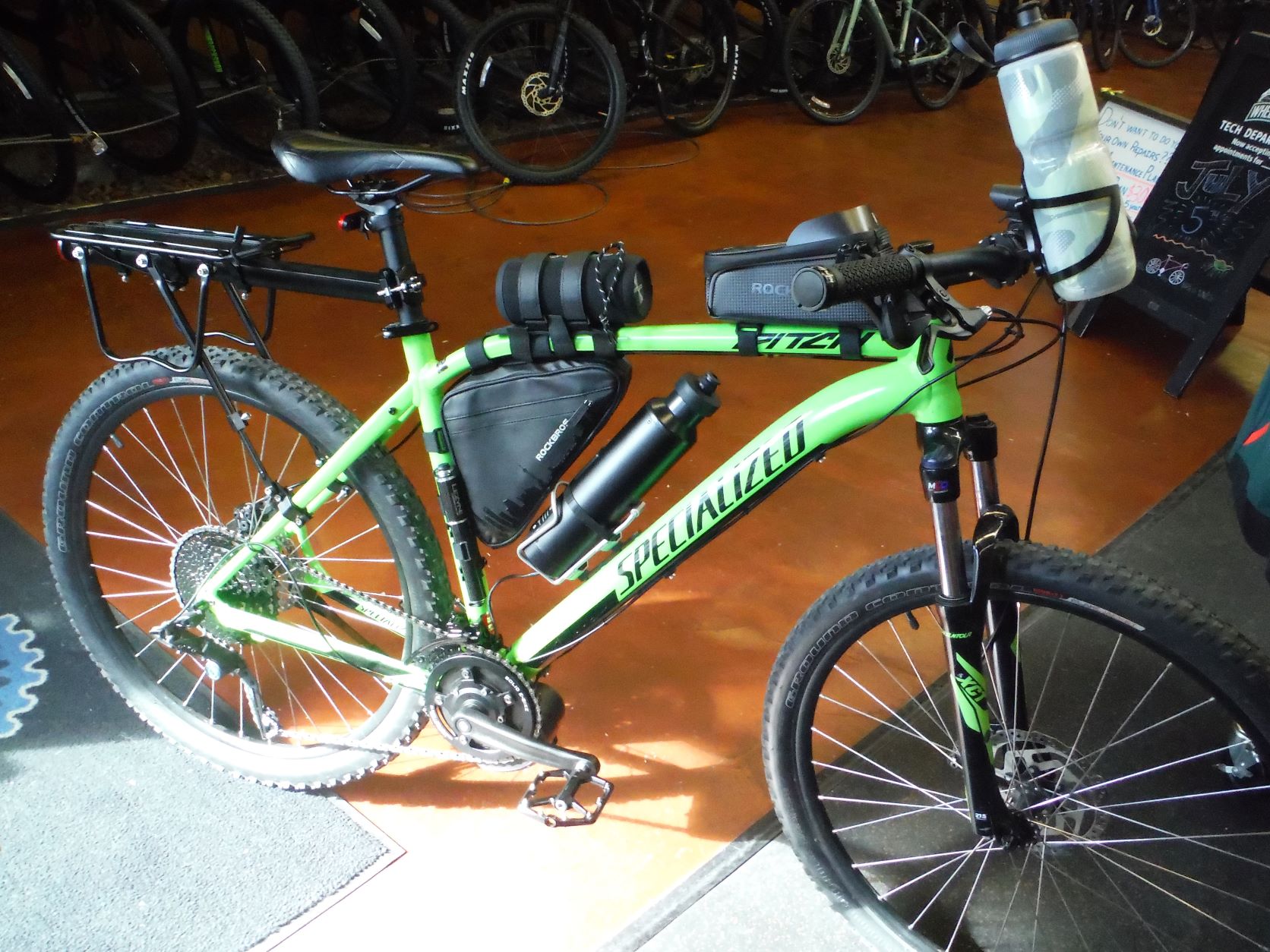

A guy just called. I sold him an analog new MTB four-years-ago. He has attracted nothing but a litany of bad luck, accidents and legal problems since I last saw him then. He went on and on about his woes. Now he wants me to make that MTB electric. And wants to send referrals my way. I would pay to do without people he has met in hospitals, court houses, and jails. For people that have had their licenses revoked eclectic bikes could make sense but it seems like inviting trouble.
