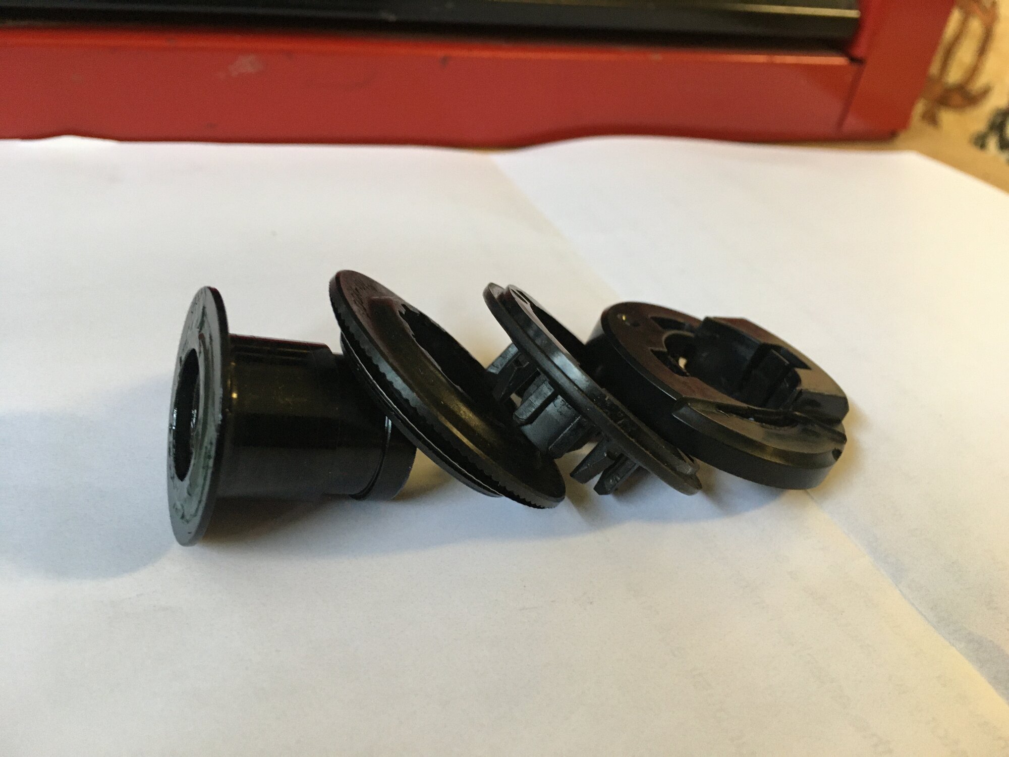

I am looking to build a new wheel set for my new Civante. I will need a CLD 12 x 142 hub that is "grooved" on the left side, otherwise the speed sensor will not lock into place etc. (I have already tried to install the sensor an another wheel without the groove and it does not work)

From the parts manual on page 7, these are the little plastic parts that fit to the "grooved" hub:
X1M-8352Y Magnet Comp.
X1M-8557-00 Holder
I still need a new hub that will work with these parts
When you say grooved do you mean the flange at the end of the hub assembly on the off-drive (left) side? You're probably best off just getting that hub which is part # X1M–F5310–10 on the same page.
Yes, I will probably have to buy the OEM hub like your say. It seems to be a proprietary system. Bummer!
FYI - here are the parts in questionand how they fit together L to R - flange, locking, magnet and holder (rotor not pictured)

Still no word on the sensor parts or the hub itself from dealer/Yamaha. No, I do not believe the GRX hub is our OEM hub because the end cap does not have a groove. The sensor may slide on, but it will be not be locked in place. But who knows it may work that way? The DT Swiss hub looks to have a "ramped groove" that may or may not work. Maybe you could buy one and see if it works?

I went to my LBS, he looked up the DT Swiss HE 1800 wheels and he said since Yamaha uses standard Hub components (12x100 front and 12x142 rear) he can just pop out DT Swiss’ flange and put in Yamaha’s so the lock fits in there for the magnet. Did he miss something? Were you not able to do that?

I went to my LBS. He looked up the DT Swiss HE 1800 wheels. He said since Yamaha uses standard Hub components (12x100 front and 12x142 rear) he can just pop out DT Swiss’ flange and put in Yamaha’s so the lock fits in there for the magnet. But I didn’t get them because I don’t want to risk voiding the 3-year warranty. I will try them once my warranty expires in 2024. The HE 1800 Spline wheels weigh 1980g for the set. I don’t know what the Yamaha wheels weigh for the set. I mainly want these wheels in hopes that they get less strained than the Yamaha wheels (because of better technology/materials used) so I can get every bit of power from the bike to help with fast speeds and steep climbs.
