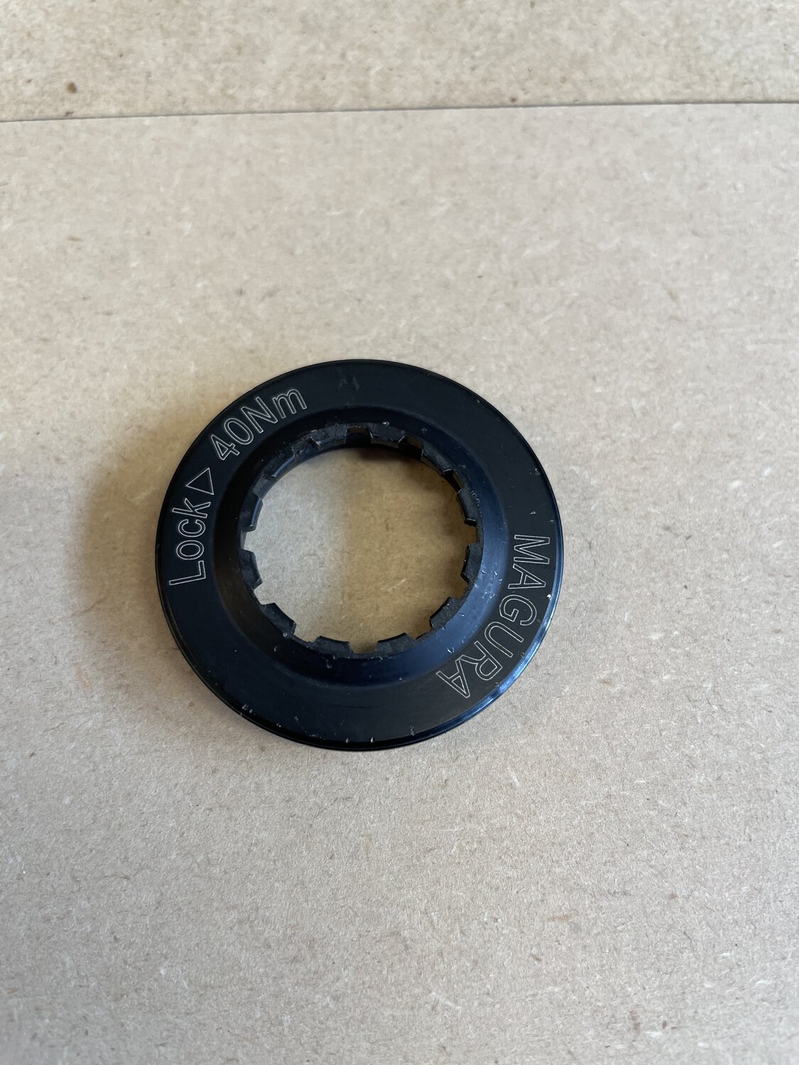

BHey guys here is the mod that is required for a Yamaha axle speed sensor magnet with a center lock rotor to work with a six bolt rotor hub set up.
I have tested this mod for a few months now without a single problem. Without getting wordy hopefully the pictures will speak for themselves.

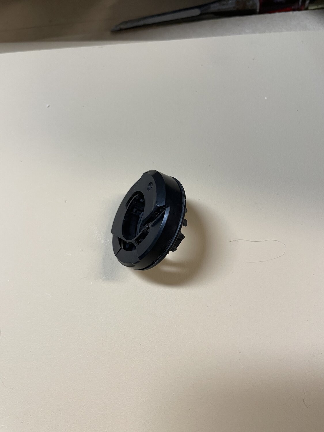

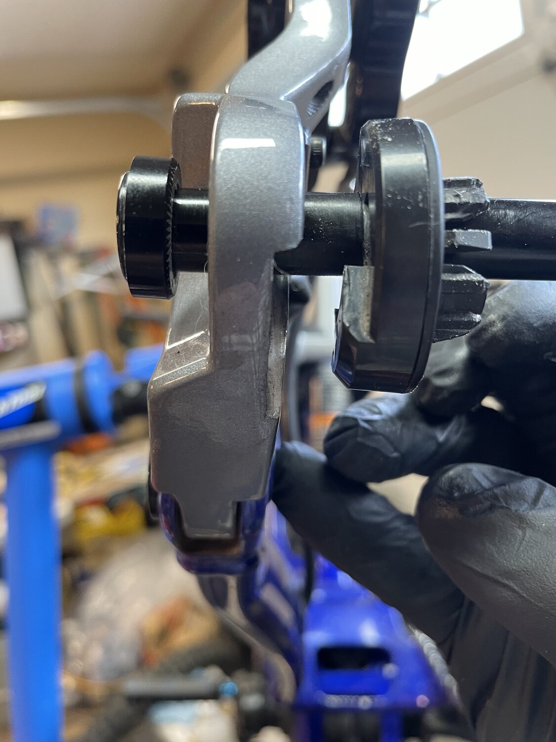

The magnet housing is composed of a two piece system that captures the magnet within. One side of the housing is held solidly by a notch in the frame and the other side slides into the centre lock hub nut via the plastic male splines. So the hub side spins while the frame side just sits there.

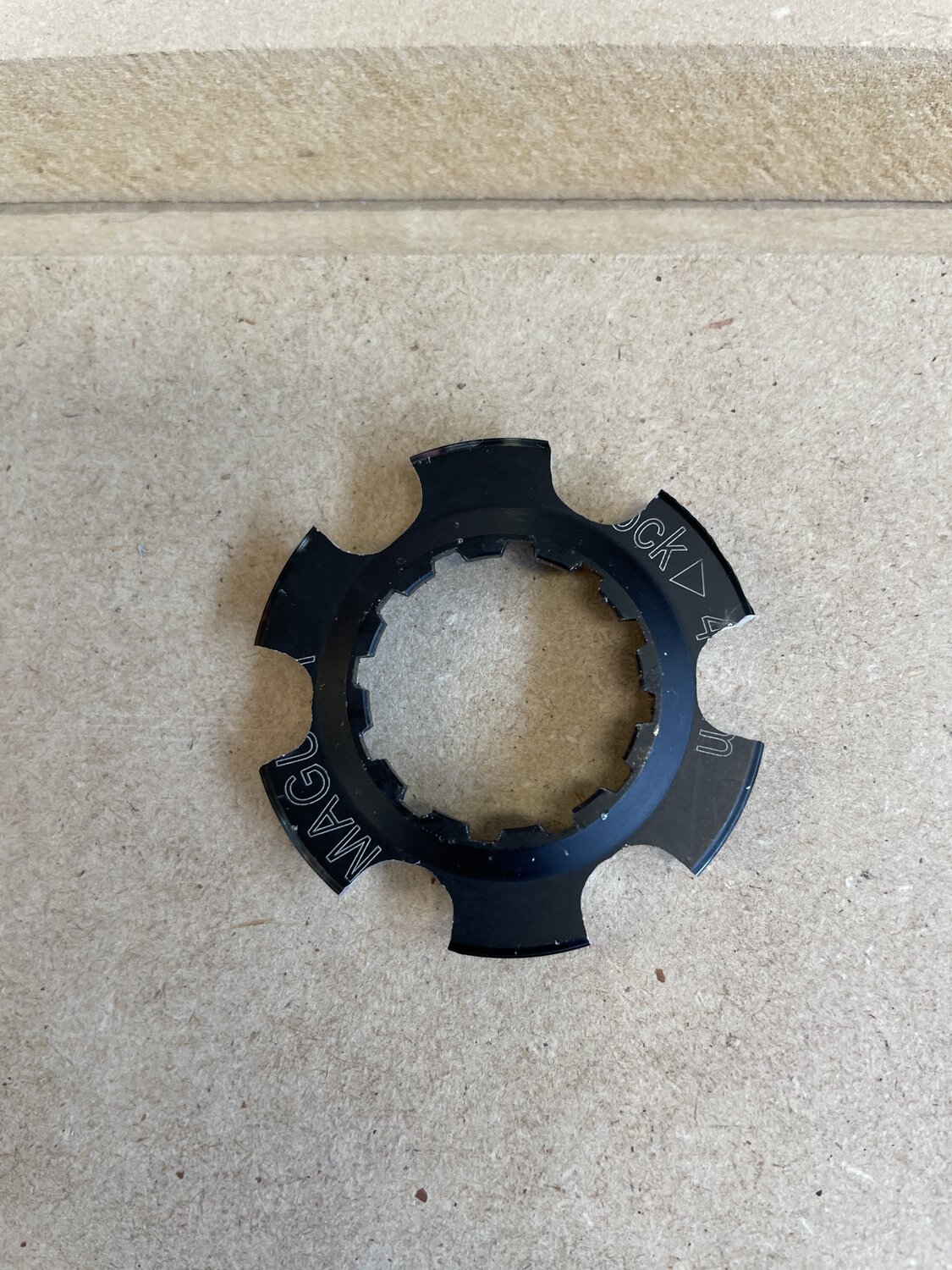

In a nut shell you are simply modifying the rotor hub nut to slip into your new six bolt hub rotor .

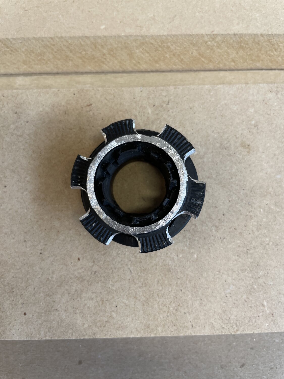

View attachment 113069The above stock nut is modified using a die grinder to allow the nut to sit flush against the rotor surface.
Depending on your disc/rotor you may have to grind some of the threads off so the overall diameter of the nut is small enough to slip inside the disc.

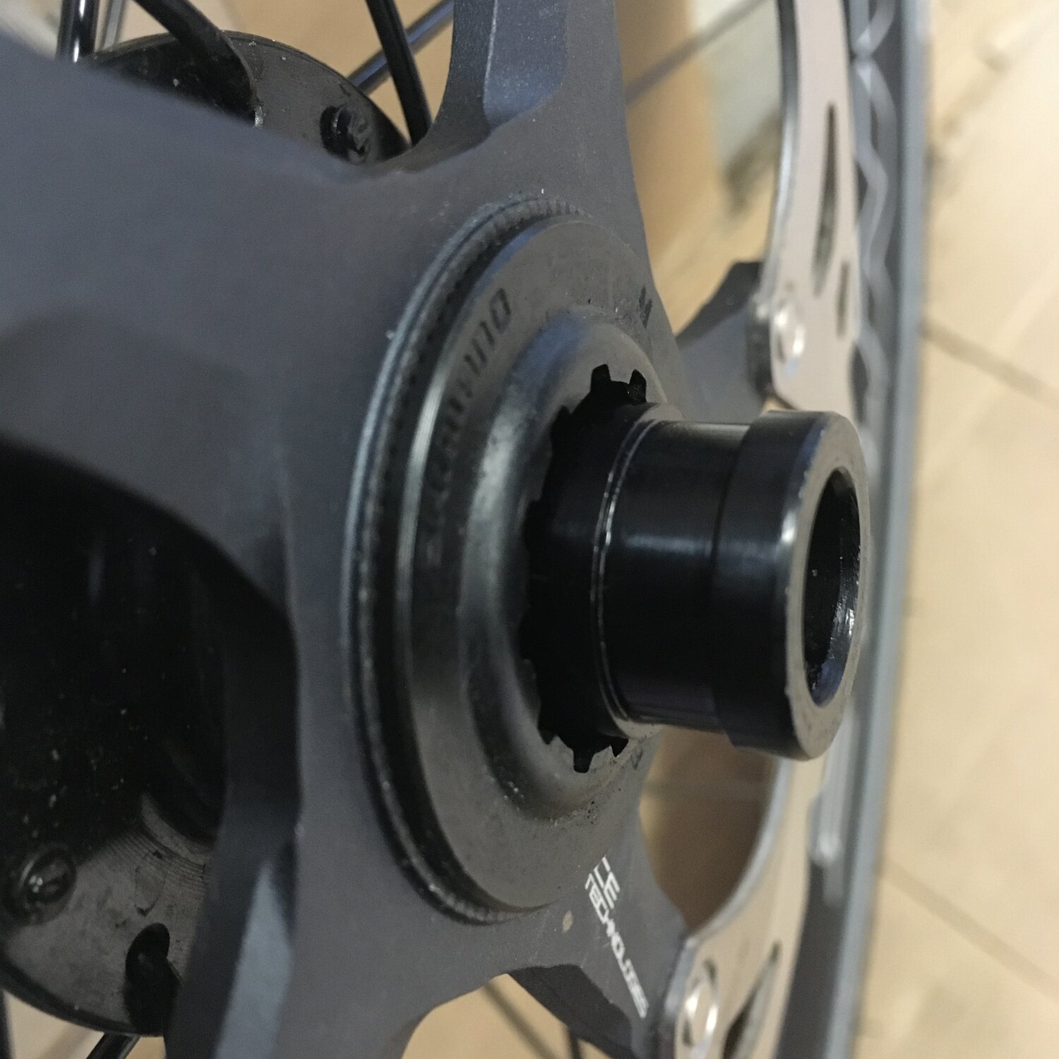

Once you have the diameter right ( not critical size as long as it slips in) now check to see if the length of the nut bottoms out or not. You can either observe this by touch or use a set of calipers to measure the thickness of your disc then the length of the bolt. I upgraded to a six bolt 203 Magura disc with DT Swiss 350 Hybrid 6-bolt disc hubs, 32h, black. Boost spacing, HG freehub. With this set up I had to slightly grind the threads and the overall length very slightly.

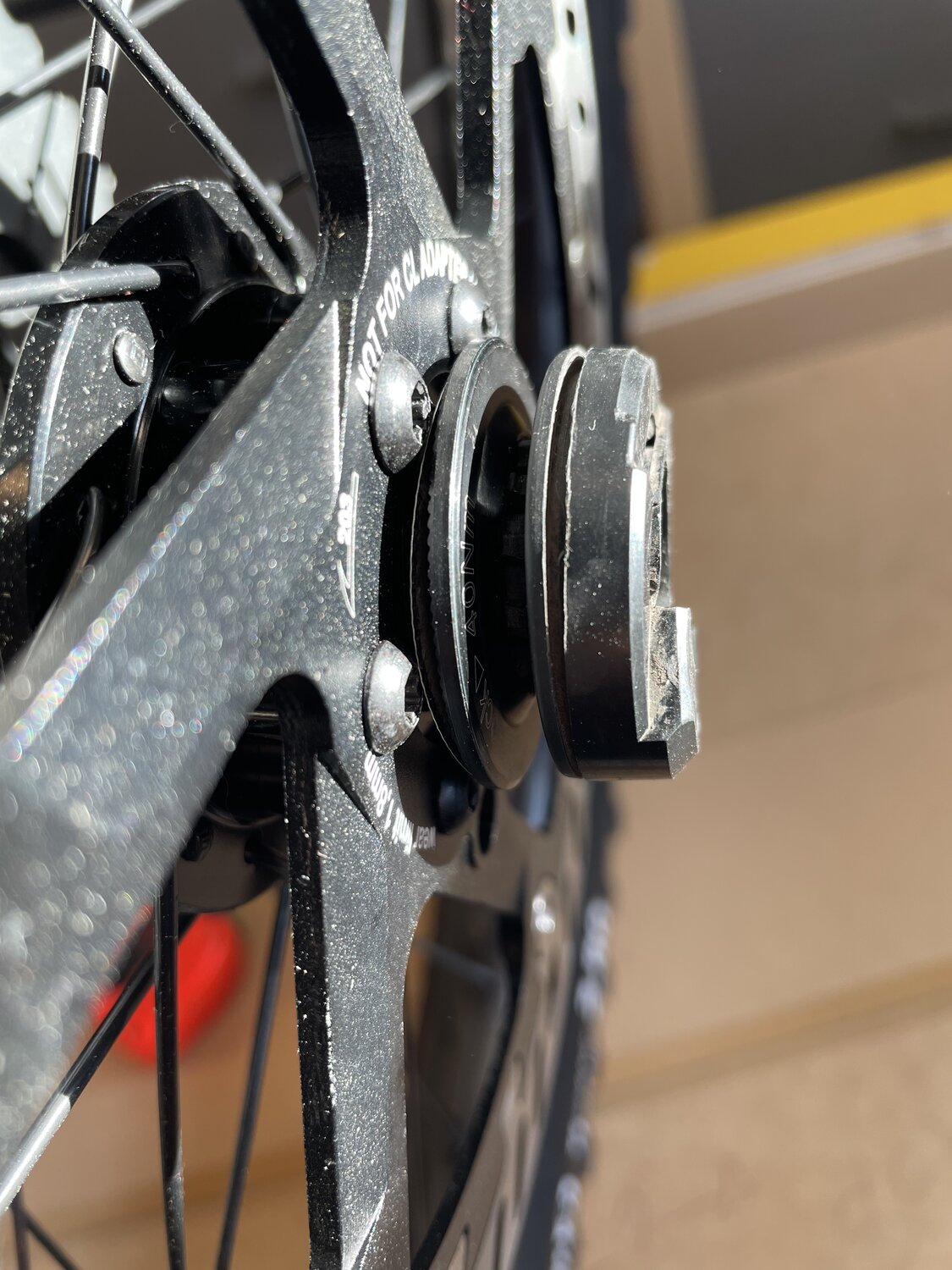

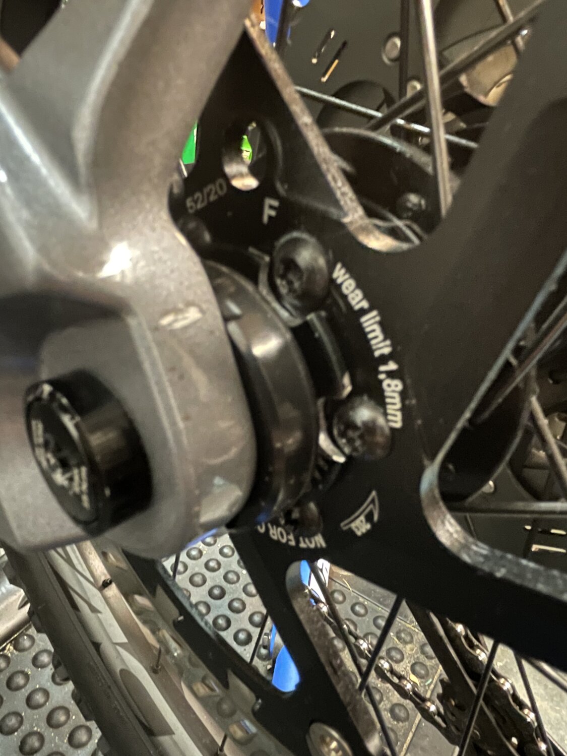

As you can see the nut is prevented from seating properly because of the six bolt heads. Shown here with the speed magnet c/w housing attached
Here is the modified nut in place with the magnet housing seated properly and working excellent !! No more junky hubs n wheels !

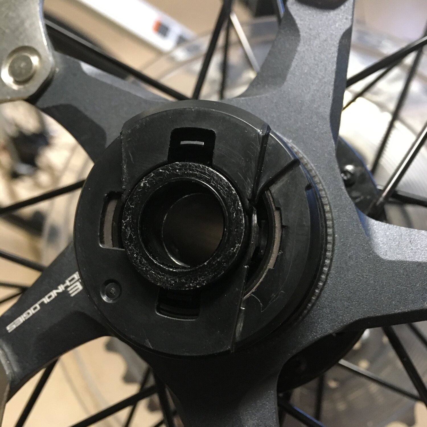

The groove in the end cap only keeps the outer part of the sensor in place, (not rubbing against the magnet holder or against the frame). A hub with a non-grooved cylindrical portion can be modified to function properly, (the cap pulls off).I am looking to build a new wheel set for my new Civante. I will need a CLD 12 x 142 hub that is "grooved" on the left side, otherwise the speed sensor will not lock into place etc. (I have already tried to install the sensor an another wheel without the groove and it does not work)
.View attachment 76668View attachment 76670
Thank you for taking the time to update us on your mishap and new wheels. I got a flat tire yesterday and had to ride my bike for 1 mile on my rims basically so I was worried about what I would do if I bent my rims. I also want to have a spare set of wheels at home now (before I actually need them) for my bike for when the time comes since it’ll prob take 6 months+ to get all the parts to build a new set of wheels. Please post pics of your wheels when you get them on your bike and congrats on figuring this out!!! What a process you must’ve gone through. I think you’re the first guy on here that has actually been able to put on a new non-Yamaha wheel on a Yamaha ebike.The groove in the end cap only keeps the outer part of the sensor in place, (not rubbing against the magnet holder or against the frame). A hub with a non-grooved cylindrical portion can be modified to function properly, (the cap pulls off).

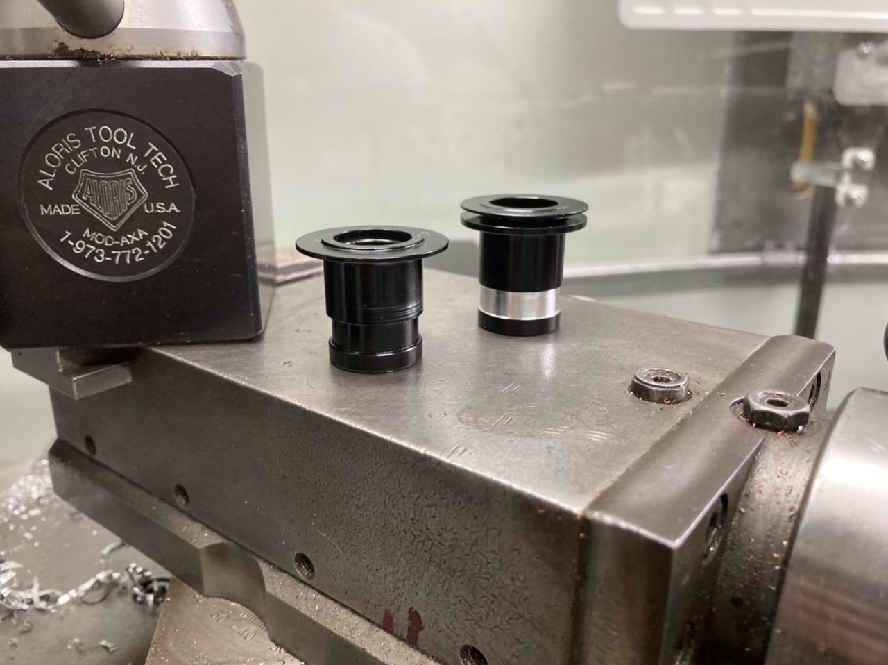

I should have a set of DT Swiss CR 1600 Spline wheels on Wednesday. I will bore a collet to hold the cap and machine the groove into it. I will post the result after completion. It’s a fairly simple modification, but it does require a decent lathe and a collet that is bored to hold the flange or the hub.

You’re not breaking the conversation. Your question is on topic to our discussion.I apologize for breaking into your conversations here, but if anyone finds out how to purchase Genuine Yamaha hub parts, I would sure like to know. I’m in USA and have seriously tried with Yamaha Corporate in California , and dealer Where I purchased my bike. All to no avail. I need the magnet component, as mine broke. Any help would be greatly appreciated! Thx

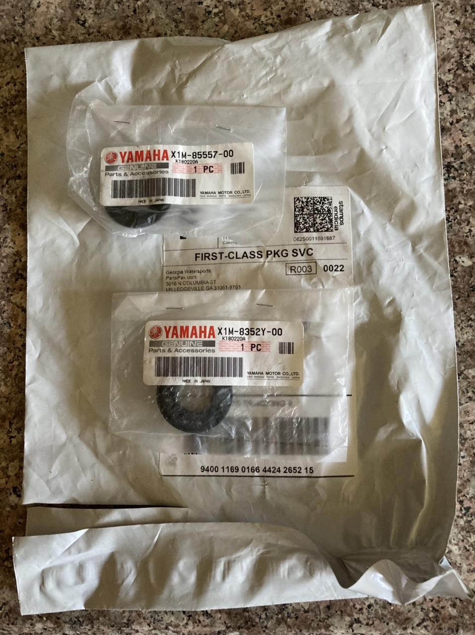

Thank you so much! I will check it out.I ordered a spare through PartsPak.com. I haven’t received it yet, but they claim that I should have it on July 27th. It was a strange source, but any port in a storm.

ORDER DETAILS UNIT PRICE TOTAL ================================================================================================= QTY
1SKU
YAM-X1M-85557-00-00PRODUCT
Yamaha X1M-85557-00-00 Holder; X1M855570000Price: $14.10$14.10 QTY
1SKU
YAM-X1M-8352Y-00-00PRODUCT
Yamaha X1M-8352Y-00-00 Magnet Complete; X1M8352Y0000 $15.95$15.95
I started a “conversation” with you, (please check your mail). There is a person at Yamaha Customer Service that wants to help you with the speed sensor.Thank you so much! I will check it out.
Because of the supply issues and being concerned about the vulnerability of the speed sensor, I ordered the parts from PartsPak.com, (a Yamaha outboard motor source). I typed in a search for Yamaha and the part numbers which led me to PartsPak.com. It took a couple weeks, but they arrived this morning. Their site says that they can still get them. If your order them, you will probably have them in about two weeks.Thank you so much! I will check it out.
What is that that you used to grind the groove on the new flange? Suggestions/recommendations how we can get it done? Thanks!I posted this on my supply line topic as well.
I ended up buying a set of DT Swiss CR 1600 Spline Wheels. The end cap on the brake side had to be modified because there is a groove that is used to locate the outer portion of the speed sensor. The groove is 6.00 mm wide and ends 10.00 mm from the end face. The groove diameter is 19.9 mm.
The CR 1600 has a 130 Kg rating and is also a gravel wheel. A Shimano hub won’t work and there are many wheels that don’t have an end cap that is not already grooved or has wrench flats that would interfere with the groove. The groove didn’t need to be as deep and the one on the Yamaha end cap, (Yamaha’s end cap groove diameter is 17.47 mm).
Everything works as it should. They are nice looking wheels and I have always had good luck with DT Swiss.
