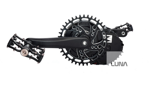

Bafang BBSHD Mid Drive Ebike Kit
Lowest price anywhere on the BBSHD. The new bafang 1000 BBHD will put out a maximum of 1600 watts and is the most powerful ebike kit ever and its a mid drive!

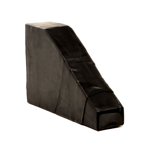

TRIANGLE 52v Panasonic GA 18650 28ah Pack GIANT RANGE + HIGH POWER
52v 28ah Panasonic ebike pack. Triangle 18650 premium cell packs fit perfectly balanced inside your ebikes frame. Luna Cycle is the #1 maker of triangle packs on the planet.
