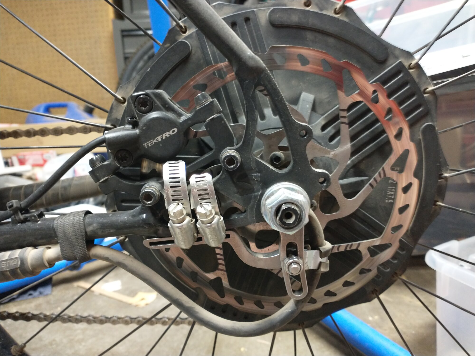

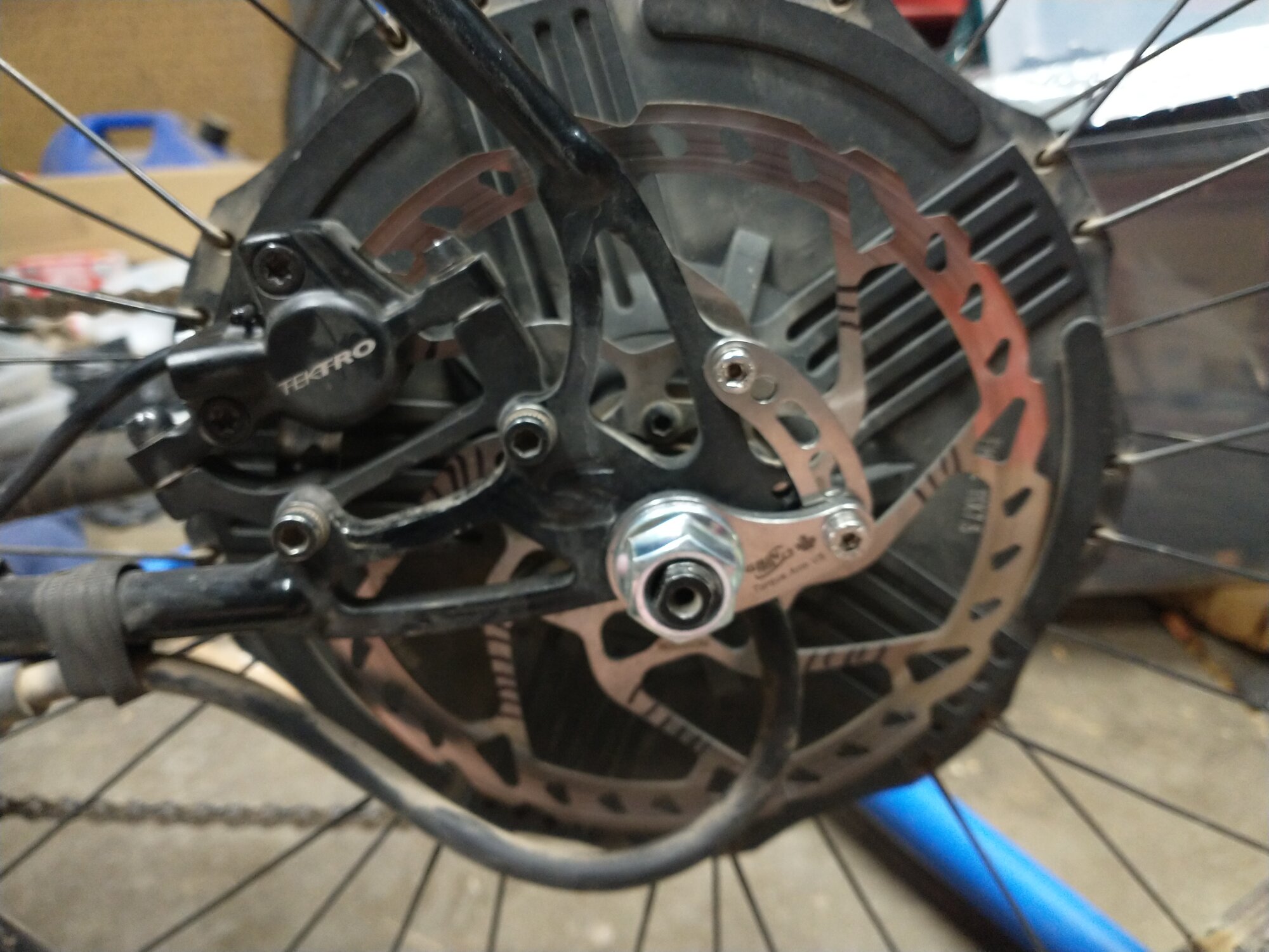

Got the new V5 torquearm today and installation was easy peasy.
The old torquearm just wasnt the best on this bike (hoseclamps were not elegant for the dropouts so I carried a spare set and I needed to carry two 11 mm wrenches to get the torquearm off).
The new torquearm needs an allen wrench and 8mm wrench just like the GMAC.
Congrats to grin for a well designed torquearm 👍

RH212 update
I refused to use those clamps. Nicest workmanship available by any of us is turned to crap with their use IMHO. I've found that "link" used between the torque arm and the bike frame can be easily/neatly made from scrap alum. laying around the shop. Just a matter of cutting it to length and drilling a couple of holes. Results look just like your second picture.....

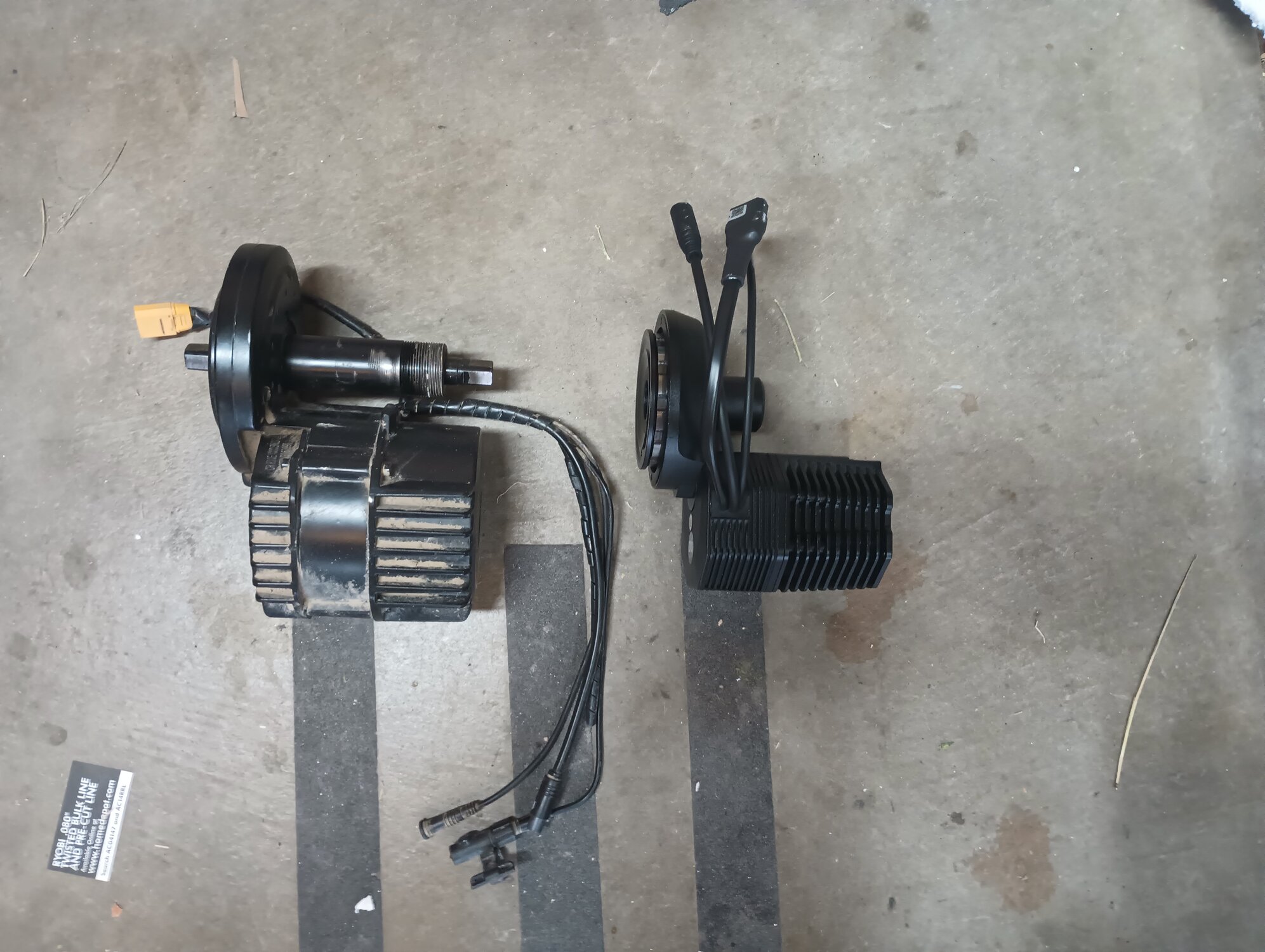

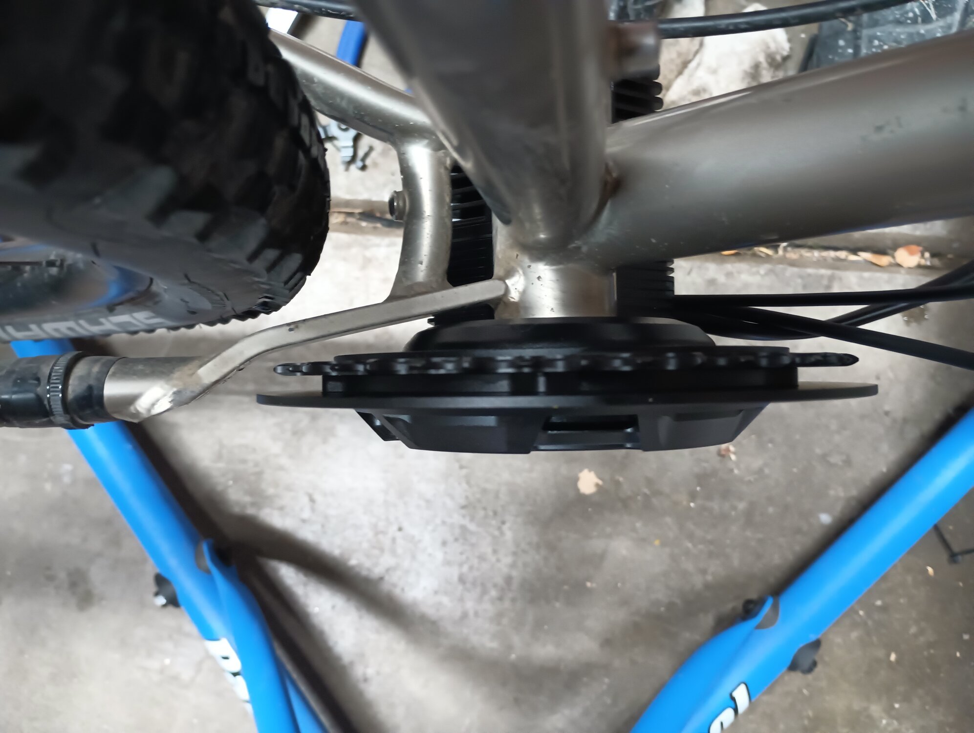

The CYC Photon has arrived, hard to believe how small it actually is.
Pictured here next to a BBSHD

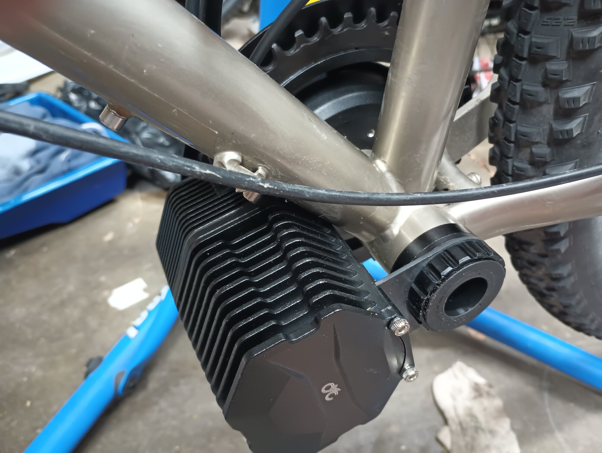

I must say that I am VERY impressed with the quality of the CYC photon. All the hardware is high quality and the motor itself is a piece of art. Install was super obvious and I only needed to refer to the user manual for a quck installation reference.
It is replacing a BBSHD on a Surly Ogre for now. Perfect chainline without any drive side spacers.
Not sure how I will shuffle around my DIY ebikes (this might end up on a surly bridge club eventually)
This was a pretty easy install, I actually spent more time trying to make the wiring tidy than installing the motor to the frame
Initial power on failed. The cable from the motor to the display/throttle was not fully seated.

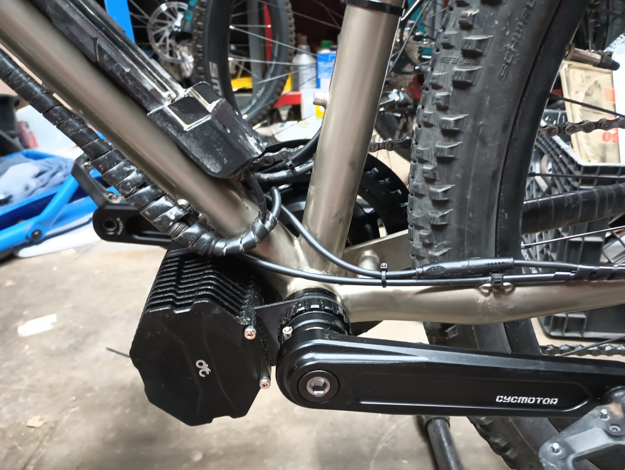

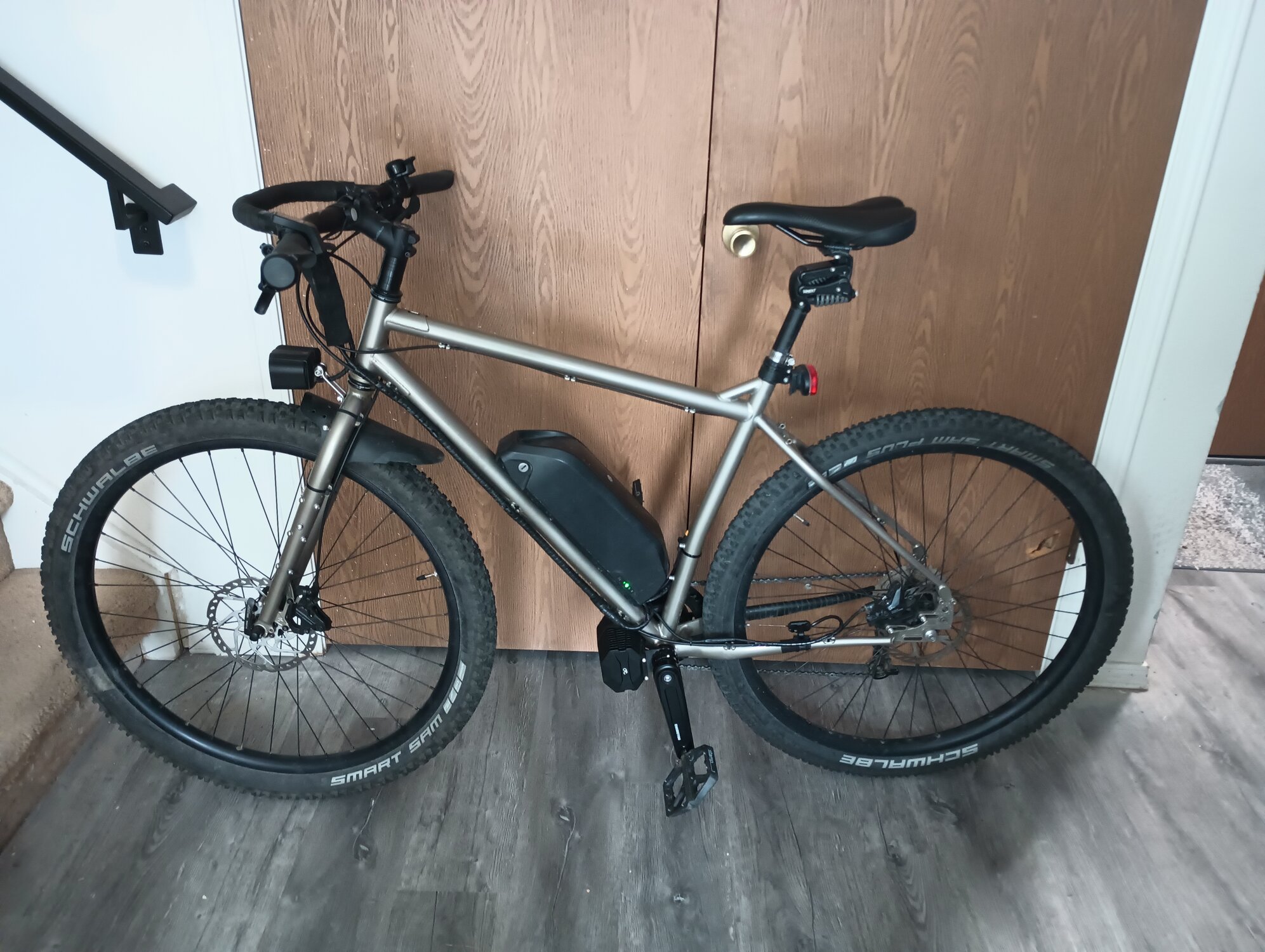

Pic of completed build.
Bent a pin on the throttle connection(no connection on one pin) so when I powered on the bike and went to assist level 1, the bike shot off across the garage.
So no throttle for now. Not a biggie for this ride

CYC Photon Initial Ride Report and Review
Just got back from a 20 mile shakedown ride with the CYC photon. I did a good mix of some steep MTB trails and more of my typical rolling gravel terrain.
This is using a 42t chainring and 9 speed 11-36 cassette
All stock settings except changed to unrestricted mode (no speed limit) using the android app.
3 assist levels with max power of 300,550 and 800 watts.
Initial impression
This feels exactly like my class 3 Brose equipped iZIP Moda E3 as far as power delivery. Not quite as refined as the Brose in response but so close I consider the point mute. The torque assist quality/resolution is high enough quality to allow me to navigate steep technical MTB sections. A MTB section I rode has grades varying between 15-30% and has good size rocks to avoid. When I do this on my BBSHD(same gearing), I usually just end up throttling up in the lowest gear and holding on. Other eMTB brose based mid-drives bikes with lower gearing(34t chainring, 11-42t cassette) have no issues pedaling up. I couldnt make it up this section at the last 30ft where it is the steepest(I ran out of steam), even with 800w of assist and the motor reached a temp of 89F. I have never tried this on the Moda with the same gearing which would most likely have the same outcome. I need to go to a 11-42 cassette if I want to do this on the Photon although I can just as easily choose a slightly different route but this is the worst case I would use for this setup.
Just riding around in the 4-6% rolling hills was very nice, never saw temps over 61C even on some hills around 10% and 550 watts.
As far as max speed on the flat with little wind, Going past 23 (25 in tucked aero position) got really hard running at 800W but motor temps still only maxed out around 60C.
Power limits can be set higher which I will do eventually.
The SW102 display s$cks. Hardly readable other than the speed in direct sunlight and just like the eggrider, the fonts for everything but speed are just too damn small. I basically have to stop and cup my hand over the display and remove sunglasses to see anything other than speed. Not sure if I will try to upgrade next.
The Android app is awesome and can change alot of the system behavior just like the Specialized Mission Control App on the 2022 turbo levo. Very intuitive GUI.
Average speed was about 2mph less than my higher power GMAC and BBSHD setups for the same ride.
This is not as quiet as I would like. Im super picky about quiet motors. Definately louder than my BBSHD and 2022 turbo levo. Loudest at low speed/high power like most drives. Maybe it needs to break in. Will report more later
Overall initial thoughts
If you would like a high quality DIY setup equivalent to the big 4 mid-drive ebike makers, this would be a good setup.
I am impressed, not sure I will keep it in the long run (would likely replace with their upcoming higher power unit) but think this would satisfy alot of people.

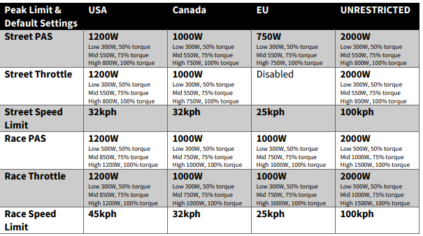

This ride is basically the same route described two posts above (#293) with the exception of not doing the super steep section I had to walk up before.
The Photon was setup unrestricted in Race Mode with 3 assist levels (Low 500W, 50% torque, Mid 1000W, 75% torque, High 1500W, 100% torque) and no speed limit
Started out in highest assist level 3 riding to a trailhead and then started a 4-8% climb for a mile as fast as my fitness would allow. Temps seemed to settle in the mid 80s.
Got to an alternate to the super steep section that was only 15% max and climbed it no problems in assist level 2 with temps in the mid 80s.
Most of the rest of the ride was very pleasurable with me just loving the quality of the torque sensing and how light the photon is which is so much lighter than the BBSHD or GMAC. Temps were mid 50s to 60.
The last few miles of the ride was a high speed road section with a slight uphill (maybe 2%) with probably a 5mph headwind. Using assist level 3, I easily got up to around 30mph for a short stint and then felt the power drop off as the temps reached 90C and it was hard to maintain much over 26mph (photon cuts power to about 800watts when temps get above 90C).
Dont take this overheating as a bad sign, its just physics. This small lightweight motor isnt designed for substained high outputs. If you want substained 28mph+ speeds, get a 1500W BBSHD or GMAC
I like the stock settings for street and race mode, dont think I need to change anything at this point. I will most likely always keep it in unrestricted race mode (assist level 2 90% of time)
The display brightness can be toggled by a long press on the up assist button on the controller to help see in daylight. It defaults to the dimmest setting.
Note that the photon has the ability to start out on just torque to the pedals without cadence (which can be turned on/off). Scary the first time it happened but very nice once I got used to it.
The photon seems to have a shutter starting up from a stop when at max assist. It doesnt last that long.
See attachment for the different modes
