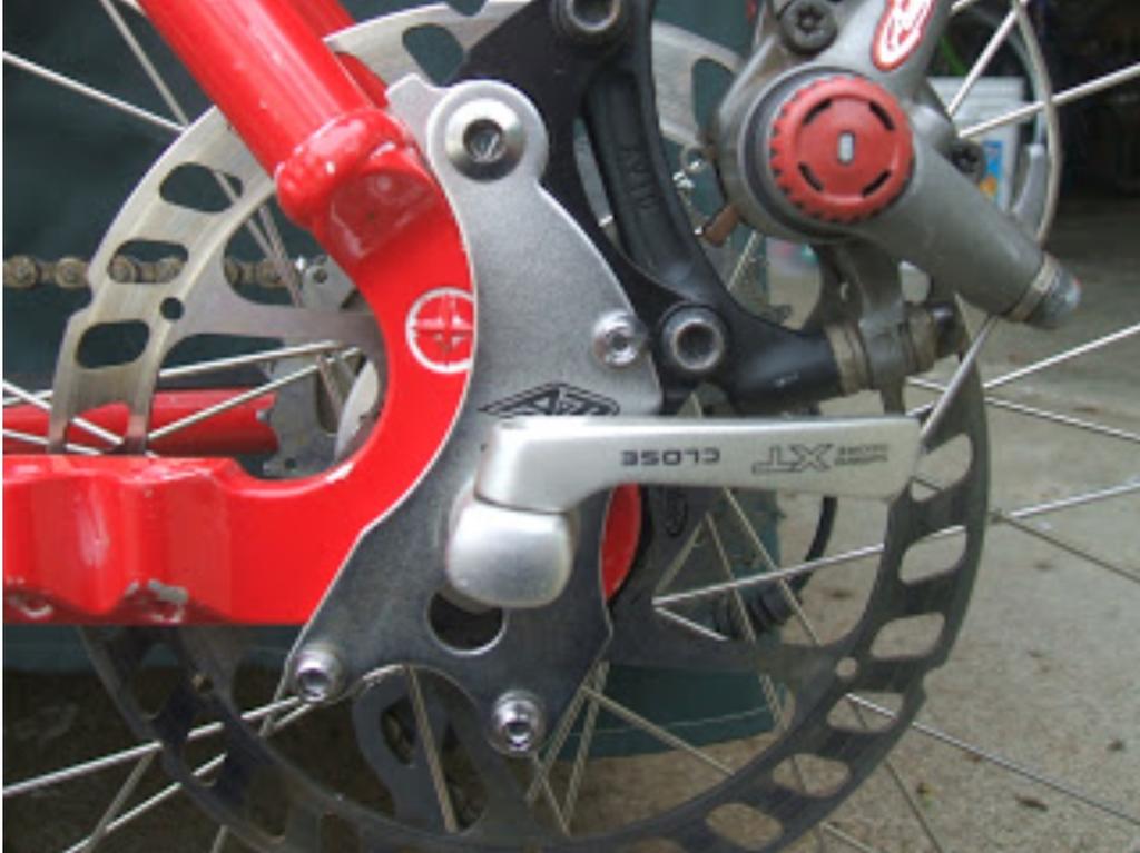

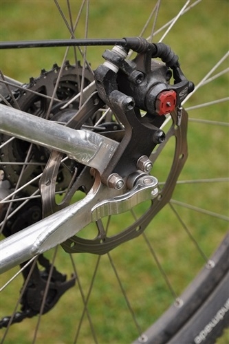

You might be able to convert to disc brakes, I did it on my Zaskar about 10 years ago.
For the front, just buy a new fork with disk mounts. When my zaskar wasnt my primary MTB anymore I put on a rigid disc fork. I bought a suspension fork awhile back (rockshox reba) that had both canti and disc brake mounts.
For the rear, you could use the A2Z adapter. I used this for over 9 years on my Zaskar. Its big, bulky and fiddly but works
I knew this could cause problems with a hub motor so I recently got an adapter specifically for the Zaskar
I still might have fitment issues, we will have to see

I originally had the a2z adapter. It was pretty commonly used back when I bought it in 2007ish, Its very fiddly to get setup/aligned but I used it for 13 years. It only has a hole sized for a QR skewer so you would have to drill it out.
Depending on your skills and patience, you could likely even use it as a torque arm.
I felt it would be too much work so I used the other adapter that I found on ebay (the black adapter on the silver frame). That design while frame specific was soooo much nicer and simpler. In the end, it interfered with the GMAC torquearm
Thanks for the info - very useful. On the Zaskar, did you have to drill the mounting holes to the dropout plate? The A2Z looks quite secure with the four bolts - I'm a bit unsure about whether two eyelets would hold a caliper well? Mind you, they're good enough for a torque arm so in assuming it wouldn't have too much issue. This is the torque arm I'm using. The way the dropout space was cut into it means I have to mount it in a weird way which covers up the second eyelet. The mudguard struts are quite far out which pinches the mudguard itself up top. I'm looking to devise an all-in-one solution.
If I have a plate cut, it would be secured in the two eyelets above the dropout, plus the nut on the axle itself - should be fine right?!
