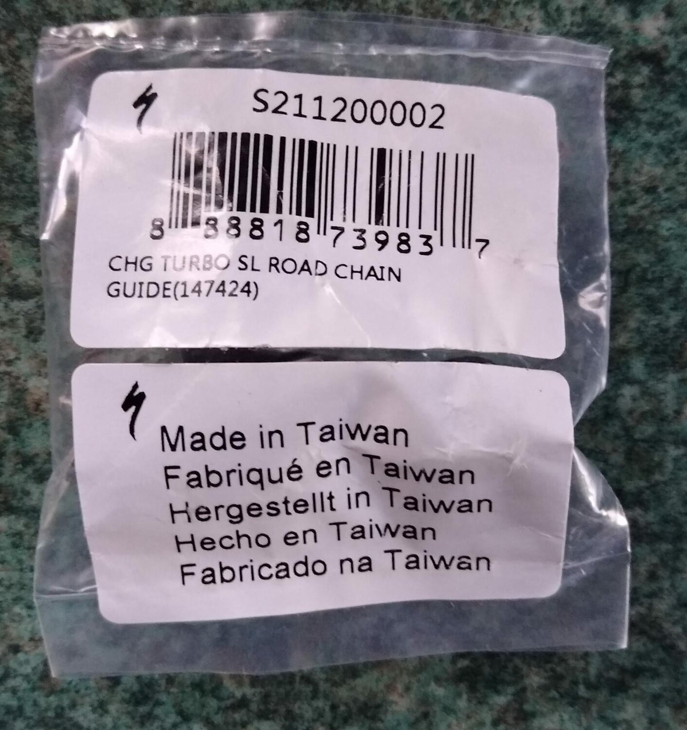

I had the same problem and wrote to Specialized. Here is the response:
I'm sorry to hear that you Creo is having issues with your chain dropping. There is a chain guide available to order, it is a service part so your local Specialized retailer can order it for you. I've checked stock and we do have it available!
Part no: S211200002
Hope this helps!

Thanks for that part number. The oddball parts like the remote power buttons and this item do not show up on the Specialized site. I gather they want you to get through the local shop - breeds loyalty (or contempt!!!)

The chain guide attaches to one of the motor mounting bolts. My LBS ordered one for me and installed it shortly after I got my Creo CC EVO. I have been fortunate enough to have never dropped a chain while riding my Creo.
Being the somewhat impatient type although I'm sure shipping from Europe will tax that - I ordered the part. Now hoping it solves or reduces the problem. As the thread @JeffC57 referenced has someone posting that they still drop the chain.
