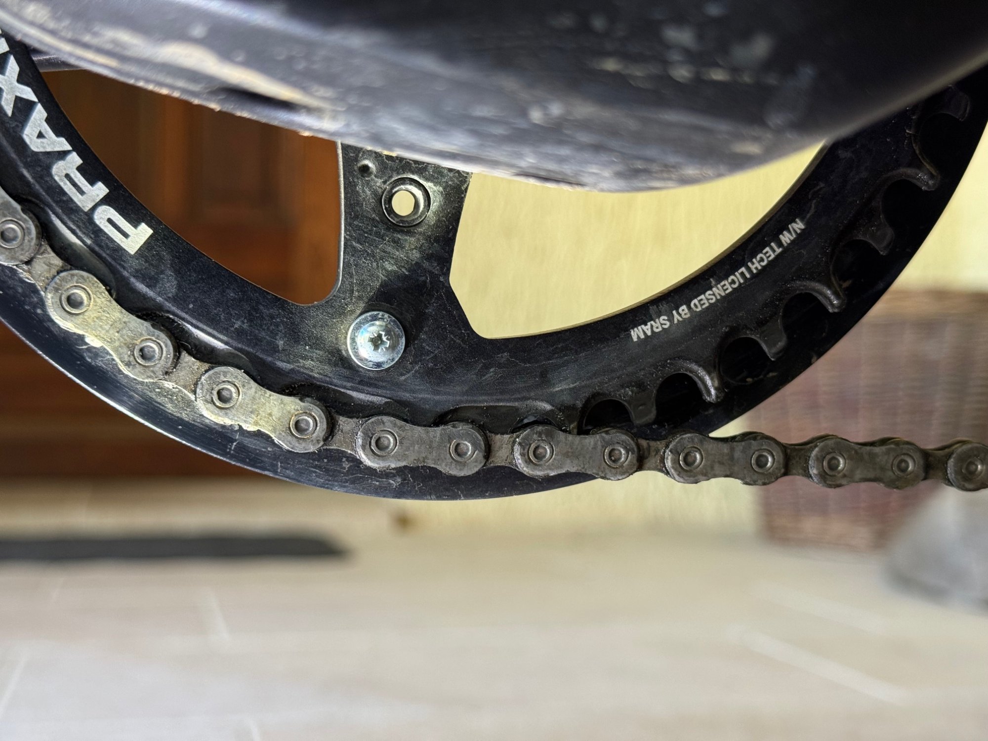

Update on the Praxis chainring. On my Spec Vado SL2 6 the chainring is designed so the the chain will only fit one way so there are now no markings - unlike my older Spec Vado SL4. If you align it incorrectly it simply won't seat onto the ring.
See pic
See pic
It is the same with Garbaruk chainrings.
