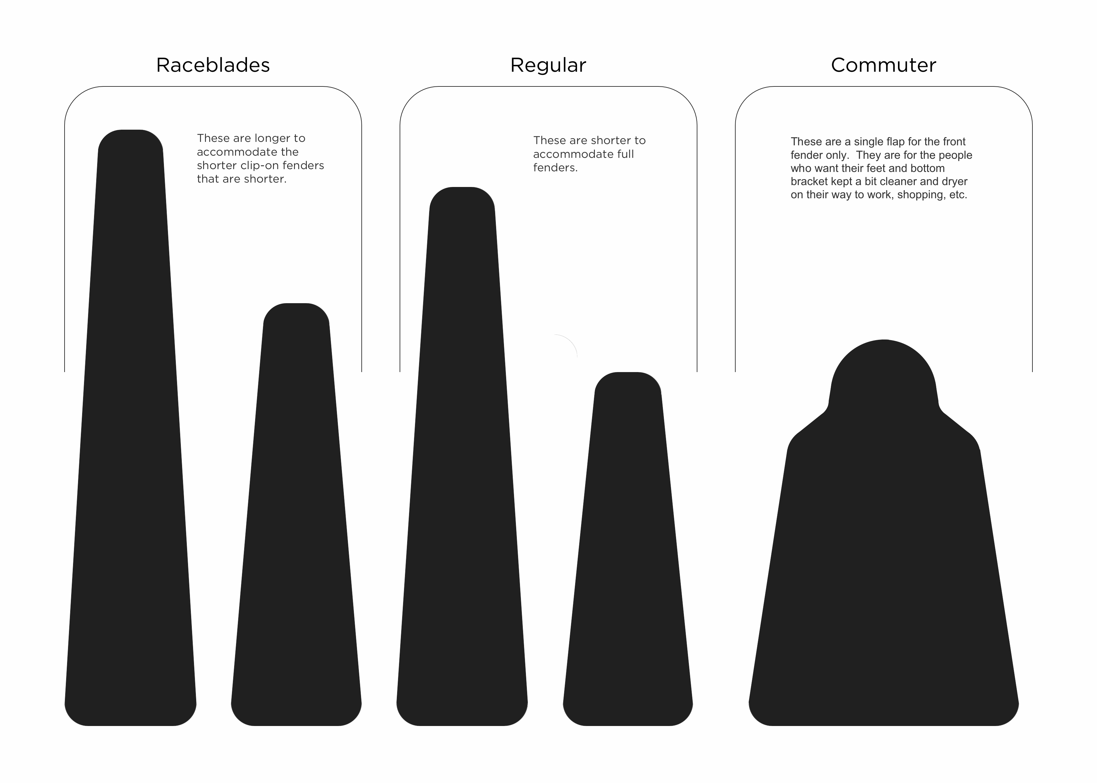

Check your bottom bracket for dirt and flying debris. I think the mud flap is not long enough to protect the underside of your ebike.
You may need one of these longer flaps.
