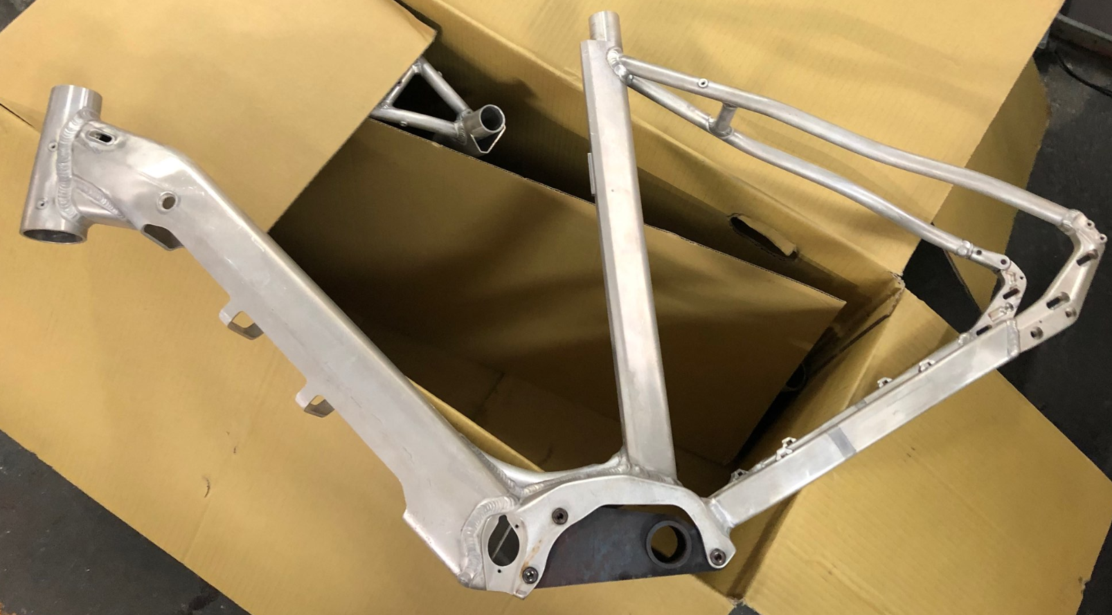

Quite excited to see this come to fruition. Frames ready for painting
4th Gen Bosch motor - excellent reliability and speed ✅
Gates belt drive - silent, super-low maintenance, long service life ✅
Rohloff E-14 Internal gear hub - ✅
1000 Whr Dual battery for all-day riding - ✅
Step-thru frame for a kickass mama - ✅
