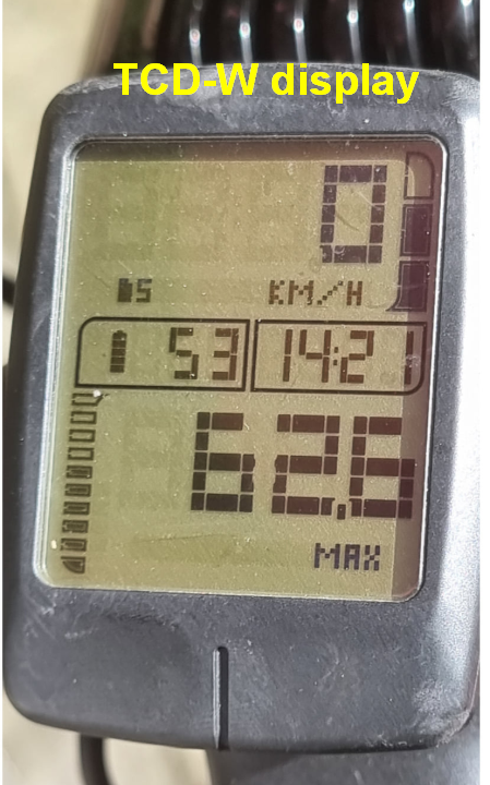

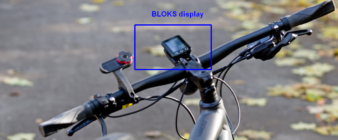

Mission Control app is free. Is your e-bike equipped with the BLOKS or TCD-W display? That is very important. The older BLOKS display has big issues, often making the power lost to the motor unless the display is reset.
I assume your Vado 6.0 is equipped with the BLOKS. Even if conversion to TCD-W (Mission Control compatible) is expensive, that would make your 6.0 a brand new modern Vado. Been there, done that.

Tommy: It goes like that (and it is confusing).
  • TCD is a wireless display that has nothing to do with your Vado 6.0.
  • TCD-w is not only a wired display that totally affects the e-bike operation but conversion from BLOKS to TCD-w requires applying a whole conversion set* and dismantling half of the e-bike. I got the conversion free as a warranty service.
If your dealer does not know the difference between the TCD and the TCD-w conversion set, I see it in dark colours.
Hope that helps.
*) The conversion set includes many components, not only the display.

I found this forum in my search for a solution to my problem. I have a Vado 6.0 from 2018, still on the BLOKS system. A few weeks ago, the BLOKS computer stopped working.
The lights go on, when I turn on the bike, but the screen stays dark and the motor does nothing.
My LBS says I have to convert to the TCD-w system, and tells me that Specialized will charge him € 1000,- for the conversion kit. That's right: € 1000,-.
I have a local contact with Specialized, he asked around, and they tell him the same.
Does anyone know if a new (other) BLOKS head unit will solve my problem (for a while)?
Anyone knows a way to get the conversion kit myself? I don't mind to get my hands dirty...

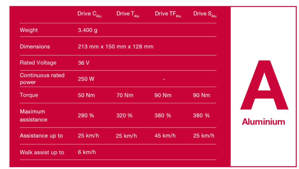

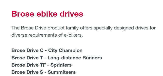

Please read:
Specialized 1.2 E motor is the Brose Drive C, specifically marked as Brose CB.
  • Brose CB = Specialized 1.2E
  • Brose T = Specialized 1.2
  • Brose TF = Specialized 1.2s (Europe only)
  • Brose S(alu) = Specialized 1.3
  • Brose S(mag) = Specialized 2.1 (e-MTB)
There are newer motors, too. What Specialized was allowed to do was to unlock the CB motor for 20 mph and all other motors for 28 mph for the U.S. market. Brose C (Brose CB) is a distinctive motor.
