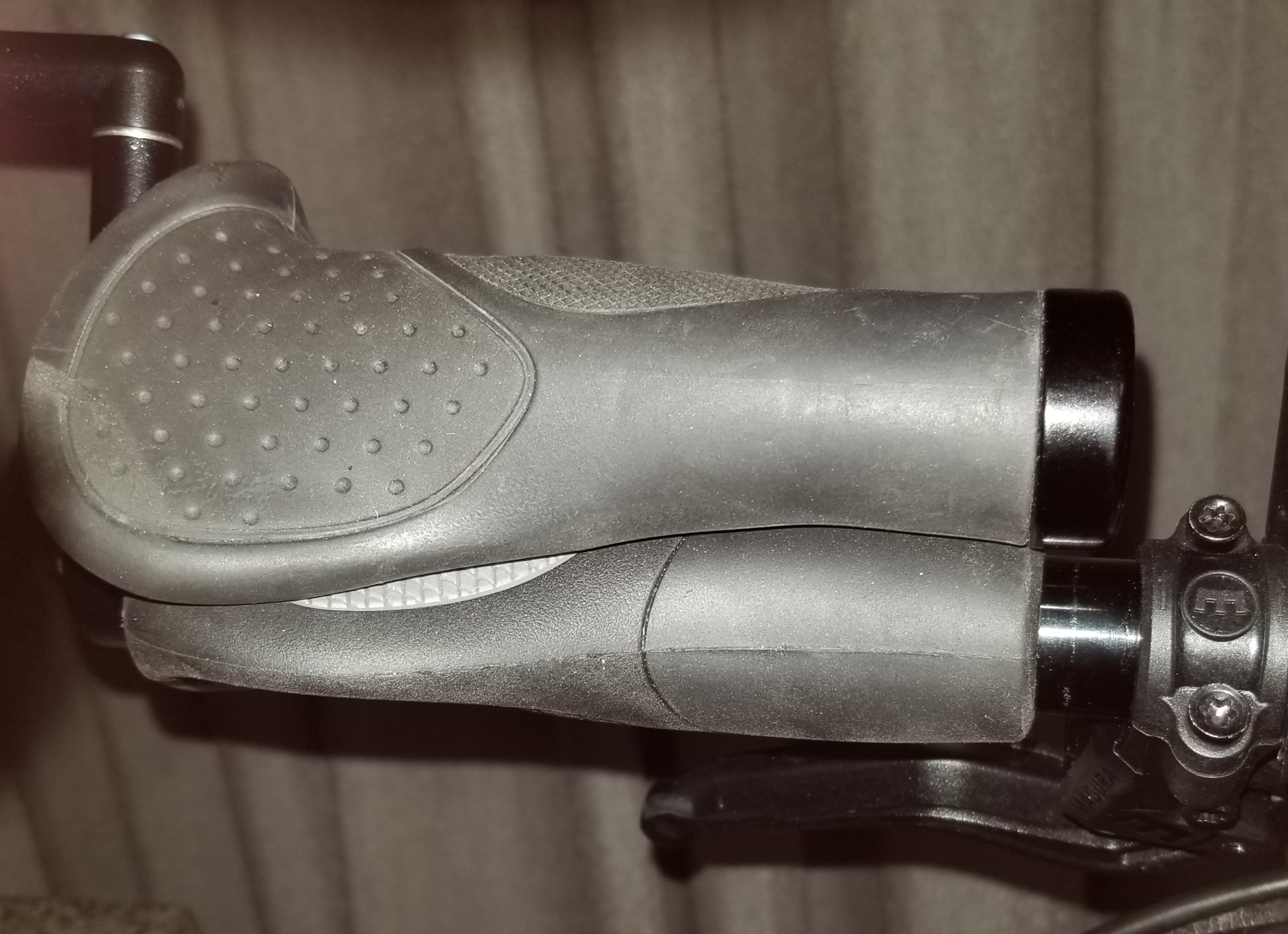

Stock grips are fine, I really like them! But attaching a bar-end mirror is problematic.
My CCS bike's grips were ruined in a bike crash two weeks ago. I looked for similar replacements.
And since I am beginning to ride around again, I want a bar end mirror.
Found on Amazon these Ergon grips and they are about as comfy as the stock grips, with open ends.
The open ends are suitable for any bar-end mirror. Or use the supplied bar end plugs...
Ergons are perfect for a made-in-the-USA Mirrycle
The mirricycle was recommended to me last summer. I bought two of them and bought two more this winter. Most of my grips have plugs like your example, but I had two bikes without them. I just cut holes in the rubber.

Right! I really liked stock CCS grips for their rubbery wing-like ends. They are fantastically comfortable and secure. But the outer-end lock-on of the CCS grips is internal and vital to prevent the CCS grips from rotating away from the palm. This design precluded the use of a Mirrycle. Hence, the Ergon: a pricey German-designed alternative that is no more comfortable than the stock CCS grip, but whose lock-on is an external split ring clamp.

Are those grips the same length as the stock ones?
Shorter, by about the width of the stock grips' inboard end black metal ferrule.
