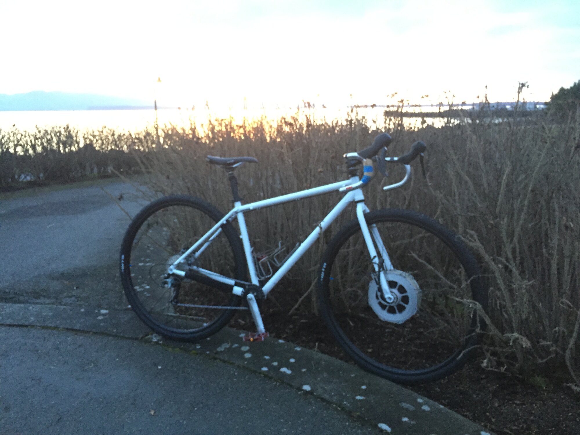

Here is a picture of my current setup with the Grin hub motor that I got a chance to ride around quite a bit un powered in and around different terrains with some significant elevation changes. It actually surprised me that is did so well.
I also have been using mid drive systems for my mtb riding for a number of years and do prefer that for trail and general dirt use but for primarily road riding I prefer the hub bikes. To me having both at hand is truly the best of both world's.
