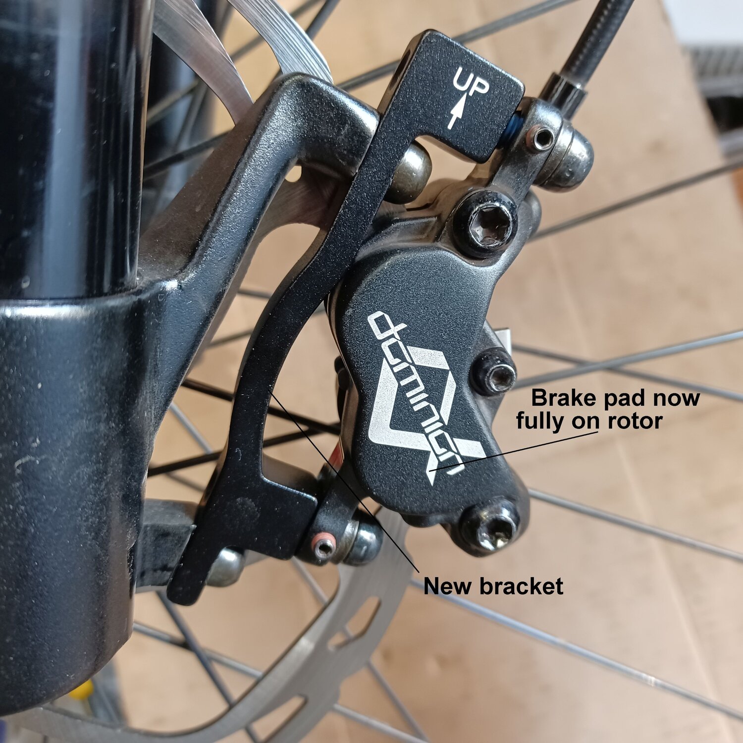

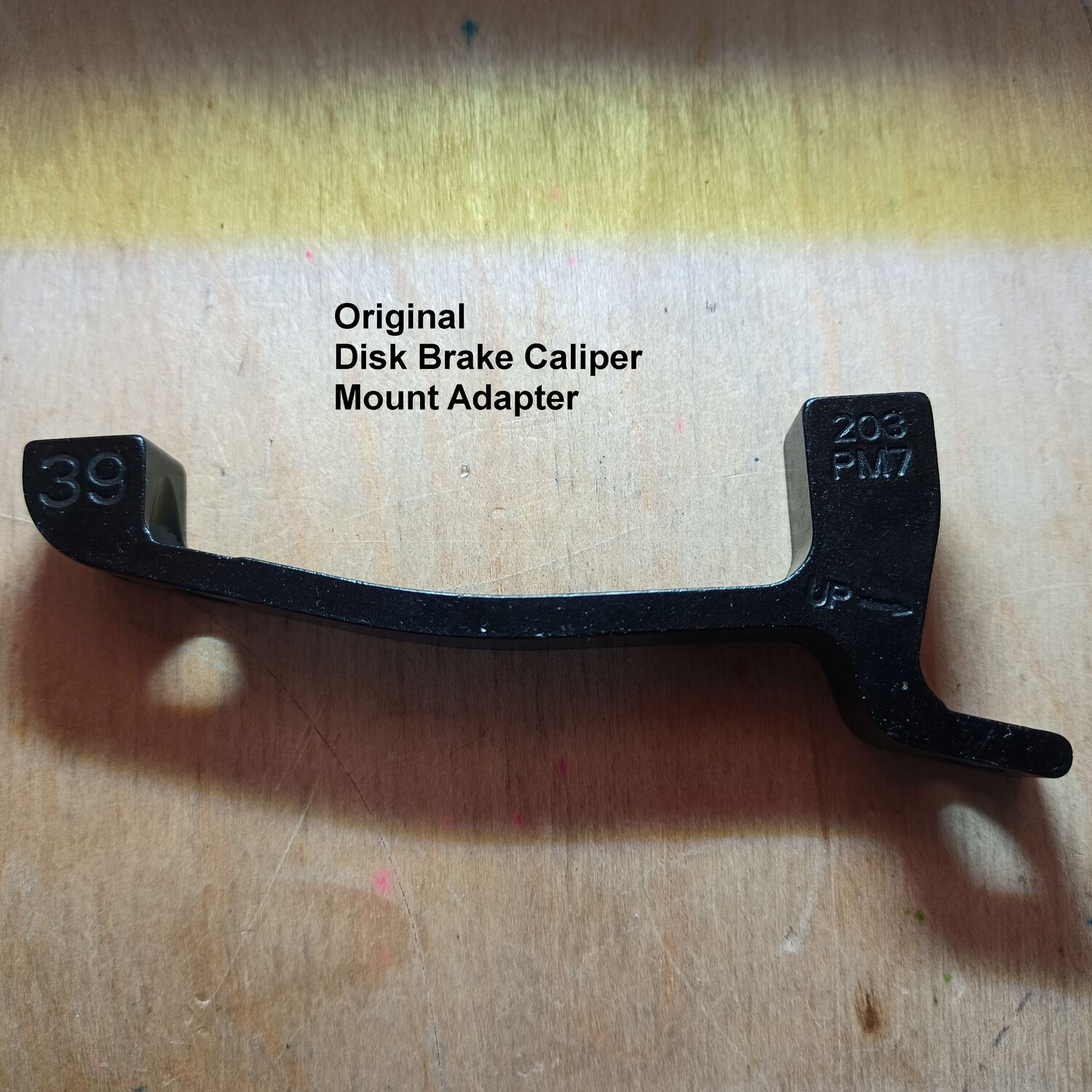

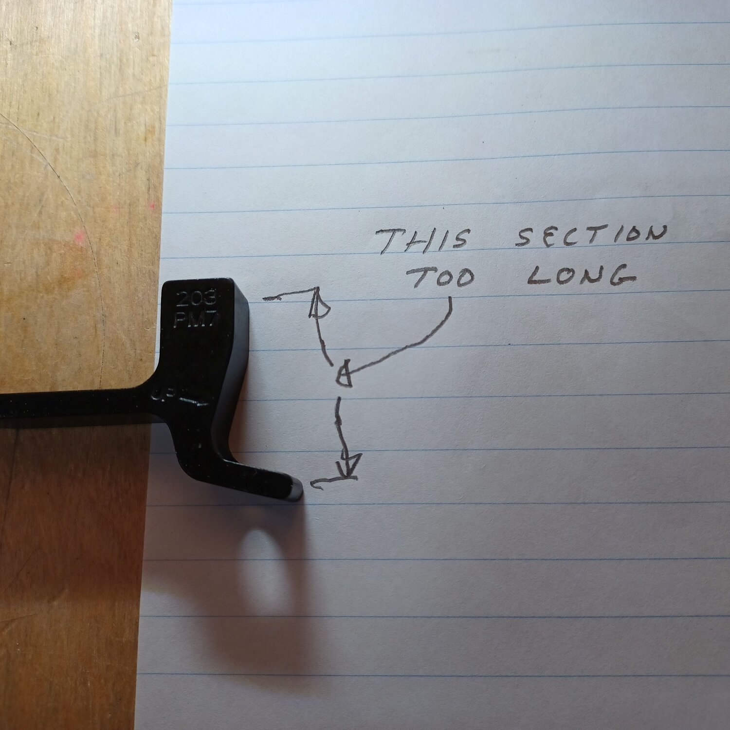

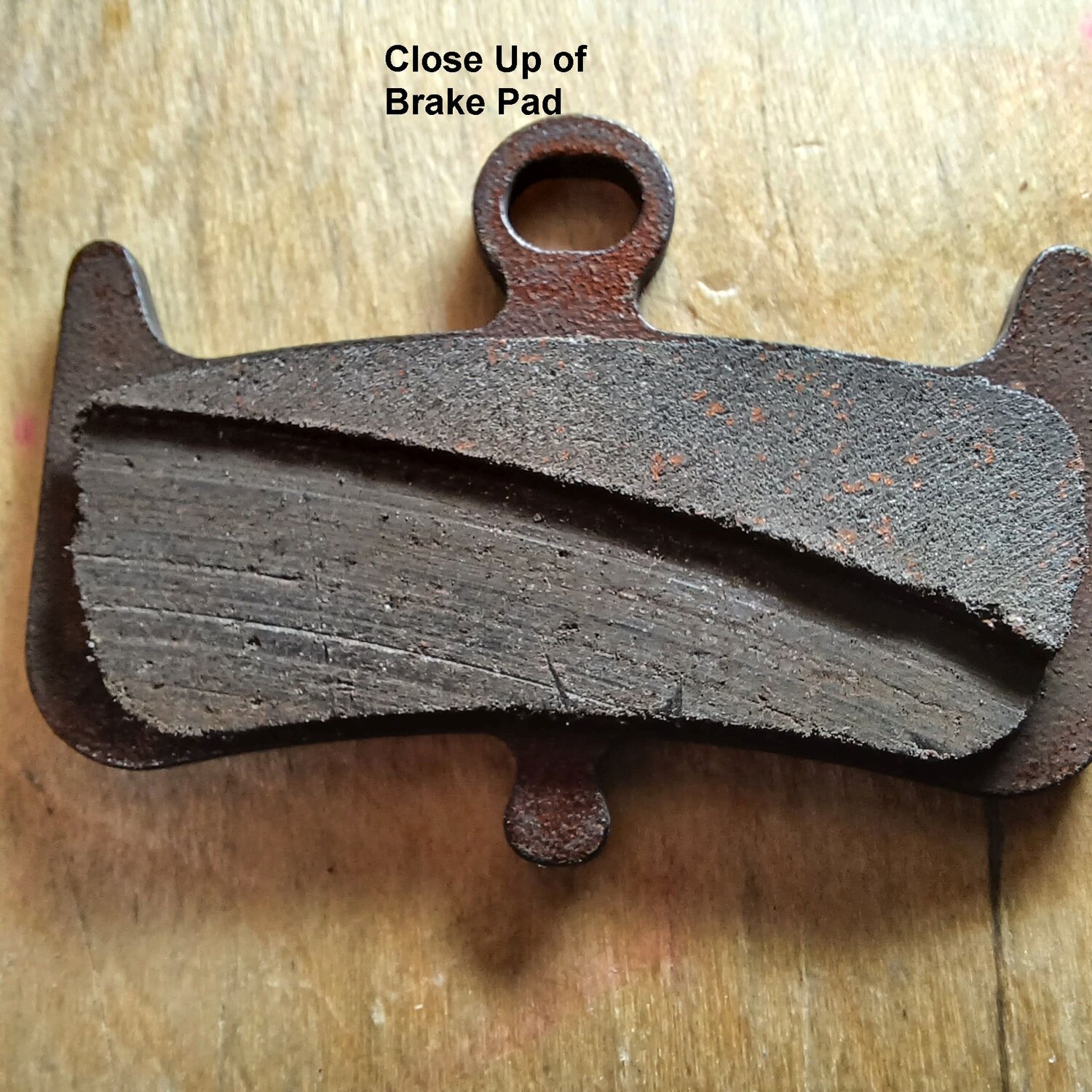

Front brake problem with,
Luna Cycle X2 with DNM Suspension.
I only have about 400 miles on my new, Dec 20 2021 picked up on Dec 22 2021. My front brake was not stopping as well as it had earlier, so I ordered a set of replacement pads. When I removed the front caliper, I found that the pads were wearing in a very unusual way (see photo #1). Checking the front suspension and the brake mounting, I found that the adapter that Luna (or Chinese manufacture) had used is very incorrect! The stock mounting had the pads only half engaged on the rotor! It seems with this wear pattern ( my brakes were starting to fade because the top of the pads where making contact with each other, and not fully on the rotor! A quick look at Amazon and I had picked out a suitable new adapter (Amazon has several that look like would work). https://www.amazon.com/gp/product/B08D9KPL7M/ref=ppx_yo_dt_b_asin_title_o00_s00?ie=UTF8&th=1&psc=1, is the one I used. The rest of pictures show how I came to this conclusion.
Yeah, looks like a # of the first DNM batch went out with the wrong mount - Luna replaced the wrong mounts for fee AFAIK if you contacted them.
Not a great thing and good you caught it, as the unworn parts of the pads coul eventually reach each other, reducing actual braking.
Heard but cant confirm definitively Luna’s doing additional QA and test rides before shipping, probably as a result of things like this.

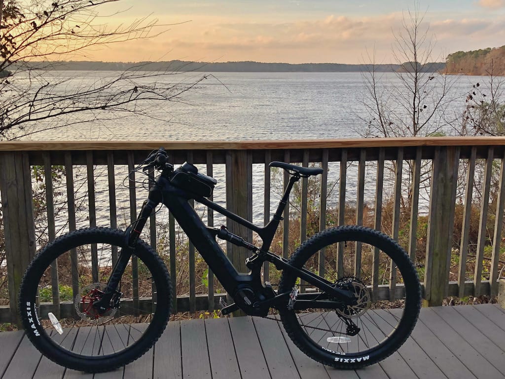

Had an exciting day last weekend at my local trail. Met 3 guys and a girl at the trailhead riding Specialized Levo and Levo SL bikes. We went for a 2.5 hour ride (18 miles) and road a mix of xc and tech trails. Alot of sandy conditions and it had just rained the night before. I have never rode with a pack of Levos and was excited to see where the Luna X2 (non Ludi) matched up. I had remove the DNM suspension and run Fox 38 and Fox Float X. Well the Levos started out the ride in Turbo and I had to figure out which power level I needed to match their speed. I have configure the controller for 9 power levels. I found level 5 was my sweet spot to match the pace of the other 4 bikes. I found the X2 was not quite a poppy as the Levo SL. The Turbo Levo's were more of a closer match on our ride. Their Levo bikes were all stock with stock tires. I had a slight advantage since I ride the thoes trails a lot and knew which gears to select. It was amazing to finally see the level I was at when riding with the Levos.

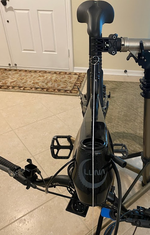

Just completed installing the Wolf Tooth GeoShift Angle Headset (-1 deg) on the X2. I was able to install it myself and just came back from a ride. I was not sure I would notice any difference changing to -1 degree slacker. But I was surprised that the ability to maneuver tight technical sections was actually easier. On the downhill and drops it felt pretty good and was inspiring confidence. I would recommend anyone with a Luna X2 looking for a slacker setup to consider the offset headset. I measured the fork angle before and it was 66 degrees and now is 65 degrees.

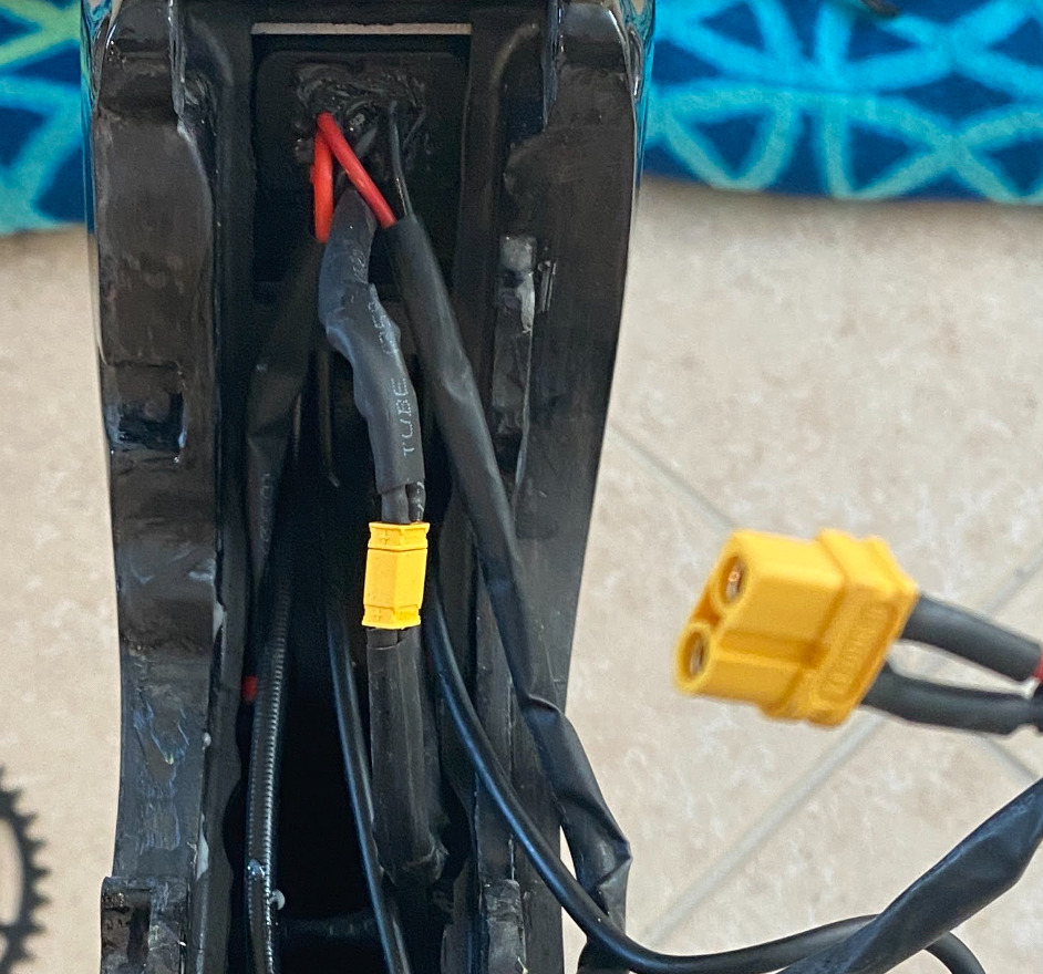

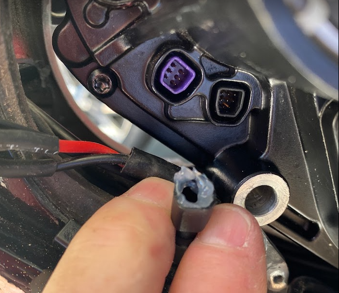

Last weekend I had a failure of the Bafang torque sensor (non Ludi). It failed by providing uncontrolled assistance then no assistance. Now it has stopped providing assistance while pedaling. Throttle still works and no error codes. I connected the BESST and was able to read the controller. I reflashed the controller firmware and did a calibrate without issue. I opened a ticket with Luna. It was 3 months ago Luna repaired the motor clutch after it was allowing the pedal to slip.
Update:
The M600 controller went bad. Purchasing the upgraded v2 Ludi controller and Luna is sending it all back ready to go. One important difference is the battery pack on the X2 non ludi v2 bikes have a lower rated (battery) BMS of 35 amps. Limiting the max amps in the VESC app to 34amps is still good for around 1,000 watts which is plenty for my riding style. I'll call it Ludi Lite?

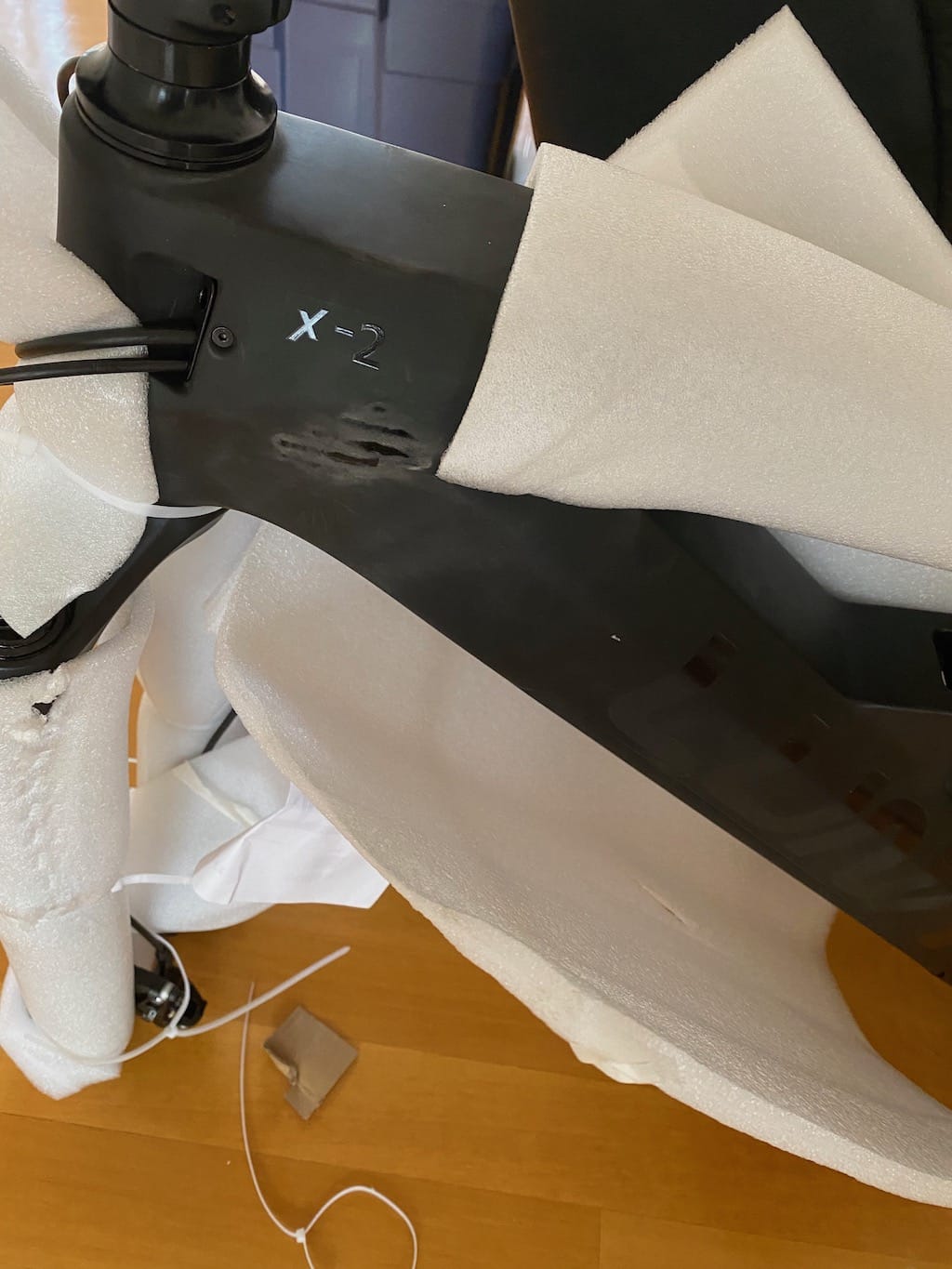

I woke up on Black Friday, checked the site, and saw the X2 and Z1, and the X2 was nearly exactly what I'd been looking for - but with a programmable controller option. Some not-entirely-quick searching to make sure this was a 'real' controller, and quickly found one of the controller developers, who has worked on motor controllers on the VESC platform, including his own hardware, since at least 2014 or so. VESC is a broad family of both hardware controllers and a well-developed mature software suite for programming, log analysis etc. In short - this is the real deal/not a hack, and an earlier variant was released early 2021 for the BBHSD with some fairly impressed users. It also allows for data-logging, something I found extremely useful in tuning car ECUs, and you can do some cool stuff with the data.
At 6'0" I waffled a bit on frame size, as the X2 is essentially an E10 Dengfu frame or a slightly modified one, aka 'the Cheeb' on YouTube and emtb forums, and I could find people of the same height (6'0") both saying they wish they had gone with the medium as well as the large frame is great. I have a plan percolating in my head to eventually convince my wife, who has a Bosch-powered Gazelle, to move to an eMTB at some point, while she flat out refuses to ride my fat BBSHD bike... so said screw it and ordered a medium. Apparently the mediums were out of stock within hours, and the rest not long after, although I think they now have some DNM suspension bikes ordered for ~Jan delivery.
The bike showed up around 10 days later. After seeing sooo much drama and people handing out cash now to 'hope' they get a bike in 6-9 months, well - I'll just say it, that was rather nice.. that was actually one of the reasons I'd considered just building one fully from parts - uncertain delivery dates with most vendors at the moment. It was well packed, zip-ties, foam and cardboard, but somehow I still managed to have a frame scuff...looks like not even breaking the surface, which is good, but it's there..
Putting it together was pretty simple. I spent some time checking fastener tightness (almost all were good), adjusting the controls, and pulling the seat post out to apply carbon assembly paste and set for my height. I put on my pedals and a front Hope floating rotor (mostly for the bling as will be going for a black/red scheme.. but SRAM rotors are also known for getting kind of loud..), which needed a bit of filing on the caliper to clear the rivets, but not bad.
The overall bike in Medium, for me, seemed to be a good fit, which was a relief - including the reach. I may eventually replace the dropper with a longer one, as I did have to raise the seat post a few inches (still well above min insertion). The controls out of the box were kind of wonky, so re-arranged them to suit, with the power, then brake and then throttle from the outside in on the left, and brake, shifter, dropper outside in on the right. Yes, the throttle lever is a bit on the high side, but I don't want the throw on it to tap the bike's power button. I may file the width down or just try a different throttle on it.

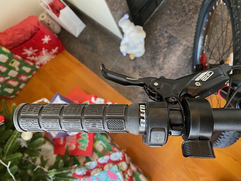

The brakes are SRAM G2 R - 200mm front and 180mm rear. They seem to be 2 finger levers although I may be wrong (used similar on dual-sports and dirt bikes), and nicely they have the tool-less adjustment for lever reach, although realistically this is something you play with for initial setup and then don't touch much until pads are well worn in most cases..
Overall quality seemed good - the frame feels pretty stout/beefy as does the rear suspension linkage. I'm a bit less sure on the paint - I think it's painted flat black, then Luna stickers applied, then clear-coated, but - not entirely sure..feels like it's somewhat easy to scratch but will see over time. The wheels were true if a bit on the heavy side, so aired them up for the time being to 26PSI F/R as they're tubed. A few loose spokes but nothing egregious. Checked derailleur but it was working well out of the box.
No manual, and some mystery stickers that are either for very lightweight frame protection (not thick or silicon/rubber, so definitely not for chainstay) or 'paint touchup'...or something. I used two of them to sit underneath my top tube/stem mount phone bag for now. They also include the component 'extras' e.g. a pair of bottomless tokens, etc. Charger looks to be the same as my Eunorau, and the battery is the same Reention style, just slightly longer than my pair of 14.5aH I have for the fat bike.

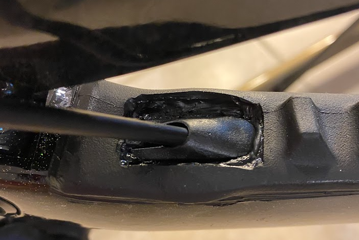

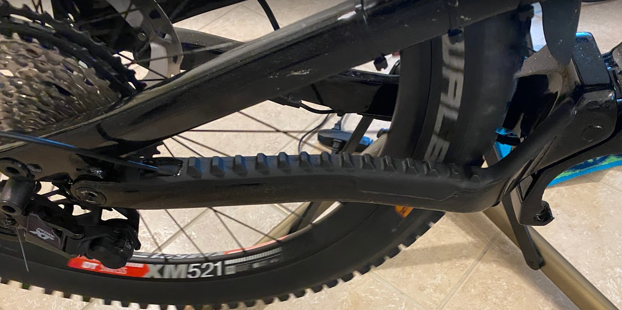

New install of a modified Nukeproof Mega Alloy 275 Chain Stay on the X2. I had to make a few cuts but it did fit well. The double sided tape included sticks well. I added a bead of RTV sealer around the edges to keep the water out. Not bad for $10 bucks.
