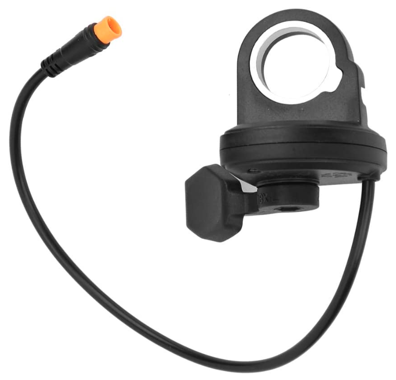

- Re-arranged controls and added a thumb-drive throttle @JRA found from someone in Poland. Much better than the OE one, although I had initially filed that one down to make it narrower/more usable with controls layout.
