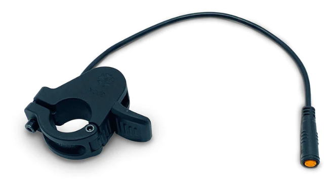

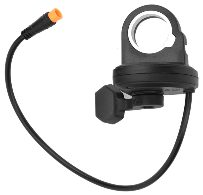

I ordered a new Bafang throttle. Looks a little slimmer over the stock throttle. Should be here next week. I'll let you know what I think.
Bafang Throttle
Appears to be a nice design change. Got rid of all my stock throttles (4 Ebikes) and installed thumb throttles.
Nice find. Looks like a definite improvement over the stock plastic one. I like the aluminum idea as that is what I use that I got from the gentleman in Poland that is even thinner, like half of that. But it did cost twice as much. Might get one to try just for kicks!
Bafang Throttle
This one doesn’t look bad. The one Tom posted comes in ‘left and right’ and at least for me, I found to take up too much width on the bars vs how I wanted my control placement - this one looks reasonable, although I’m running a skinnier one courtesy of @JRA
I got the Ebike Thumb Throttle BAFANG 300X and plugged it into the harness. Turned the bike on and it would not move the motor. Maybe the wiring or the design of the throttle. Went back to using the stock throttle which works. It does say BAFNAG1T4 cable is required for use.
I know this left thumb throttle works with X2 Ludicrous just talked to LUNA about it yesterday https://lunacycle.com/parts/bafang-parts/bbshd-parts/bafang-bbsxx-left-thumb-throttle/ Dunno if this is the 300x, but they said the bafang left thumb throttle and the 860C color display both work with my X2 Ludicrous V2 ordered 2 days ago. If you have the newest VESC firmware for the Ludi controller they should both work for you too. ( I went to school for Network & Electronic engineering the only parts about this bike I understand some =). Hope I helped you some. you have helped me & others a lot. If running stock BAFANG controller, the DPC18C w/Bluetooth, & Egg Rider V2 are both really nice color displays that work with the stock controller. Though I think I read your upgrading to Ludicrous controller. So maybe after you have Ludi controller with the newest firmware the throttle will work. I almost upgraded my display then I saw it cheaper to buy a refurbished phone for the VESC app, though after more important upgrades are made to X2 one day I may consider 860C. Is the thumb throttle on the link I provided the same as 300X?

Oh cool, I upgraded and ordered the Left facing Thumb Throttle from Bafang. My Dad had the stock one on his FLX & upgraded it to a slimmer 300x & it works no problem. I am still undecided on whether or not to buy the 860C display & replace the tiny one. My eyesight is good, but I would much rather the color display. I was told that MPH and all will display on the tiny display that comes with the X2 now. Current Firmware has come a long way from when the X2 was first released. Not sure if you were having issues not being able to see MPH or if that was someone else. I am happy I waited. Though tbh I wanted an APEX more than any other one originally. But I can't wait to see what you guys do next to your custom X2s both are really nice. I am hoping to upgrade the rotors, shifter, derailleur, & upgrade to tubeless rims, was considering 3" tires, what do you think about going up to 3"? I also wanted to make the bike ride better & smoother, but I don't understand Wheelhubs, & my father who is retired & lives with me now is too old at 83 to indulge me in all my customization plans for my X2. You said you changed your rims & wheel hubs so that they were "Symmetrical" if I remember correctly? Did you have to change the axel size & alter anything on the frame when you decided to change the wheel hub? Also, do I have to buy the rims, spokes, & wheel hubs separately? If I want a 27.5x 3" setup would you recommend that setup? Also, are there affordable existing pre-built kits with the HTZ I35 or the DT swiss ARC40? Both seem to get a lot of coverage & praise when I looked them up as upgrades for your EMTB E-bike after reading both your posts. Thanks to you guys I had an idea where to begin googling EMTB Rim brands. I really can't say enough how much I appreciate your & @rtp 's input. Without finding your guy's thread I may not have bought the X2, I was worried when I spoke with the sales guy, that upgrades wouldn't be easy & were highly frowned upon. So I'd be stuck never making it my own. But I think he assumed I knew nothing at all and I know enough after 2years of constant research into E-bikes. I just don't know much about rims, because it's one of the few areas I didn't research much. Same with HG Driver Verse XD vers Microspline, Ultraglide I think I covered them all? I don't know why they would run the Hyperglyde system which is Shimano right? But LUNA is running SRAM SX drivetrain with SHIMANO driver that seems backward, & I wondered why but can't find answers yet. I plan to ride a lot of offroad fire trails, & mountain biking courses, as well as some downhill enduro stuff. Want the bike to hold up to 6ft drops and small jumps? Love any and all advice you guys have to offer. Thanks again.

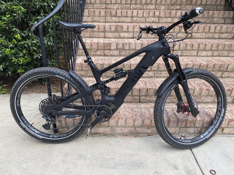

Photos of your ebike would be cool.
You care to post your ludicrous bike?

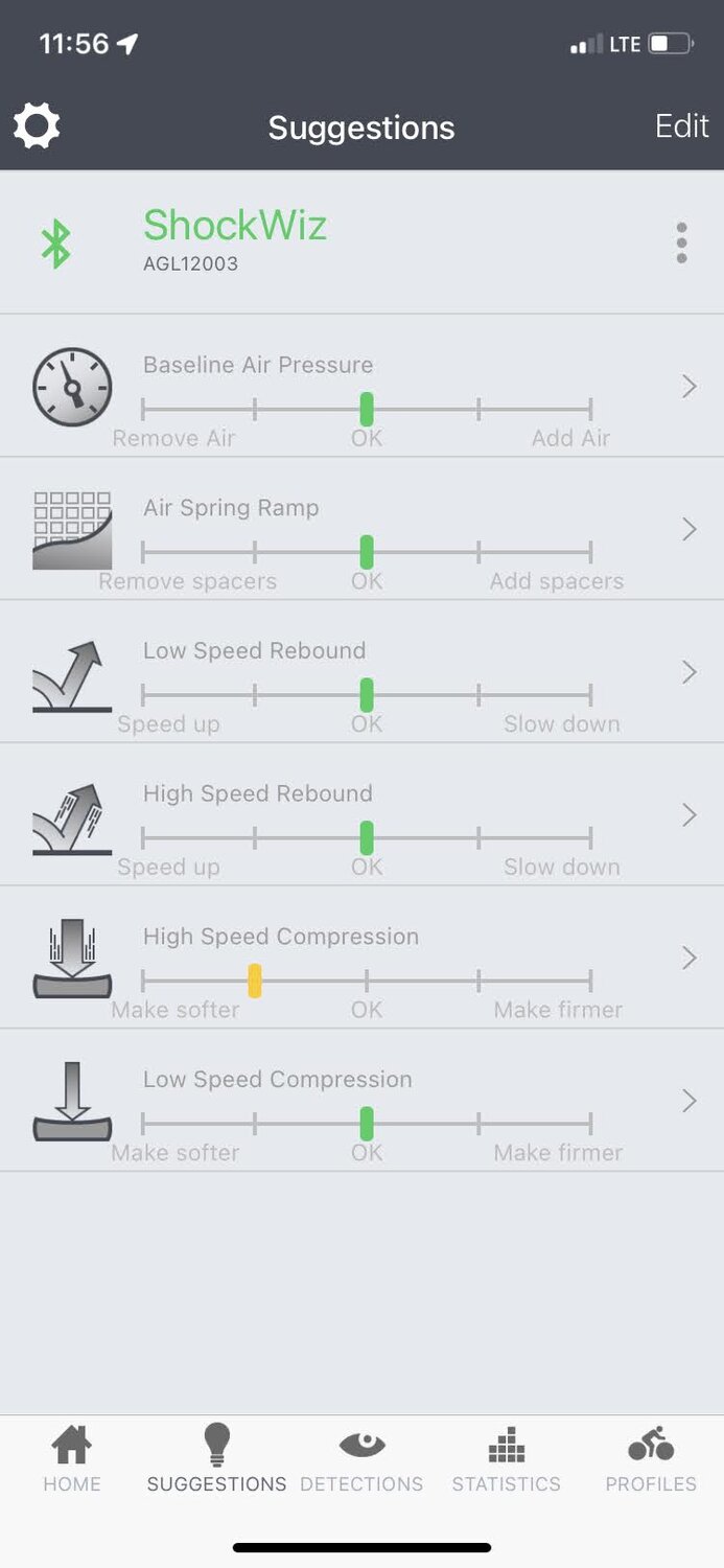

Purchased and installed ShockWiz on the Fox 38 160mm travel ebike rated fork. Went for a 10 mile ride yesterday and was happy with my base setup and the Shockwiz suggestions are below. I selected basic "Playful" tuning style and was very close to my base setup. Since I went with Fox 38 fork and Fox Float X shock I will be moving onto the rear shock next for that tuning setup.
Fox 38 160mm travel eBike fork
Rider Weight 210lbs
Fork Air 120psi
1 token installed
LSR 6
HSR 4
LSC 10
HSC 8 (full open)
Tire Pressure 21psi-F and 23psi-R

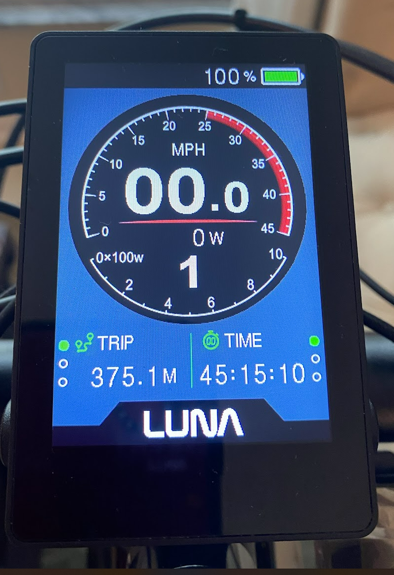

Did you upgrade to the 860C display? just curious cause I see your handlebars have a bigger display or is that your phone mount? if so does LUDI V2 Bluetooth work well and reach your phone on your handlebars?
Yes 860C display. Had to load latest VESC firmware to get 860c to work with v2 controller. No issues with Bluetooth to v2 connectivity. I have the IOS and Android phones. Need android to flash firmware. I got a $40 burner phone that I use to side load the Luna VESC app. No issues with handlebar to v2 controller connection while riding.

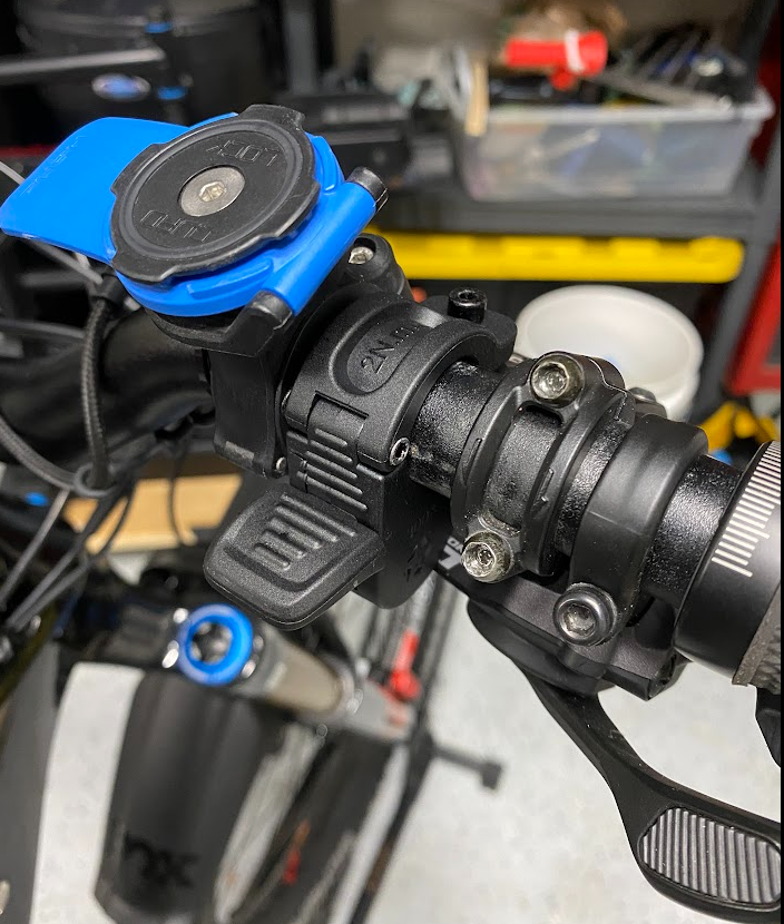

Another 300x throttle arrived and it does work! Big on the bottom so I had to work on the placement. Nice thing about this location is the phone hides the throttle.
Looks nice! How do u like it? I noticed your dropper seat post lever and thumb throttle are on the Right. I have it set up opposite on my pops FLX. I bought a WolfTooth Barcentric for my X2 to save space. Which should be here tomorrow or Friday I think. Been researching HUBS and finding such gorgeous hubs, but they are quite pricey. Found a few in this crazy purple/fuchsia color. Making me change the whole color accent plan. May go with a Red and Purple accent mix. I Like the HOPE, & Raceface, 350 Boost setup front & rear. I saw a 240setup as well, but don't fully understand, I thought the bigger hub meant it was more robust, more durable & was better for Offroad/downhill more tough riding. I was planning to use XD driver for a GX 12speed drivetrain conversion(seemed most economical. As well as the strongest & most durable 12speed setup by my research.) I considered going to Shimano 11speed, especially if I end up breaking these 12-speed lightweight hollow pin chains as we did on stock m600 on my dad's FLX F5. After 2 chains we switched to Connex chain & we never had another issue. (can't find a solid pin for a 12speed setup anywhere yet. Do you have any preference? I looked at so many Hubs I want a size 27.5"x 40 sized rim, but I am new to Building from scratch & not 100% sure I am doing everything right. Little nervous I will waste money on nice-looking gear that may not perform the way I want it. My dad's FLX I think has 240 Hubs on his boost setup. But it's just no name HUBS. Can you tell me a few brands that also have color and flair that I could look into? I also Need to figure out what 3" Enduro mountain capable tire I want to run. The plan is eventually to graduate from gravel & road to downhill enduro and track. So Smoother I can ride the better. I'm sick & needed to build my strength back up and after selling my Motorcycle in 2021 because I wasn't strong enough to ride it anymore. I figured the LUNA X2 Ludicrous would be a good fit for much-needed fun with speed/adrenaline & wind in my face I miss so much. Plus ya know the health perks too =). It's partly why I considered staying with the 12-speed to keep it simple, & if I have to peddle without power I won't be slain by all the steep hills around where i live. I wanted to change from HG driver to at least XD or better But looks like I'd at least have to swap rear Hub in order to do that. I want a strong base, & a drivetrain for taking her offroad & downhill. SRAM GX & Shimano DEORE 8100 are both nice middle-line drivetrains, I do like Shimano's shifter better. Anyway, your bike looks amazing. I will post mine once I get it & have it assembled. Going to be a slow customization process, cause I have so much to learn and read. Unless someone who knows mountain bikes helps me some. But where I live NJ everything is basically focused on Bosch-driven bikes. I want to order 160mm cranks but can't find any for the M600 anywhere yet. At least not reasonably priced anyway, or they are sold out. Most I come across are meant for the Bosch. Thanks again for help.

Can u take a photo of the display on for me, please? I've been dying to see what the display looks like connected to an X2? Hoping the contrast is better than it looks on their website advertisement.
