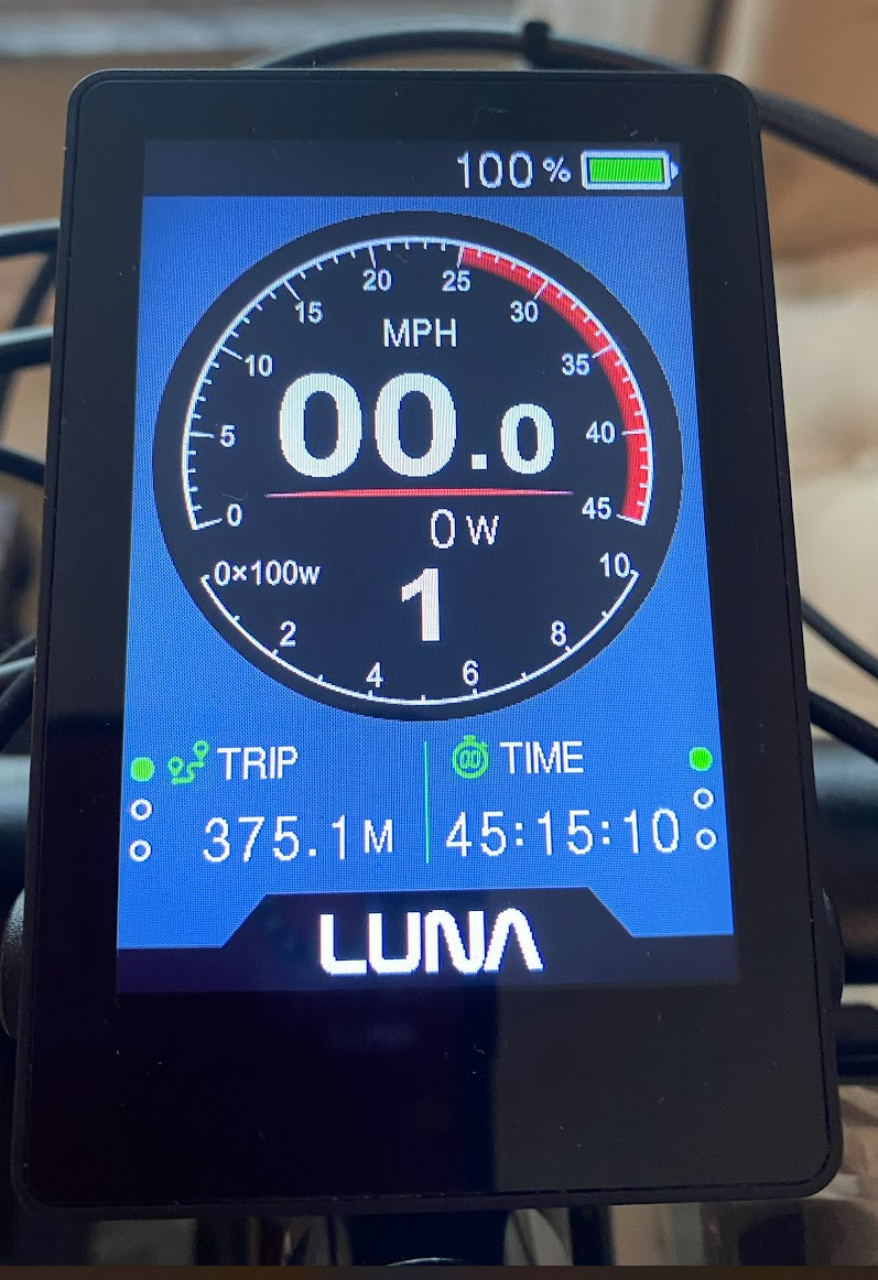

Color 860C is much easier to see on the brightest day. Worth the upgrade IMO.
I did find this video which supposedly Replaces the STOCK X2 ludicrous Display, the black and white TFT display seems to have a new update, it comes with optional cables depending on which engine you are running or the wire connection you need. I may order it and try it after I try a few others.

Depends - I've had a similar display on my BBHSD fat tire bike, and they're neat but I don't like the placement as it's problematic if you need to flip the bike upside down for maintenance, and in reality it's just not really needed. The OE display meanwhile is nicely tucked out of the way. I wouldn't mind one slightly larger, like a CAN version of the 500C. Meanwhile, some others love the 860c, so YMMV. I just don't spend a lot of time looking at it at all.
