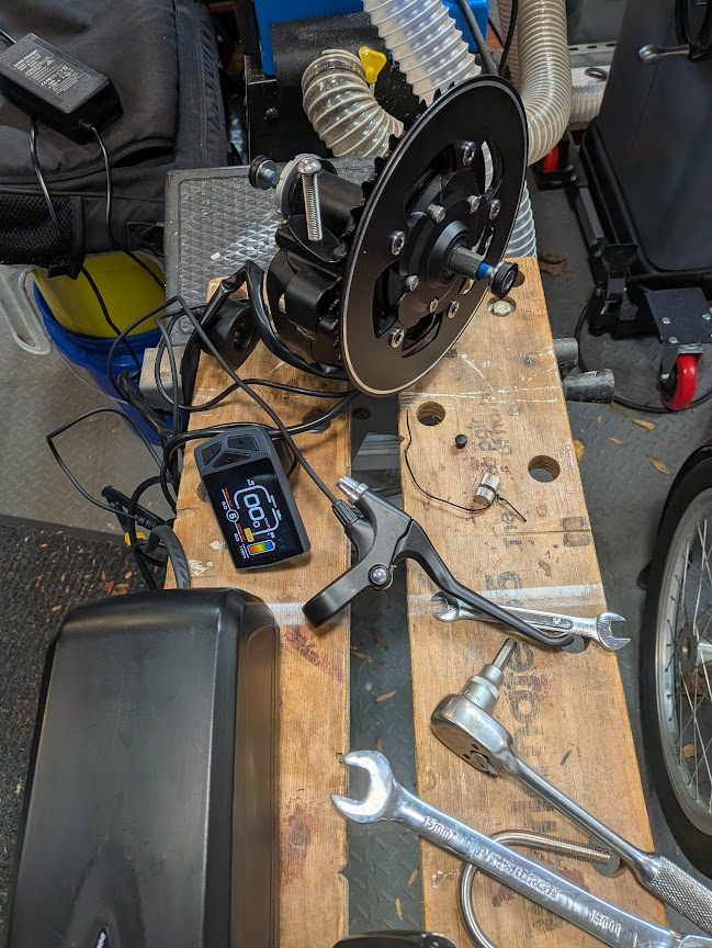

I've run a bafang with the factory programming and it tends to be very "Hot" even on the lower levels, so the ability to reprogram that particular motor is important. The other brands do not have that issue, if anything they tend to be fairly weak on the low levels.

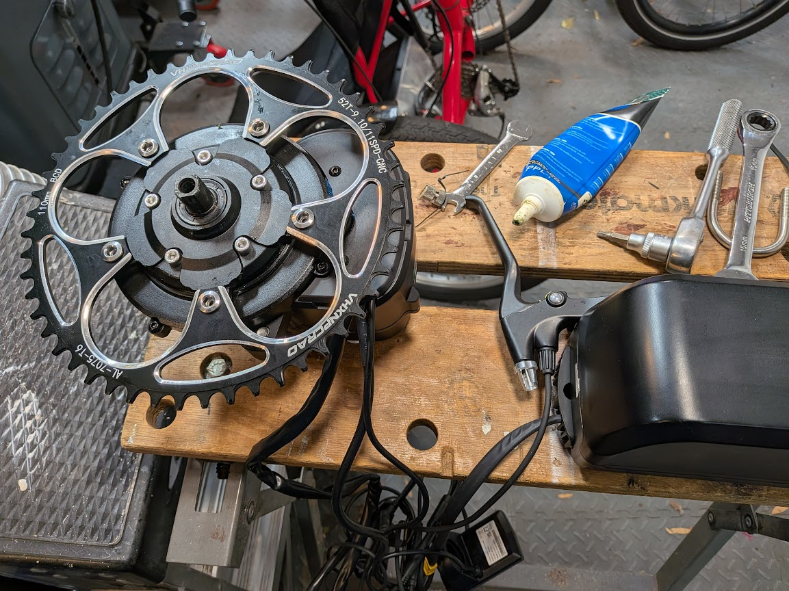

The DM02 comes with a very nice chainring that has the profile of a pie pan. It brings in the chainline. To better hit low gear. With 42 teeth on the ring to an 11-t rear cog and 28 inch tires top speed is 25 at a cadence of 80. I set the motor to cut out at a cadene of 110. At a cadence of 100 it will do about 32 mph. That is plenty for me. I have big hills so climbing is more important than top speed. The legal limit for eBikes in California is 28.

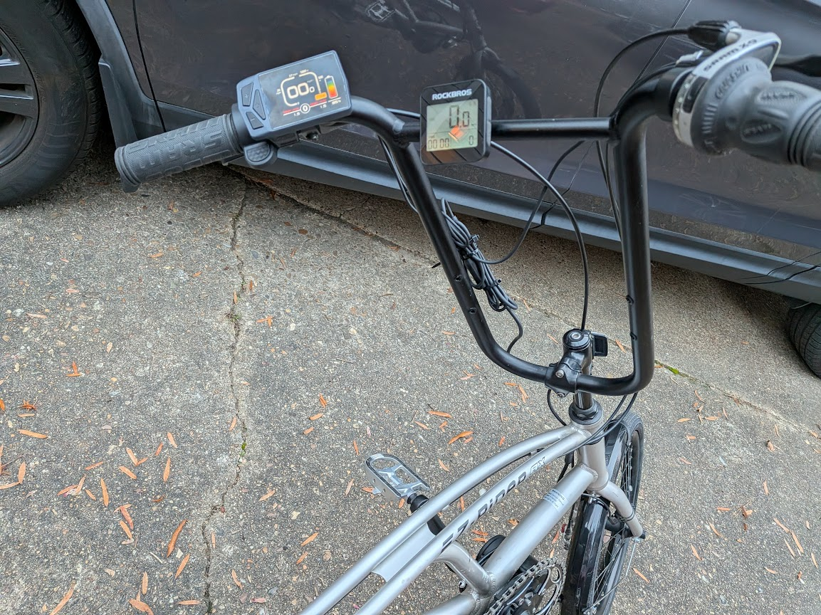

There's a lot more than just a better power delivery in the DM02 though, The T-24 display shows voltage, current, and watts. My engineer senses need that, None of that with the VLDC5 on the pswpower kit, although there are better color displays for the TSDZ2 that do that too,

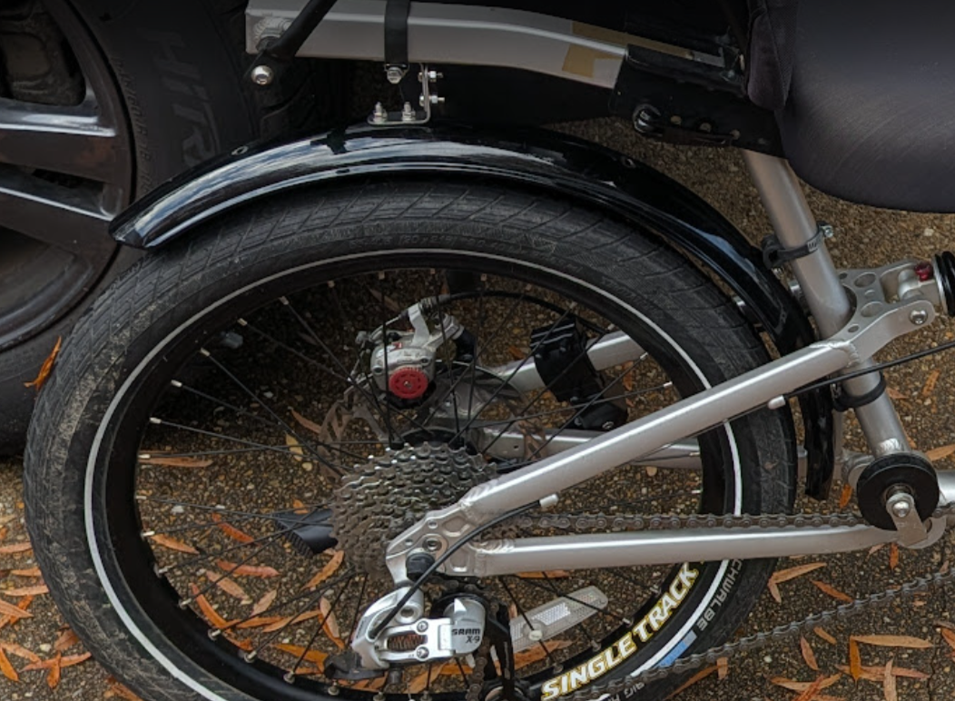

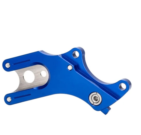

These clamp onto the frame. The axle provides some support. but it's up to the user to make a more permanent install.
What I do is cut a slot so the axle can slide in and out, and tie the blue part to the frame, with tapped holes. It's much like making a torque arm.
If one could weld, it's aluminum.
Instead of a weld on adapter I gave one of these a try. With a bit of modificiation it fit and seems like it'll do the job. Thanks for the heads-up.
