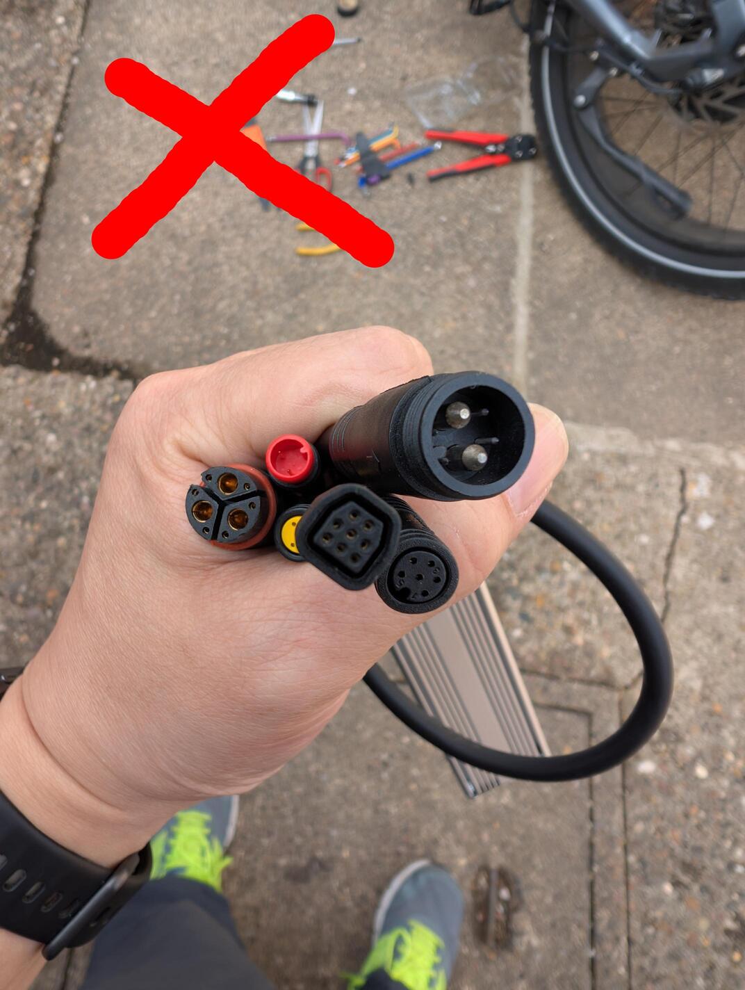

Anyway... I bought a controller from Ecomove (as reliable as Himiway)... and they sent me one but the connectors are different from my original one so doesn't fit. I emailed them... no reply. But then got another one through the post... BUT it was the same type with wrong connectors... now I have 2. It's now over 2 months since I bought first one... still no reply.
SO... I ordered one from Himiway Germany (niece lives there)... cost any arm and leg with custom charge.... and when it came.... guess what? YEP! It also had different connectors... same as one from Ecomove. I'm at a lost... as I now have 3 controllers with different connectors, down around £400 and a bike that works... but can't change the settings.

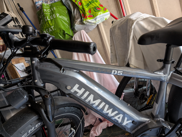

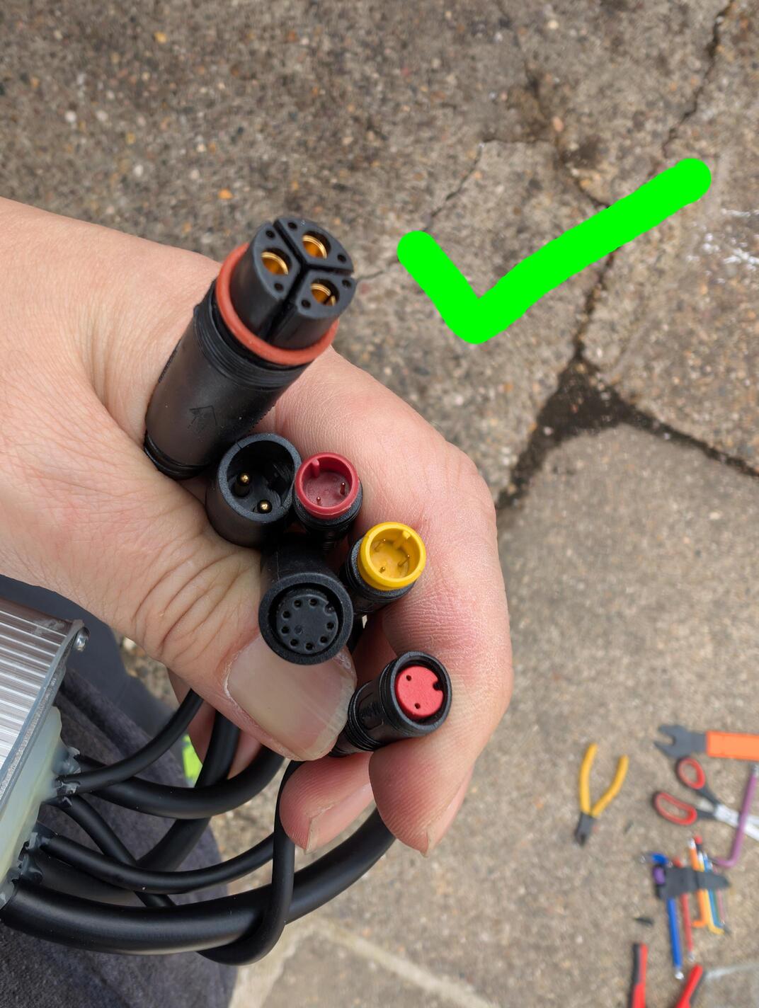

Thing is, I ordered the Zebra D5 controller because my bike has "D5" on the top bar (photo attached).... but is it really a D5 or just the older Zebra model? I've included photos of my old controller connectors (with green tick) and the ones I got posted (with the red cross).. anyone identify the connectors to the bike? Also anyone know the wiring diagram for the red cross controller --- maybe I can rewire with the old controller connectors?
