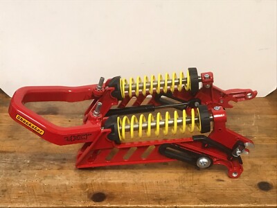

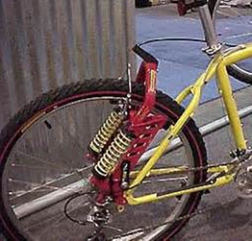

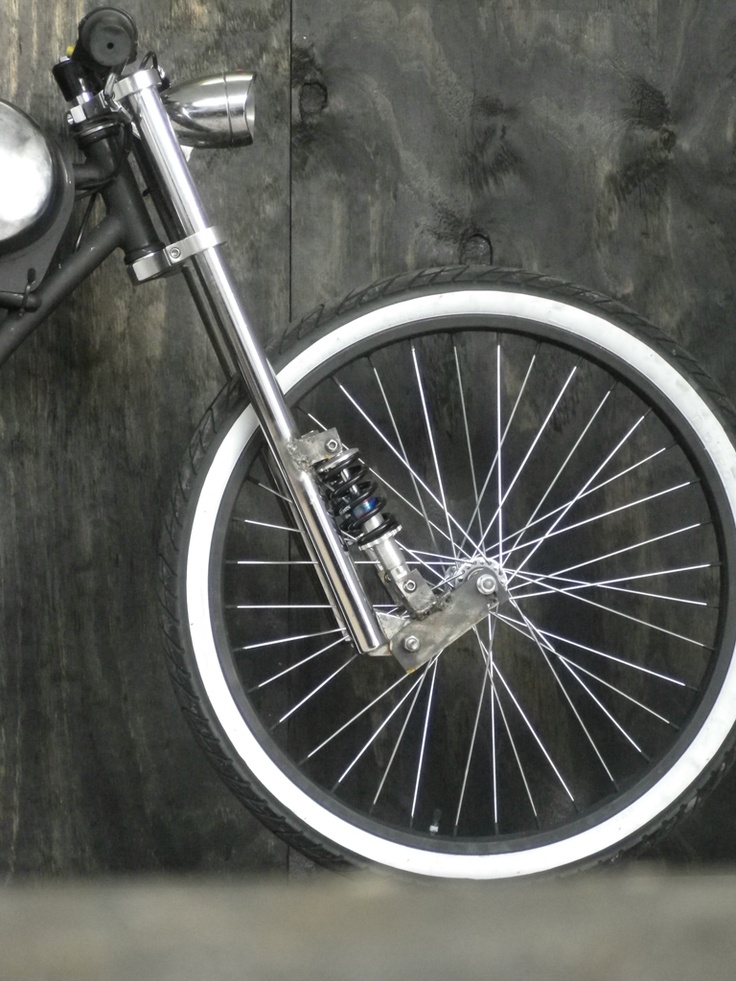

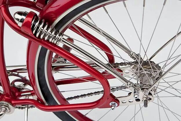

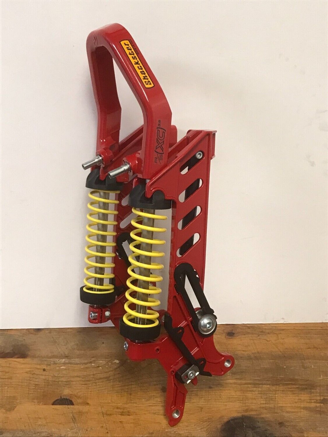

I wish they existed; pretty sure they don't, at least not in my price range. I'm actually trying to design a cheap kit that would add suspension to any hard tail bike. The easy part, designing the metal clamp that would attach to the rear frame with attached spring, or shock. The difficult part, accommodating the space needed for the rear wheel to lift and the frame to lower. Think bent springer fork. I'm sure smarter people than me could engineer this in 5 minutes. The idea is that the kit would be universal for any hard tail. Maybe I should start a Kickstarter?
Think this:
combined with this:
But something that only connects to the rear drop outs and not the rear seat or frame stays. There has to be a simple way to do it.

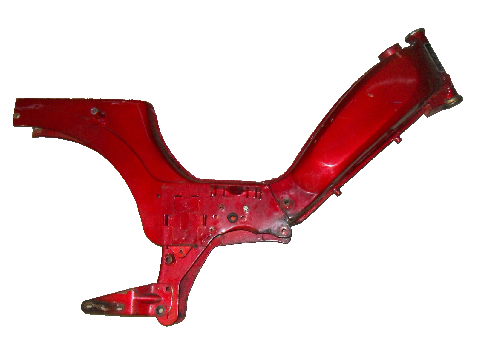

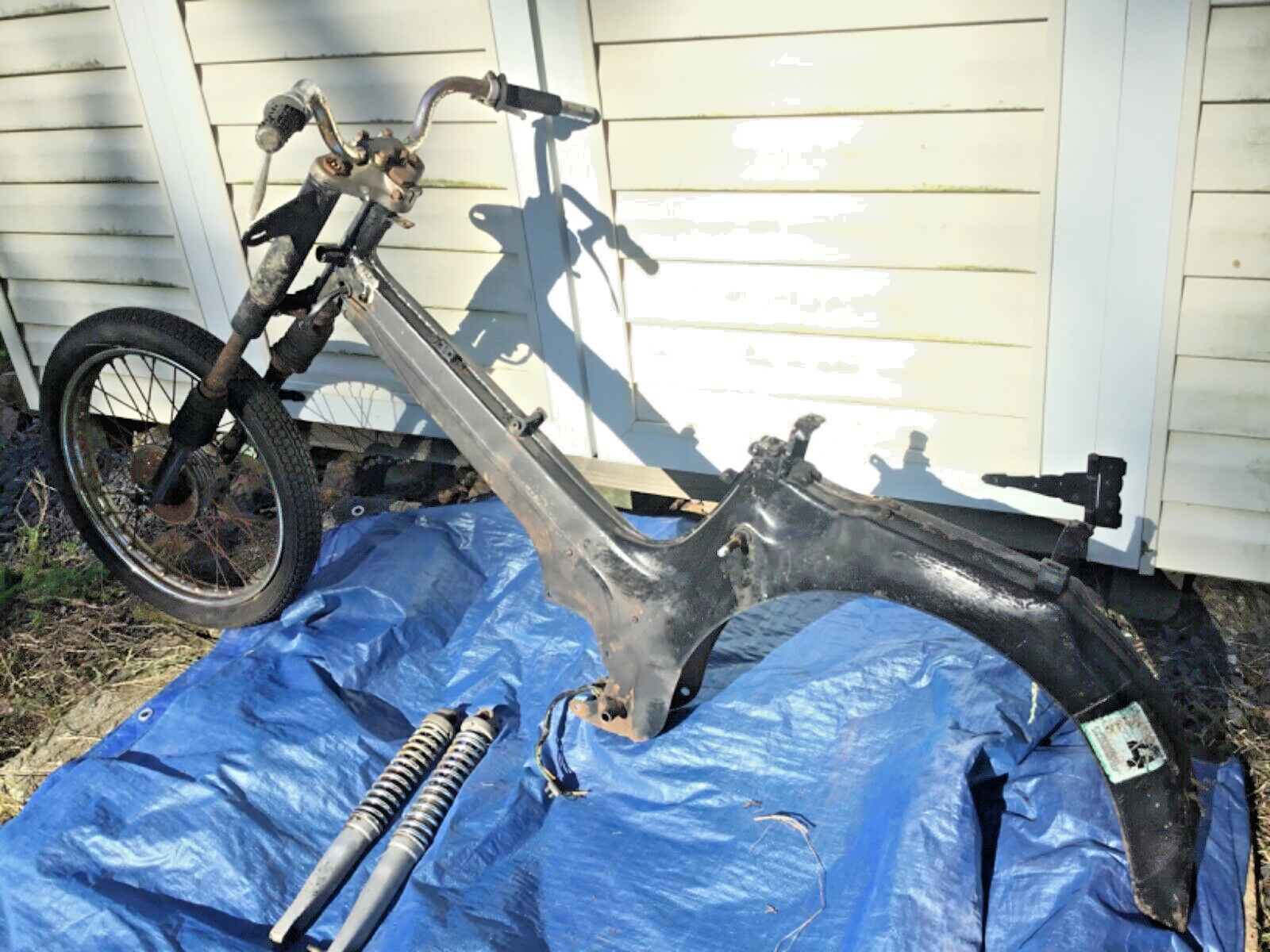

For now, if we want more than front suspension on a step through, we're relegated to suspension seat posts. There are many of those available. If I were doing my own build, I would start by buying the lightest vintage moped frame I could with rear suspension and go from there. Again, not a financial possibility for me:

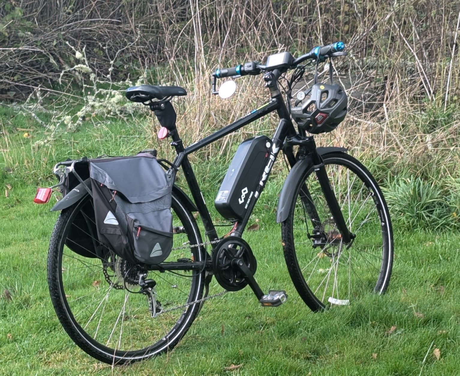

I put a mid-drive (BBSO2) on this Trek 7.2. It's a 30+mph ebike and I quickly learned the need of front suspension, so I installed a suspension fork (Rockshox Paragon). And once you have front suspension you'll feel the need of rear suspension. So I installed a Suntour suspension seat post.
She's a beauty. Yeah I remember a while back when I still rode a motorcycle. The guys I knew were in their mid 30's were all geeked out to get hard tail Harley sportsters. Without exception, as soon as they could, they all traded in for full suspension models. Once you go suspension, if you can afford it, you don't go back. It will be new forks and seat suspension for me before summer.
