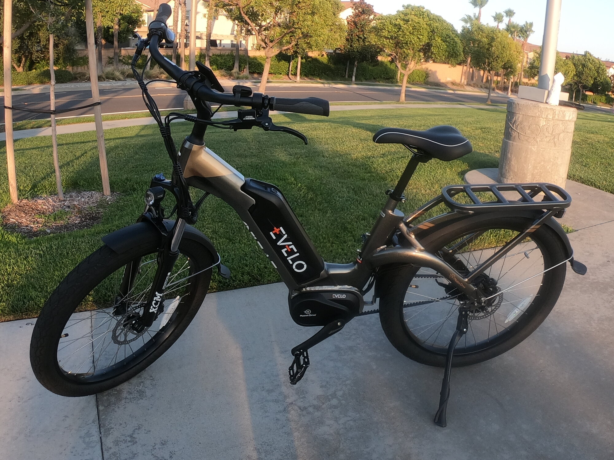

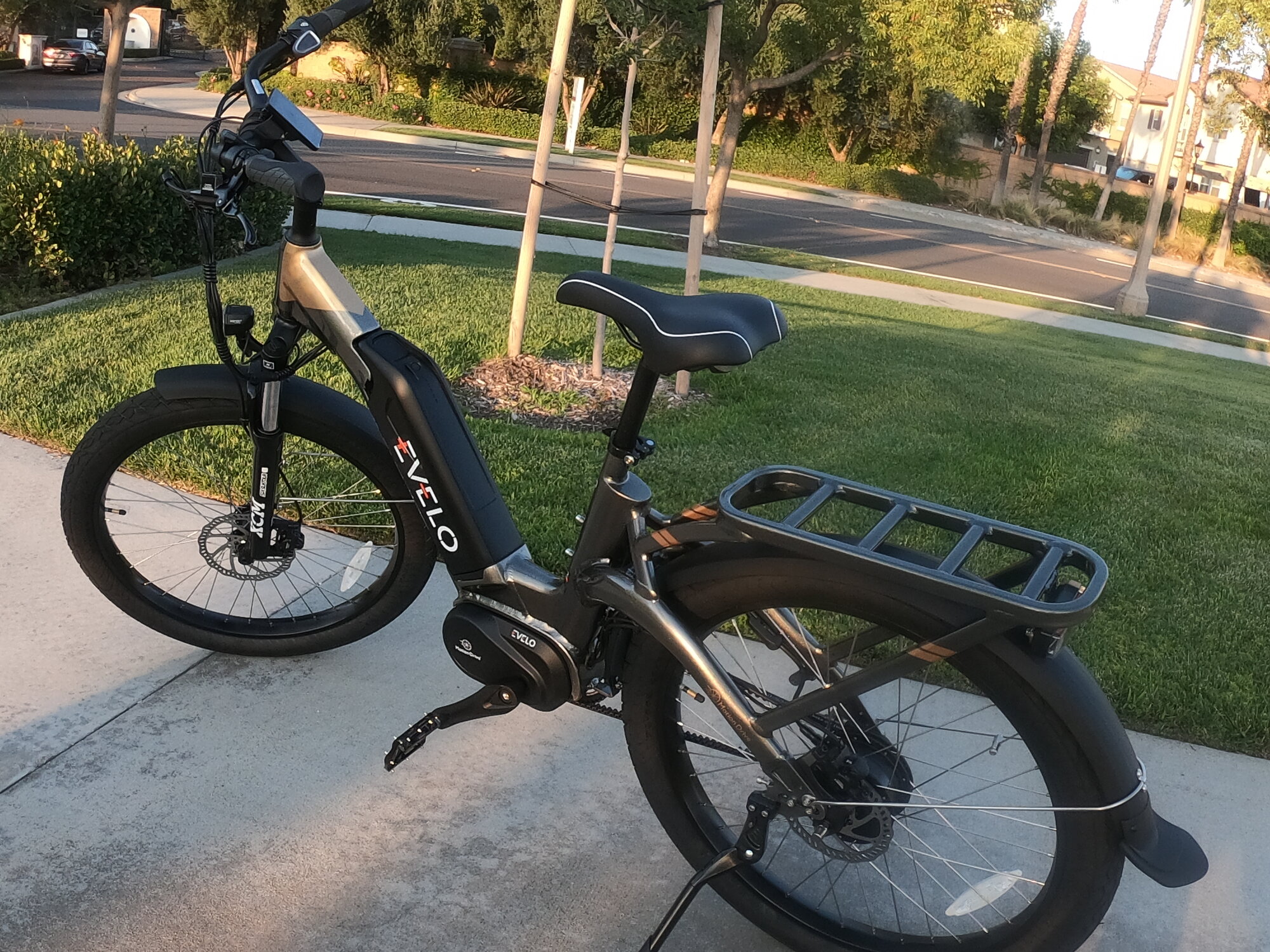

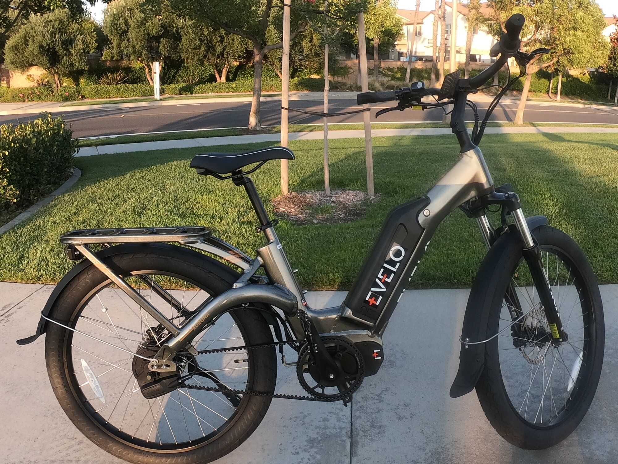

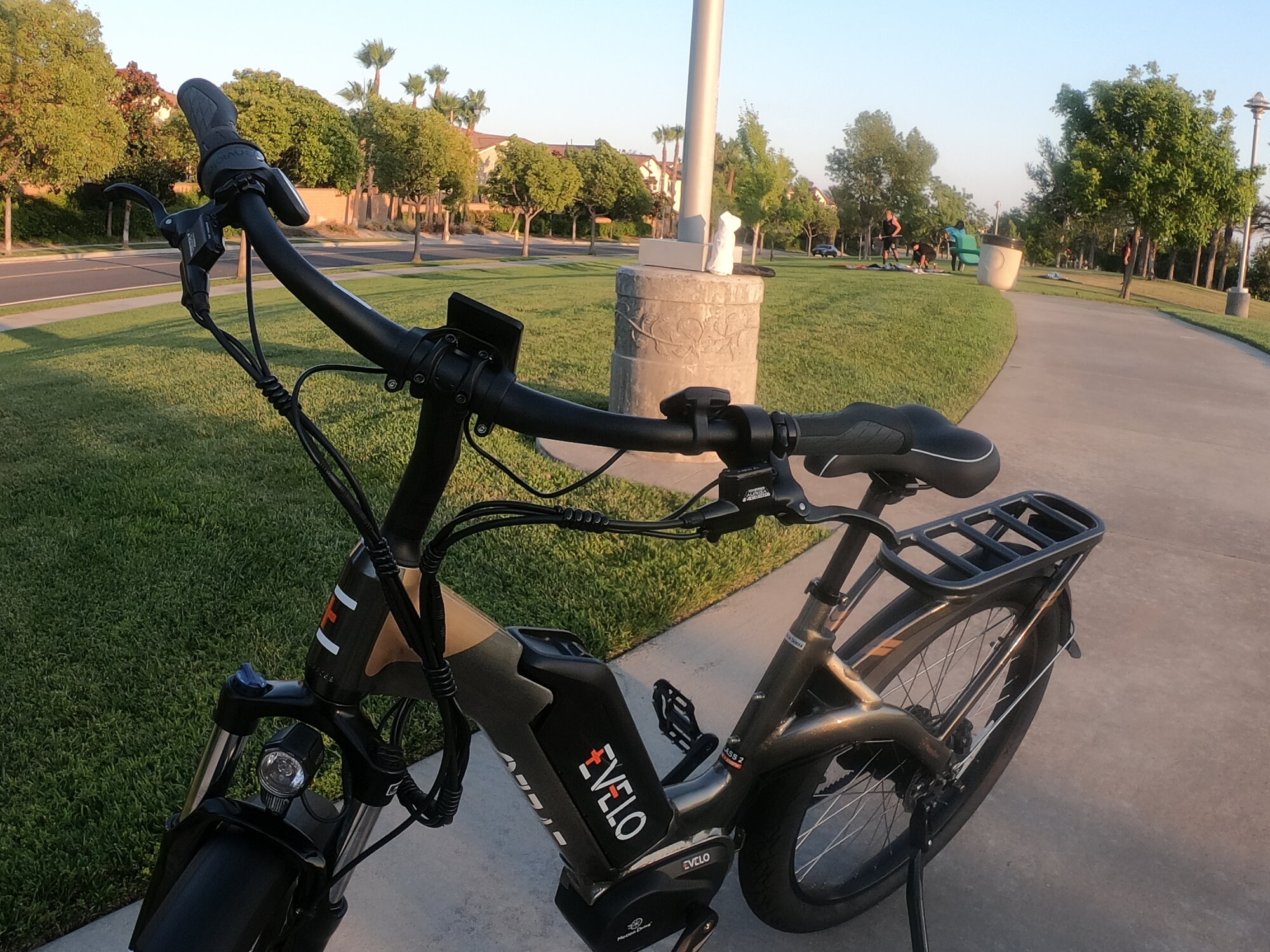

2020 ALE
It appears he barely received it Friday it looks like and got it assembled and took pictures. He needs a day or two to ride it lol !!! But I also will be anxious to see his review.
Mine is coming in October. Looking for all the user experience I can gather!
