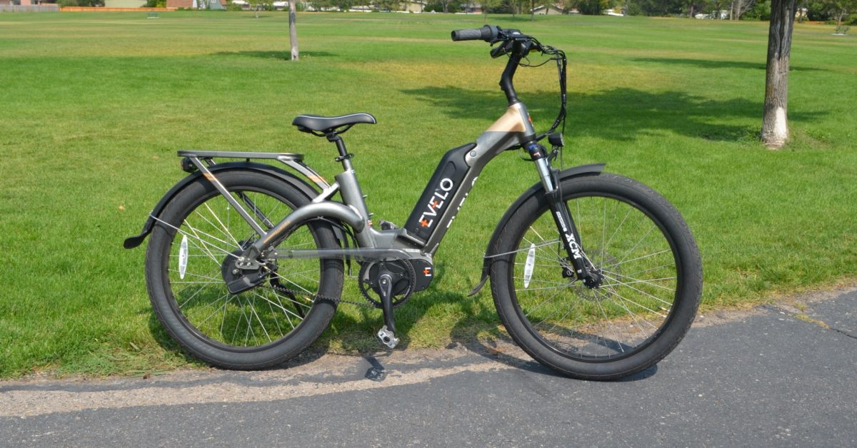

Here is a recent review from Electrek... ;)
Evelo has cracked the code to smooth, effortless pedaling. It’s added a host of creature comforts that make this bike only a couple steps away from being the most comfortable bike in the known universe. OK, that might be a bit over the top… As far as pedaling smoothness goes, the Aurora Limited (in my opinion) beats out Riese and Müller, makers of some of the highest-end and most expensive commuter e-bikes available in America. Riese and Müller bikes hold price tags around $5,000 – $8,000, and for less than half that, you can waltz into the Aurora Limited. How did they do it?
  • Motor: Evelo Motion Drive 750w Mid-Drive
  • Battery: 48V 14Ah (672wh)
  • Range: 20-40 miles (32-64km)
  • Gearing: Enviolo Automatic Geared Hub
  • Frame: Aluminum
  • Brakes: 180mm Tektro hydraulic disc brakes
  • Tires: 26 × 2.8 Innova
  • Price: $3,999 (periodic sales occur)
  • Extras: Gates carbon belt drive, front suspension, throttle, automatic headlights, brake lights, welded rear rack, step-through frame, wide fenders, Star Gazer stem
