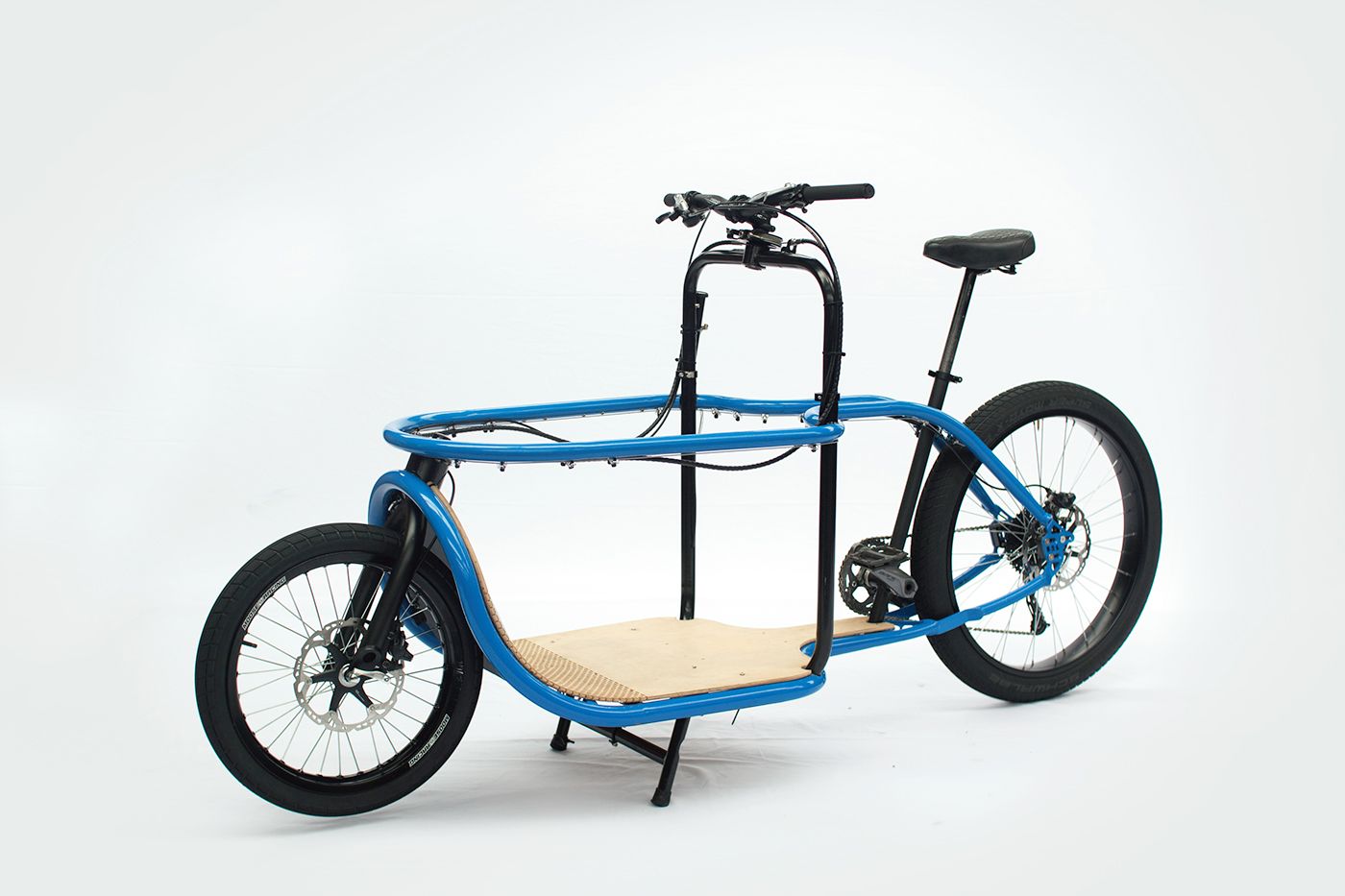

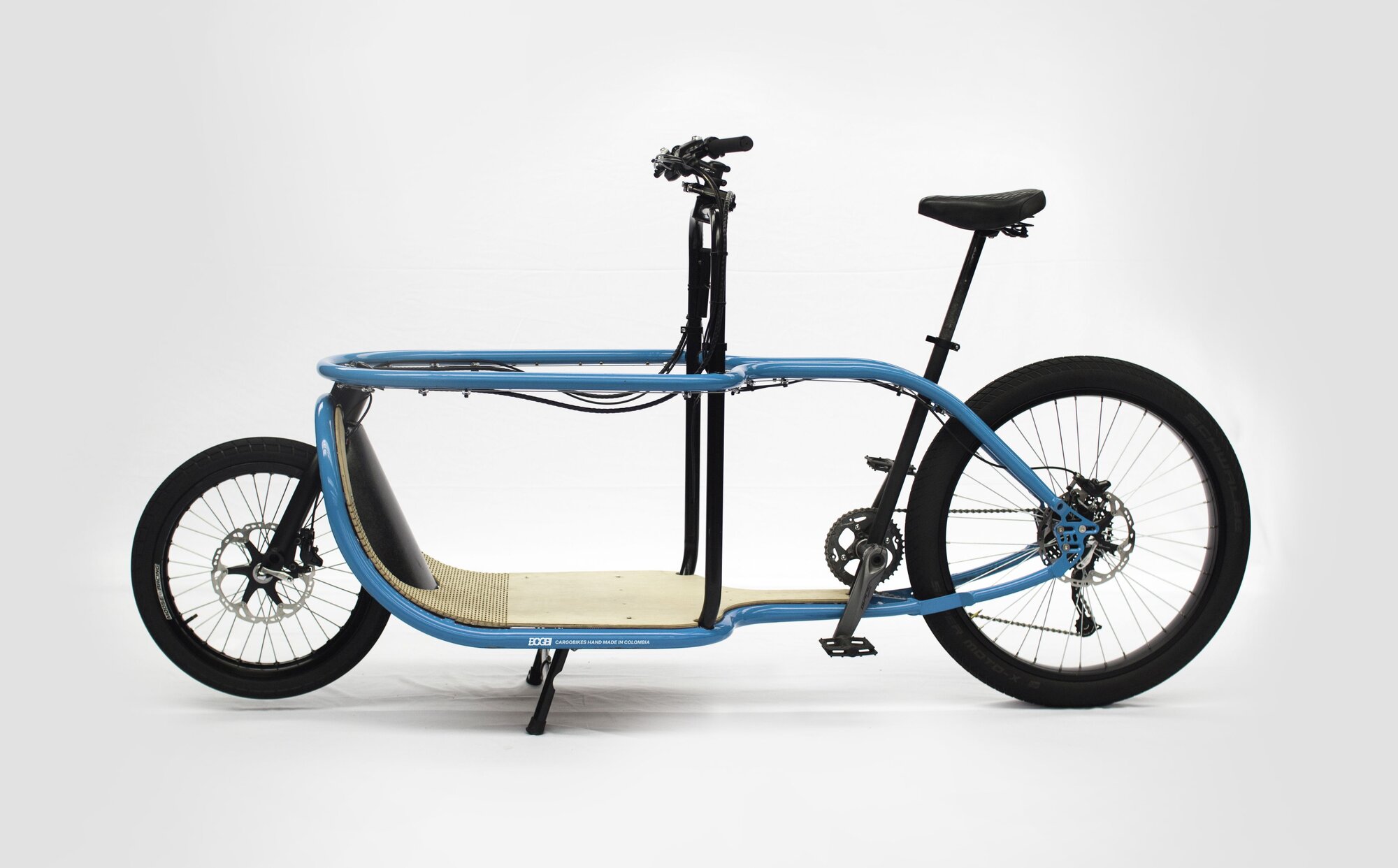

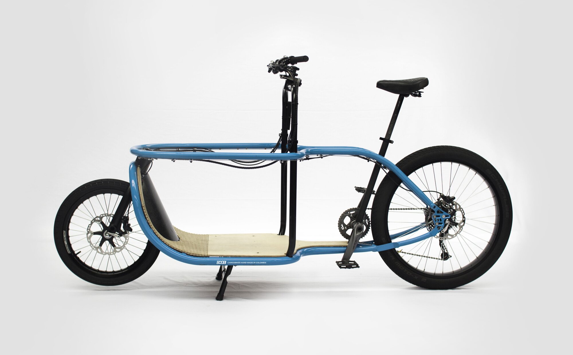

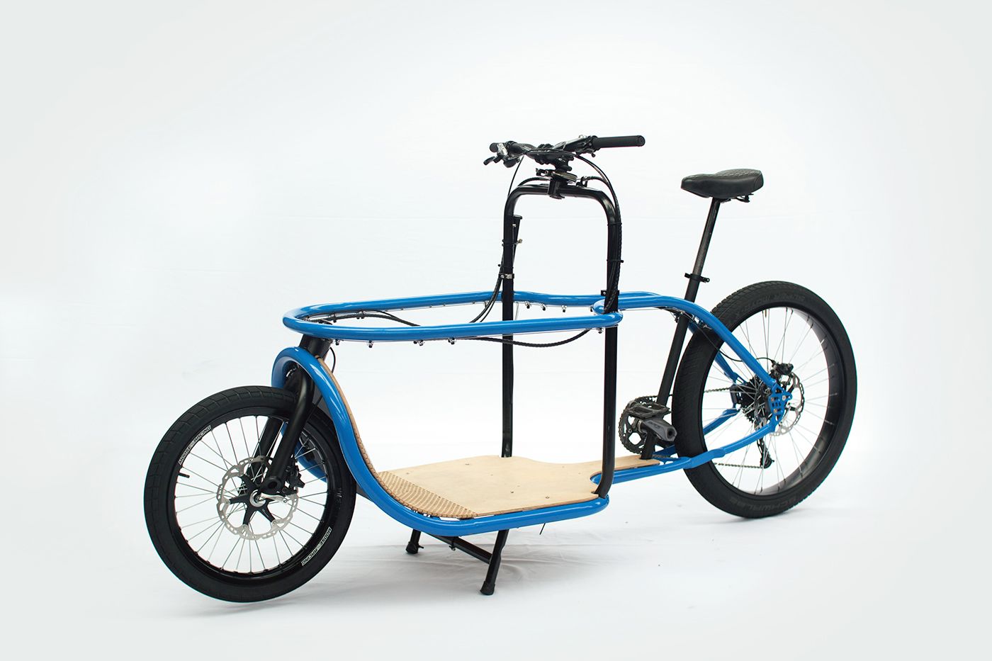

Do you think the motor would fit fit on a bogbi cargo bike (vertical seat tube) like this ?
Would the 250W kit (EU legal) be strong enough for a 35kg bike + 80kg cyclist + 20kg kid ? :)

View attachment 53544View attachment 53545
Hi Nessos, I apologize for the late feedback, I overlooked the notification. I think that the in-frame mount is the best solution for your cargo ( see it attached). You can print in 1:1 scale the attached drawings ( you can verify that by the scale on the printed drawings) and check whether it fits into the frame.
