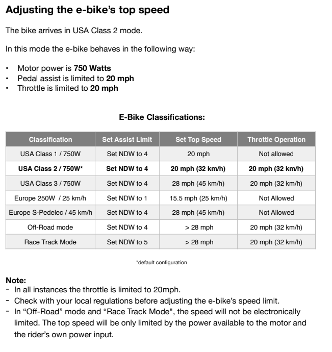

Have you checked to make sure the speed limiter is set above 20mph??? Depending on location bikes can be shipped in a "class 2" configuration with speed limit set at 20 mph.
What is the NDW set to? If it was set to 1, it would describe your problem.

NDW is set to 5. I'm thinking it's the spacing between cadence sensor and the smallest cog.

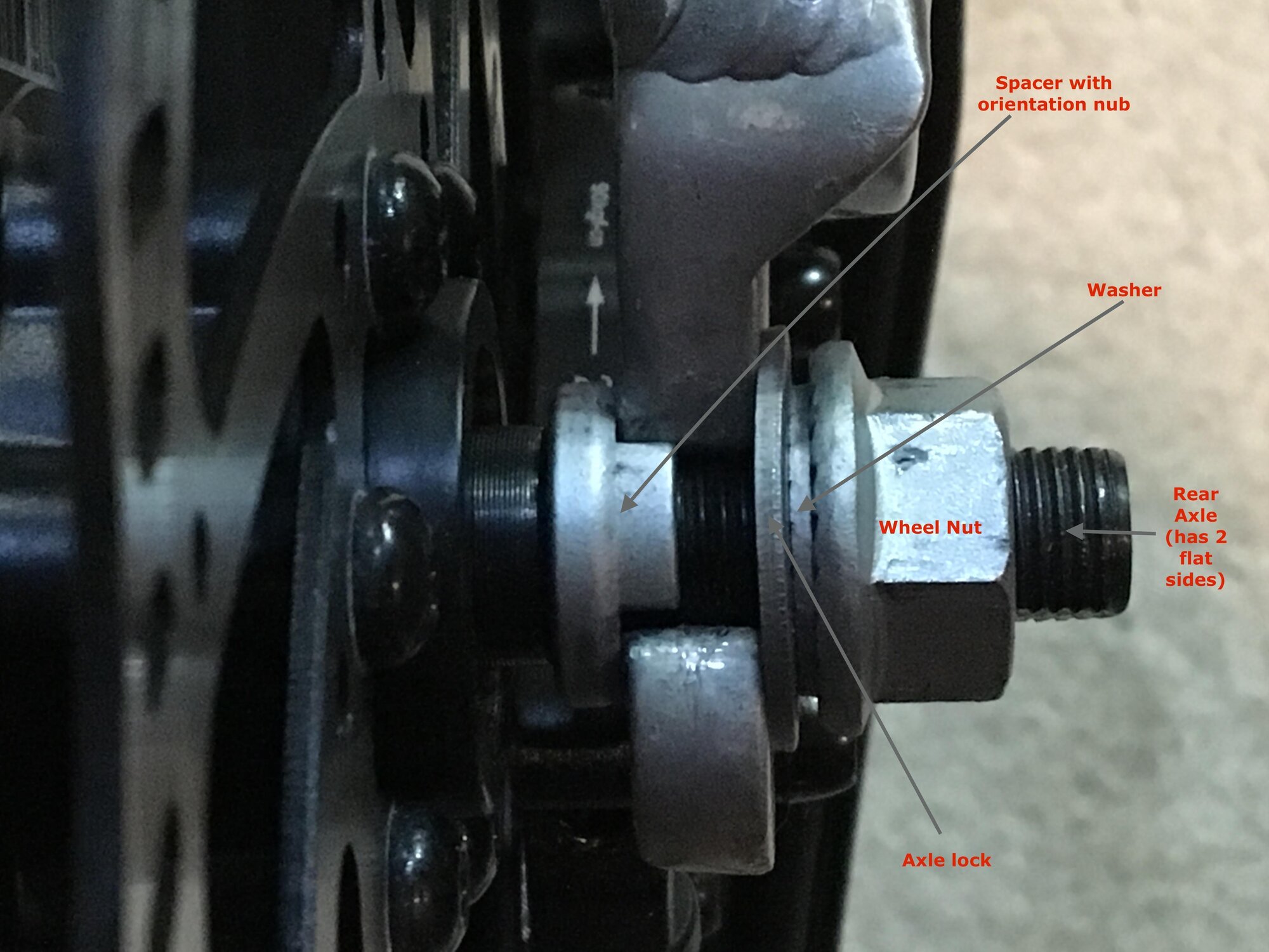

How did you get this fixed? I think I might have the same problem. I've been underwhelmed with performance and I can easily fit a nickel between the cadence sensor and the smallest cog, I just just dont know how to move to closer

There is a proper way To put the rear wheel on with the spacers and washers, which one done correctly make the space the right distance between the TS and the smallest cog. I’m outside walking my dog right now, but when I get back in I’ll see if I can bring up the picture I made of the correct way to put the rear wheel on so you can see if yours is the same

Ok, the clearest pic I have of the correct orientation of the rear axle hardware is of the brake rotor side. It's exacly the opposite for the cog side (less the axle lock, which is only on the rotor side).
For installing the rear wheel...
-First, install both spacers with orientation nubs facing out onto both sides of the axle as pictured.
-Install the rear axle with its flats correctly positioned in the rear dropouts (you can use a 10mm wrench to turn the axle if needed into the dropouts)
-Next, (cog side only) install a flat washer on the axle to the outside of the dropout. Rotor side- install the axle lock, then the flat washer. Do not tighten the axle lock's allen head til the rear axle is on completely.
-Install both rear axle nuts and torque to spec.
- Lastly, install both rubber axle protectors.
