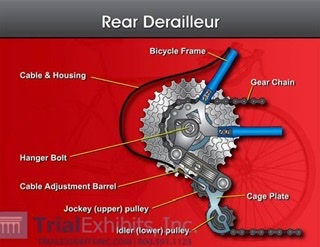

I've had some issues with my chain falling off the chainring and getting stuck between the teeth and the outer plate. I think I need to increase the tension in my chain but I'm not sure how to do this. Any tips?
Hello,
When i first got my rip current last month the chain was skipping gears and getting stuck. I checked my derailuer and it was angled just a bit to cause the problem. The first thing i did was make an adjustment to the derailuer. Its very simple there is an adjustment barrel knob on the deraileur.
Looking from the back of the derailuer your upper and lower pulley should be in line with the the sprocket your chain is on. Turn the barrel knob until it is lined up. This is a fine adjustment so it may only take a few full turns or less . Once you line it up have someone shift all the gears while you watch where the chain falls. It may take a couple adjustments but it corrected mine and ot shift perfectly.You could also watch Park tools derailuer adjustments . Hope this is helpful.
Hello,
I'm about to write my 1000Km review of my RCS and I will talk about a similar problem. I believe yours is the same problem. The derailleur has what is known as the 'B' screw, or Tension screw. However on my bike there is an installation issue as this adjustment has almost no effect it does not even engage the derailleur except at it's tightest position. I believe this is a installation issue with the Stop washer not correctly positioned, but I would have to take it apart to confirm invalid placement or incorrect parts. In any case this adjustment effectively does not work in my case, you can see it is totally ineffective, it is one of the bigger quality control problems I've had on my bike.
Luckily for me I could get a position that worked, being able to just have the stop engage the derailleur at the right point, I had about 1mm to play with and luckily that was enough.
At the setting it came adjusted at it had absolutely no affect on the derailleur what so ever, yet the screw had lok-tite on it. Basically, this adjustment was never done or checked at the factory. :(

Hello,
