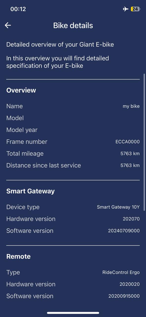

Hi! How to remove servising message on my Explore e+2 GTS, the last time I reset myself last 2000km, but I don't remember through which program, through RideControl somehow it doesn't work.
I think this is a dealer only function but correct me if I'm wrong. Mine goes away if I ignore it long enough, it's just a suggestion after all.
If it's triggering an OCD episode take it to the dealer and get them to extend the duration before it appears.
I remembered, distance since last service reset when i updated my RideControl Charge display with RideControl app, but now it doesn't work.
I think it is possible to do factory reset RideControl Charge display, then update to latest version, who will tell how it can be done

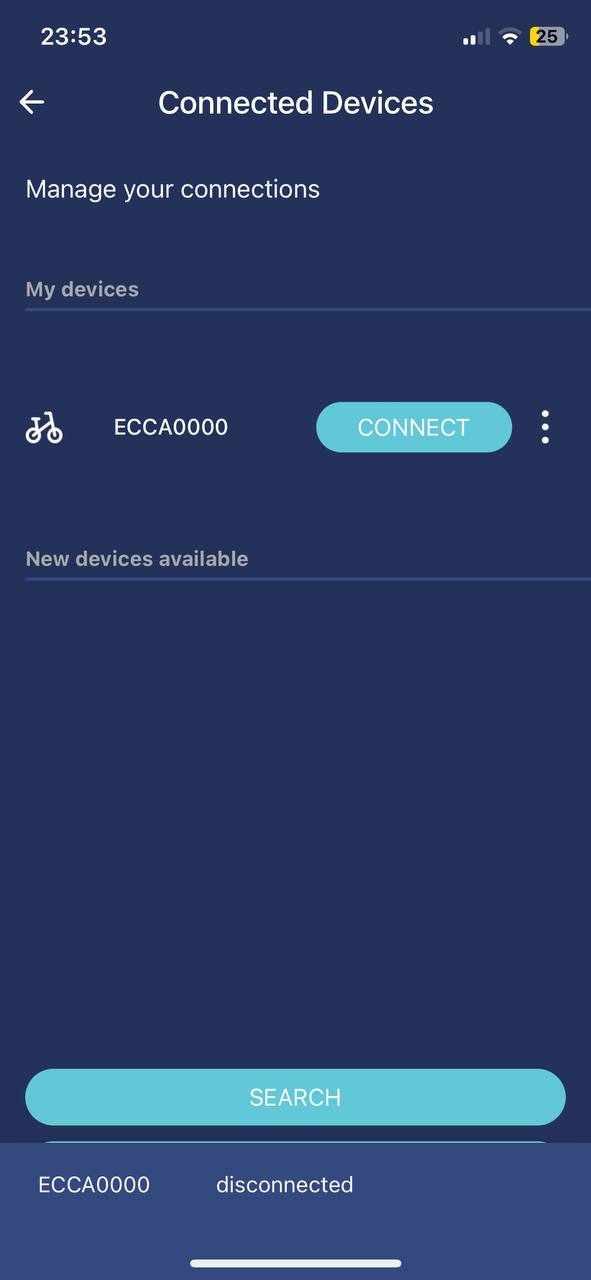

I have not yet updated the firmware of the bike (phone in flight mode, just connect to bike).
After turning on the bike, an error flashes on the controller. The controller cannot be turned off unless the battery is removed, or it will turn off itself after 10..15 minutes. It also does not respond to pressing any buttons. And the assistant (motor) does not turn on.

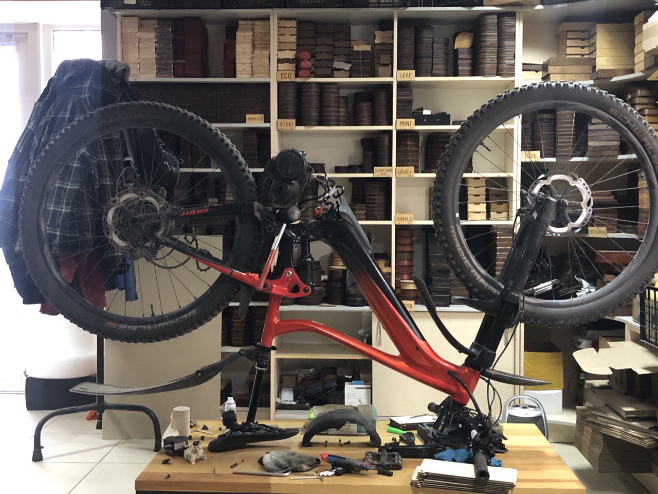

A couple of days ago I removed the engine, trying to find out if there was moisture on the wires. I reconnected all the wires, checked all the connections.
Probably in the near future I will ring all the wiring with a multimeter for breaks and non-contacts.
If it does not help, then I will try to update the software through the application.

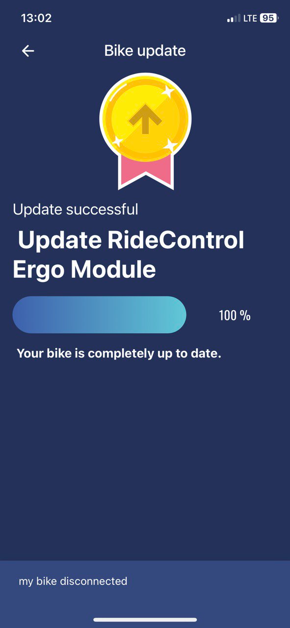

Today I risked updating the system. The error disappeared after updating through the Giant application. This is the best New Year's gift for me)))
It is noteworthy that the update was launched the first time for 30 seconds, after which ride control turned off. I turned on the bike again and entered the application again, the message that it will update again appeared. After three minutes of the second firmware, the bike turned off again, and after I turned it on, there were no more errors.

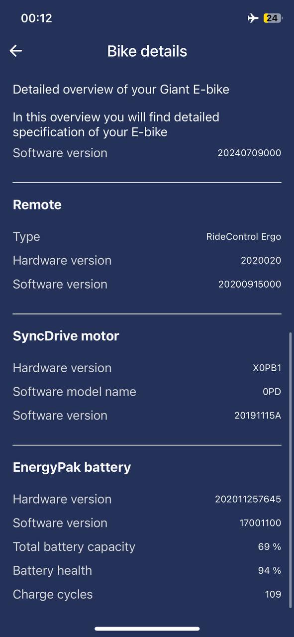

I bought a used 2021 Giant Revolt E+ (500wh), done 2800kms and 94% battery health. Awesome bike but it does significantly less distance on a full charge than the distance estimator on the screen. For example, in eco mode the estimated distance said 140km on full charge, I did a 28km ride with 490m elevation and the battery was at 28% when I got back, 90% of the ride was on eco mode. Is this normal? The speedo also reads about 2km/h faster than GPS. Interested to hear thoughts, I think I might need to get a range extender.
The range estimator tells you a fairy tale. I think your battery is severely degraded.
This depends on the tyre size and is an expected discrepancy.
I was told by a few people that 94% battery health was fine. Guess I was told lies. Anyone use Energypak range extenders?
When I owned a Giant Trance E+ 2 Pro with a new 500 Wh battery, one of my first rides was 50 km with 648 m elevation, and I still returned on the battery. Gives a perspective, as I had to use higher assistance modes at times.
What is eco set to? At the default 100% assistance I get 32ish miles (50km) out of the 375whr battery on my revolt. 1600 ft of climbing over 17 miles is a good amount of elev but id still expect more. If you’re heavier expect elevation to really kill range though.
id also check that everything is rolling smooth. Brakes aren’t dragging etc.
