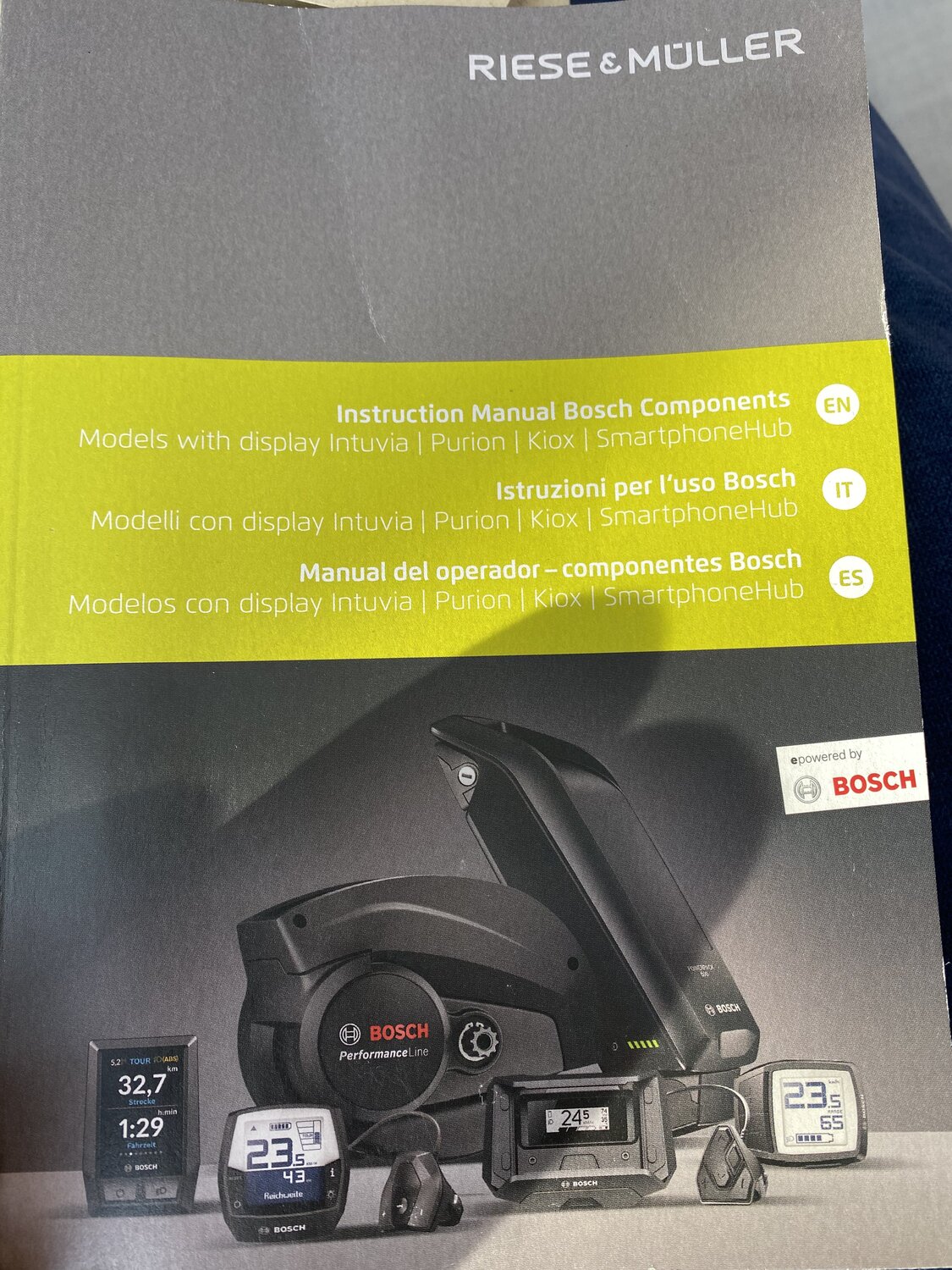

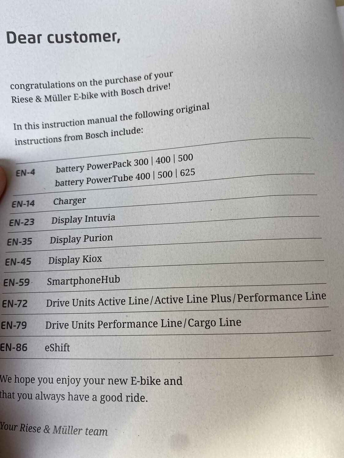

I see on double checking the manual there is no mention at all of Kiox 300 or Smart System so it appears I got an “old” manual:
That's because the new manual hasn't been printed yet - perks of being on the bleeding-edge of eBike ownership 😆
You can find the PDFs here.

I work at an R&M dealership - none of the Smart system bikes ship with updated printed manuals, because, as mentioned, they haven't been printed yet.
