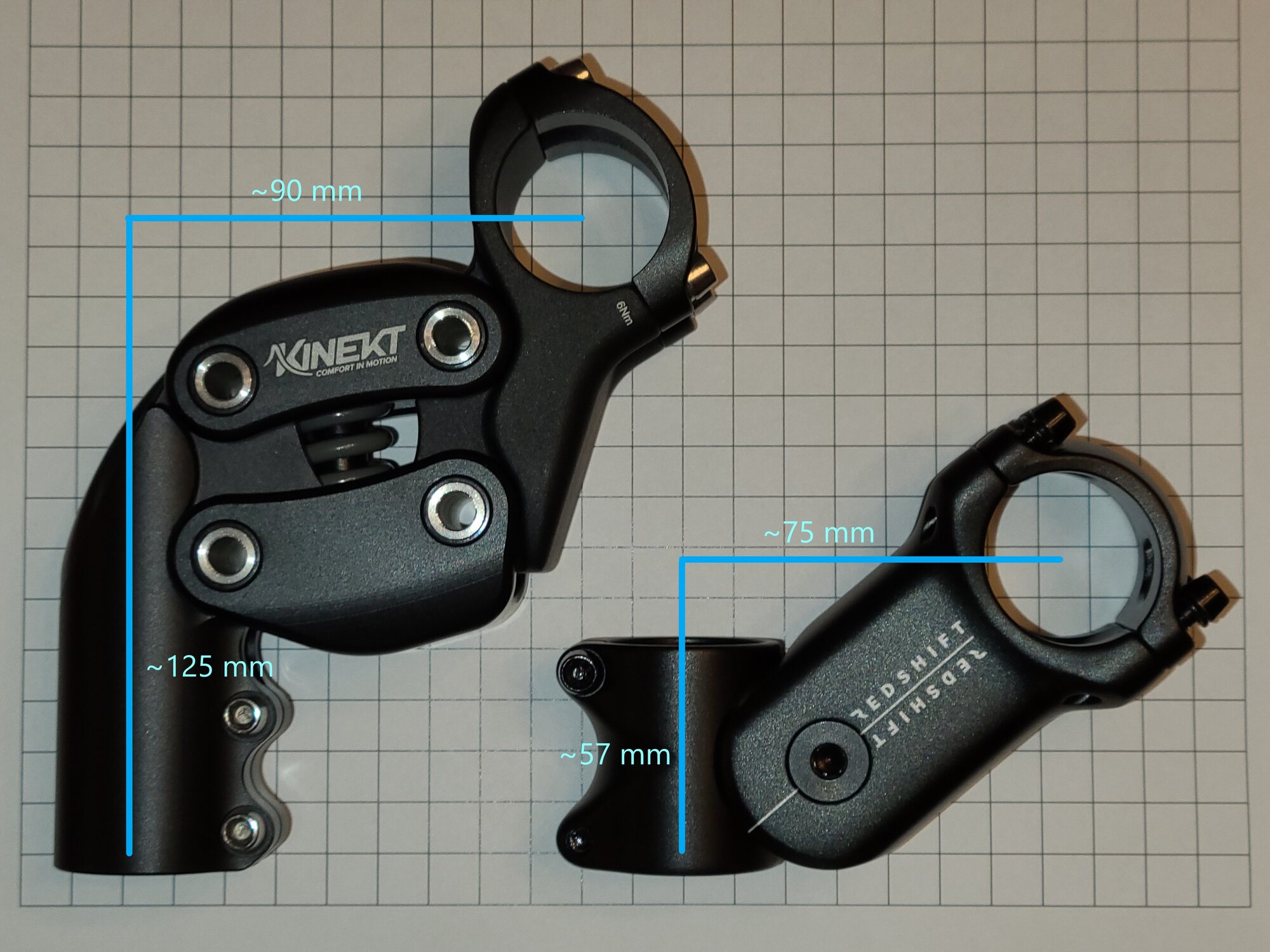

I wanted to compare the new Kinekt 50° Comfort Stem to the Redshift 30° ShockStop Suspension Stem. I had already purchased the Redshift stem when I found out about the new Kinekt stem. After feeling the benefit of the Redshift stem on my Pedego Avenue, I wanted to check out the Kinekt for my Wife's Avenue. Since I didn't find any comparisons online, I decided to bite the bullet and order one. Below is a side-by-side comparison on centimeter grid paper. Due to the camera perspective, the Kinekt doesn't look like it is lined up on a line so I drew lines to show the vertical dimension measured from the bottom of the steering tube clamp and to the center of the handlebar clamp.
I haven't ridden with the Kinekt yet because I have a broken hand. Hopefully I can test it out by the end of November. If anyone is interested in more about these stems, just ask and I'll post more after I get to ride again.
I like the added height and reach of the Kinekt but how stiff is the action? The Redshift I have lets you use a single elastomer for a very soft flex. I find this works well for reducing high frequency vibration. Serious shock load is handled by my bikes suspension forks, not the stem.
Is the Kinekt adjustable to be as soft as the Redshift with a single elastomer?
The Kinekt comes with three different springs. I have one yellow elastomer the Redshift. I'll Have to compare the different springs and report back. There is also an optional elastomer plug of some sort which can be put inside the spring.

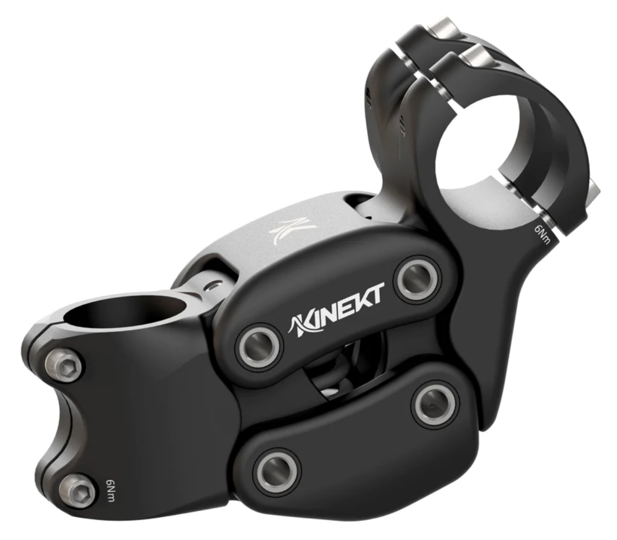

I have three of the Kinekt stems across my little fleet, and they are excellent. Not this new 50mm riser but their original version. Mine are the 90mm with the 30-degree rise, which is a pretty close competitor to the Redshift. This is the one I have:
I use the bumper extension thingie. Thats the extra-responsive elastomer plug mentioned above. My bikes are all lean-over where I am putting my upper body weight onto my handlebars and the elastomer plug is one of the two upgrades I am using to keep the bars from bottoming out on me (*ahem* I have a larger upper body than I used to in my 20's when I was cycling for reals every day). I also am using an extra strong spring recommended to me by Kinekt (stronger than the strongest one in the retail kit... but it may be included in currently sold units. Its the orange-striped one). The idea being I want the bars to stay suspended and not bottom out unless I hit something on the road. I am not using these with a suspension fork. I'd say that something like this only serves a purpose if you do not have front suspension (i.e. a fork).

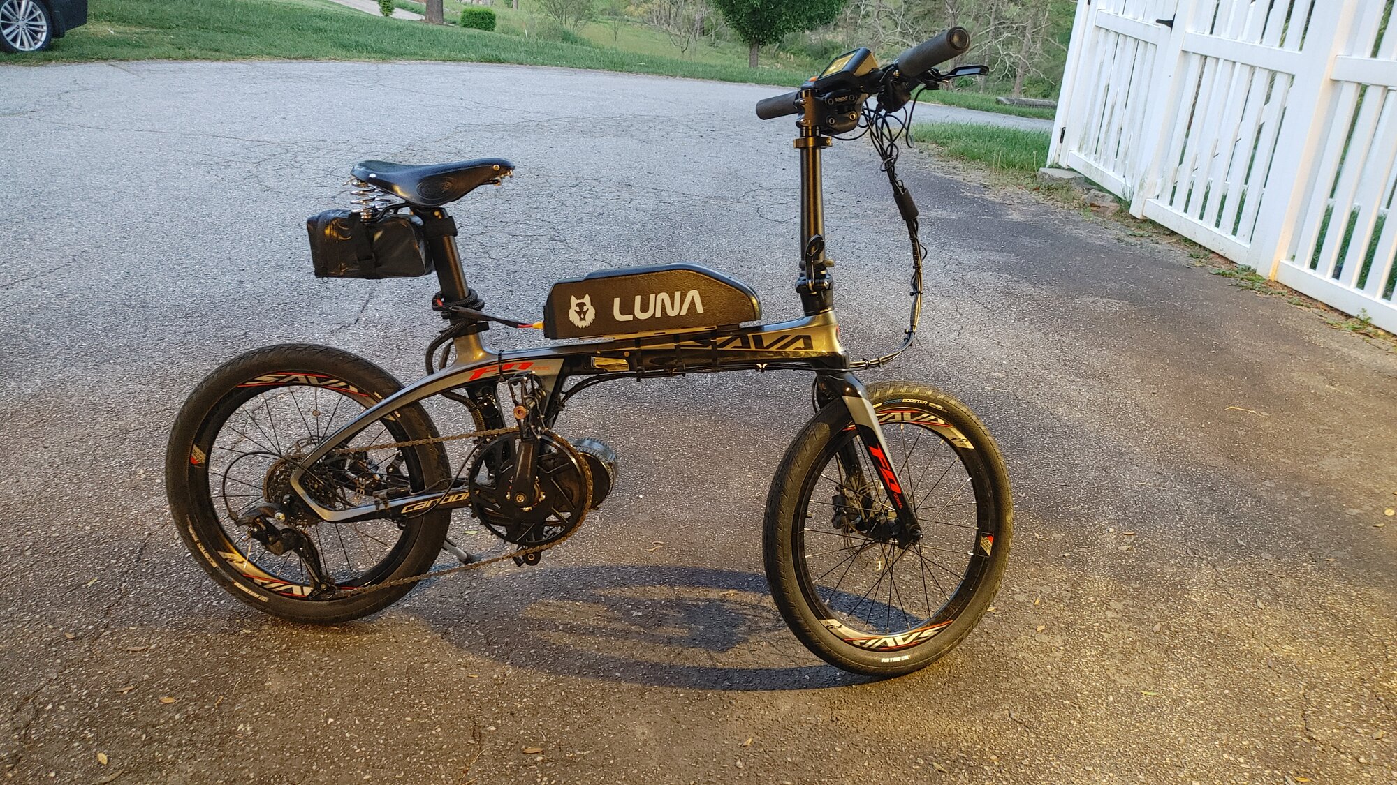

This little bike (see picture) was really rough hitting bumpy trails but adding the front stem really helped the hands a lot. I also like the Wolf Tooth Silicone Mountain bike grips, the fat paws , combined with the front stem really helped with the bumps. I did get an orange spring in my kit when purchased from Amazon. The quality of materials even the screws were more robust than the redshift system. The redshift had cheap low quality screws. Just from experiementing with both types of stems installing/uninstalling them the redshift screws were getting soft and the black coating was coming off. Not so with the Kinekt system , nice heavy duty screws provided with the kit. It's a heavy stem though so keep that in mind but well machined and the metal just feels more robust.

I haven't actually had a chance to ride with the Kinekt stem on my wife's bike. It actually makes her bike too tall to fit under the canopy on my pickup so I'm thinking of either getting her the RedShift stem or the regular Kinekt like shown in poste #4 above.
One thing I notice about the RedShift stem is that it rotates the bars a little rather than keeping the bars at the same orientation as the Kinekt does. With relatively straight bars, this isn't an issue and some people might not notice at all. It is something I expected and notice but it isn't annoying and I generally don't think about it.
