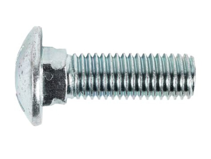

Yes! My Allant has the hex-head indentation on the wheel-side. The bolt and nut combo is the solution.
Thanks for everyone’s comments and advice.
Repair got slightly more complicated when I removed the front “slipping” bolt only to find out it was instead broken off within the frame. Buggers!

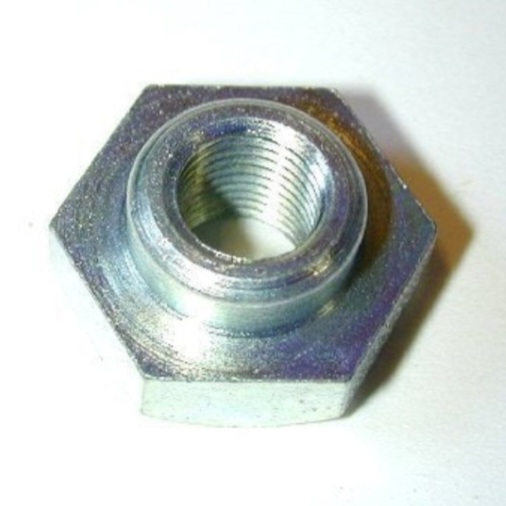

I'm pretty sure that your frame isn't threaded, and you've got something like this going on if you're hex-head indentation is being used.(and not just roughed in for a hex bolt/insert.)
It could have a closed end on it and looks like a bolt head.
If what broke off on the kickstand side looks like a broken bolt (not a nut) then the bolt probably threads into a threaded end cap.
It might be a little stuck, but a little tap should knock it out.
Then you can remove the broken stud from the end cap and replace the bolt.
Make sure you use the proper length bolt so it doesn't bottom out in the end cap but still has lots of threads to thread into the end cap.
