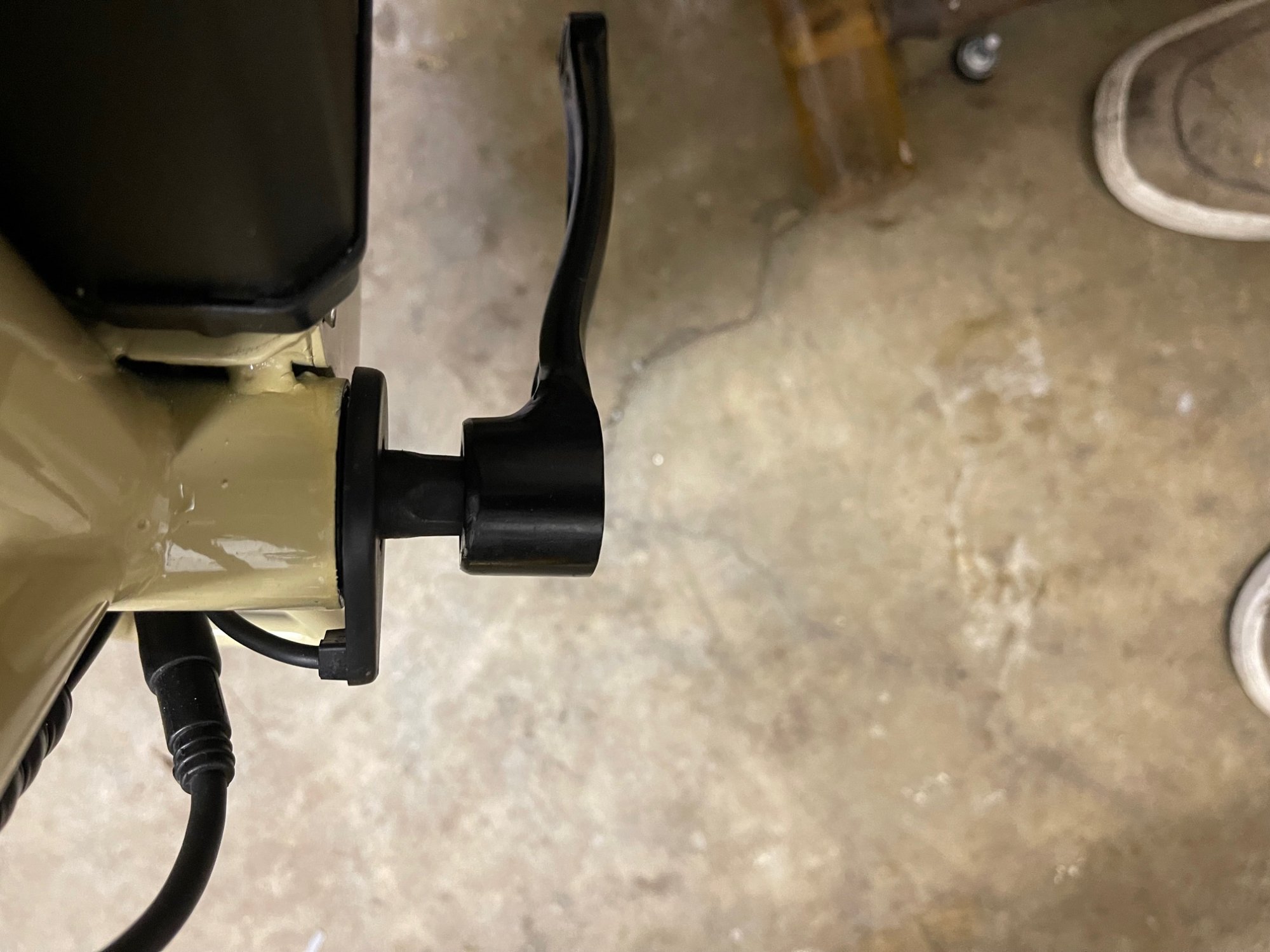

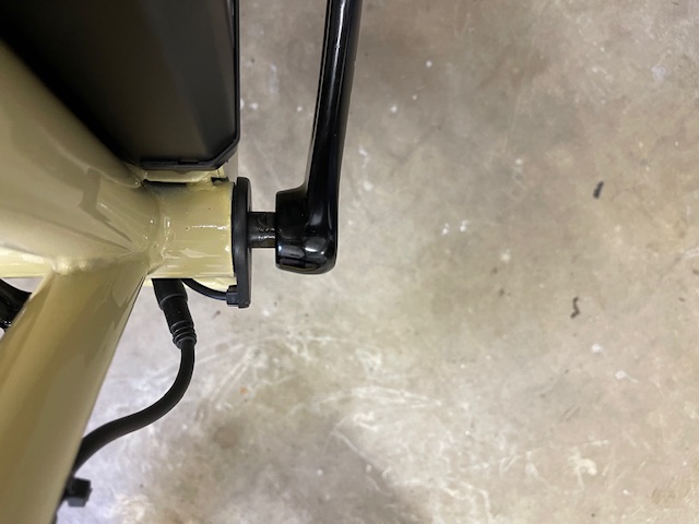

Hi,
The most curious thing happened as I was replacing my crank arms and gear for a larger size to help with ghost pedaling.
Both the gear and opposite arm came off very easily with the park tool.
When I went to replace the gear and associated arm neither would go on very far. I was afraid I was going to strip the hex bolt.
I then decided to replace them with the original set and had the same issue.
There is a couple of pictures. Thought I best stop and ask the experts.
The bike is a K6 Euybike but the fact that the original ones will not go on any further that the new ones is a puzzle.
My thought was to coat the spindle with Never-seize. I do have an impact wrench with the correct allen socket but from what I have read and videos it should not came to that.
Has anyone seen this before?
Those look like square taper cranks. Those have four flat sides. Is that what you have? If so, never lubricate square taper crank mating surfaces. Clean both the spindle ends and the insides of the cranks with a clean rag and isopropol alcohol. It's possible that your fit issue is due to the crank machining not being uniform on each side. The cranks may only fit on one way. Try the non-crank side first. Try each side until you get the fit you expect, then orient the crank side 180 degrees out from that. Tighten with a torque wrench. Do not use an impact wrench.

As mentioned earlier I would try rotating it and seeing which of the 4 possible positions it fit best in.

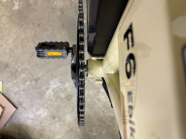

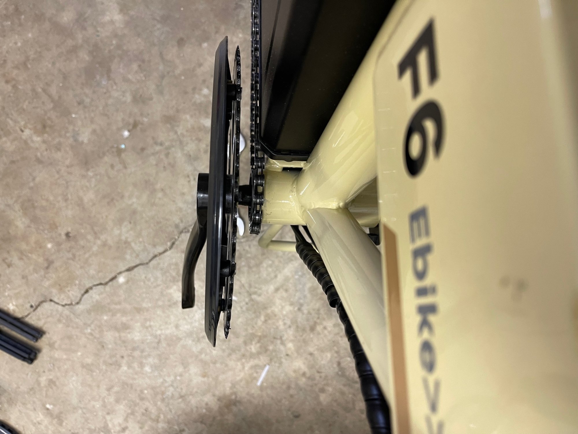

One issue I ran into was the new sprocket is a bit bigger, 54 teeth, but it seems the sprocket itself is set back or inward further. It was actually a blessing, not trying to get it fully on, in that the chain runs close to the battery on 1st gear and probably would been rubbing. I may try and find a different chainring.
A couple of pictures
To me it looks like you have enough clearance from the battery. How is the chainline?
You can put a piece of masking tape on the battery and this will tell you quickly after a ride if it is making contact with the chain.
If you look closely the chain gear has a ways to go before its fully seated. It would then be touching the battery.
