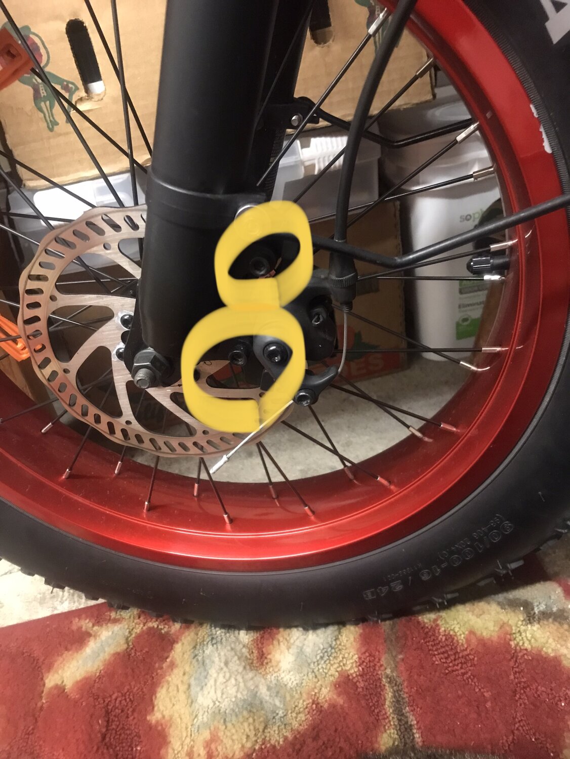

I want to buy the Juin Tech 1 cable actuated hydraulic brakes for my Cascade Cruiser by (Black Maxx), I have searched high and low for measurements of the mounting holes on the calipers and have come up with nothing.
The measurement for caliper bracket on my fork is 52mm, can anyone with these brakes verify the mounting hole distance ? For obvious reasons I don’t want to shell out $160.00 for something I’ll have to return 🥴…. I also apologize if this topic has already been discussed in these threads, I couldn’t find anything but I understand how frustrating it can be to see the same topic come up over and over…

Your fork has an IS mount.
Juin Tech is meant for post mount.
Maybe try to find an adapter?
Ok cool… Thank you, I’m pretty new to the E-bike world so I’m not familiar with an IS mount, I’ll Google it and see what I can find.
