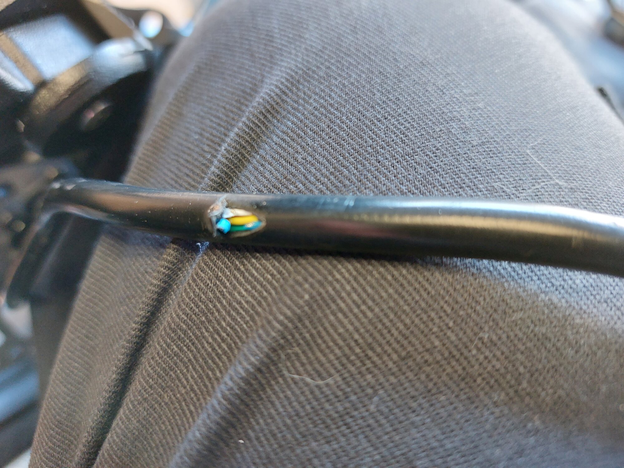

Yes, some deep breaths are needed it seems. Okay now, what exactly do you mean, you snipped the housing in the wire? Cut the insulation? Post some pics will be helpful and maybe it's an easy fix. Serenity now.
White and blue wires cut to hub.

I can't tell in the pic for sure, but it looks like you may have only cut the outer sheath and nicked the conductor wire's insulation. If so you should be able to carefully open the black insulation and wrap the exposed conductor wires. If they are almost cut through, it should be easy enough to repair with a bit of solder and some high quality tape. It's worth a try and if all is lost, how about a new cable to the hub. Mine has a dandy connector a few inches out of the hub. I'm sure a e bike repair shop would do a R&R on the cable if you bring in the part and wheel, if you don't want to try it. It would be a shame to sh*t can the bike over this issue, good luck.

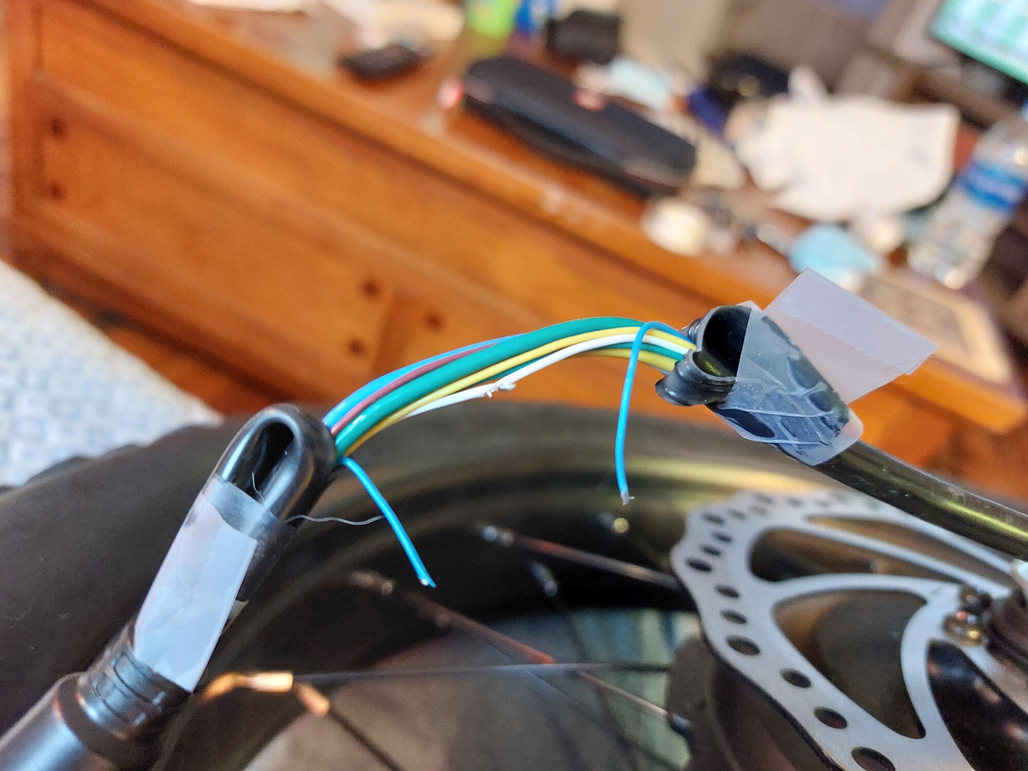

Better pictures (I hope) of my stupidity.
Tiny blue cut thru and white almost cut thru. I found solder seal butt connectors but I have to make sure "white" is a small enough gage. Will post my results when done.
Excellent! Make a good connection, Be sure the crimpers are compatible with the connectors, check all the wires in the vicinity to be sure, and then get some good insulating tape and "Bob's your uncle". Just how I would make the repair.
