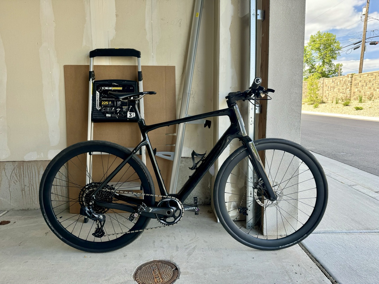

really a great looking bike. Looks super fun to ride! what’s the use case for a carbon frame flat bar bike with road tires and road bike geometry?
Now have full SRAM kit. SRAM NX cassette 11-50, GX AXS derailleur, Force 1 Carbon cranks, GX chain, and HS2 rotors. The only things stock on this bike now are the electronics, rims/tires, and the seat post.
The flat bar conversion was a PITA. I used an FSA ACR headset, FSA SMR/ACR stem 100mm, and FSA ACR compatible handlebars. I’m not even sure if the headset I used is available anymore. I’ve had it for a while. From it I only used the top bearing, compression ring, and top cap. The FSA headset and stock headset are not interchangeable even though they appear to be. For someone who doesn’t feel comfortable wrenching any reputable bike shop should be able to do the conversion. I am now done modding this bike. My total investment including the bike is around $3700.00 which I feel is well worth it. In stock form this bike is a bargain and the mods I’ve done are just icing on the cake.

The back wheel looks to be 32 spokes-is that correct?

Rear wheel has 36 spokes and the front 28 I believe. It’s either 28 or 32, I forget. Rear is definitively 36 spokes.

I can’t comment on mounting anything to the drop bars because I swapped them out for flats. As far as the power cutting out that’s not true. It will provide assistance up to 28 mph, then the motor cuts off. I‘ve never experienced any motor cut out with my bike until I hit that 28 mph speed. I’ve said before this is not a powerful Ebike. The assist is very subtle and you really don’t notice it until level 3. The best change I made to the bike is the smaller 38T front ring and 11-50 cassette. With only 42nm torque this greatly improved the bikes climbing and acceleration ability. What makes this bike is the light weight. I’ve done 10 to 15 mile rides and never turned the bike on. I just didn’t need the assistance. I use the assistance like a turbo boost, on to climb a steep hill, then back off on the flats. It’s perfect in that aspect and is ideal for the type of bike I wanted. If you’re used to 750w bikes and higher that catapult you up hills with little to no effort on your part, you probably won’t like the CF Racer.
