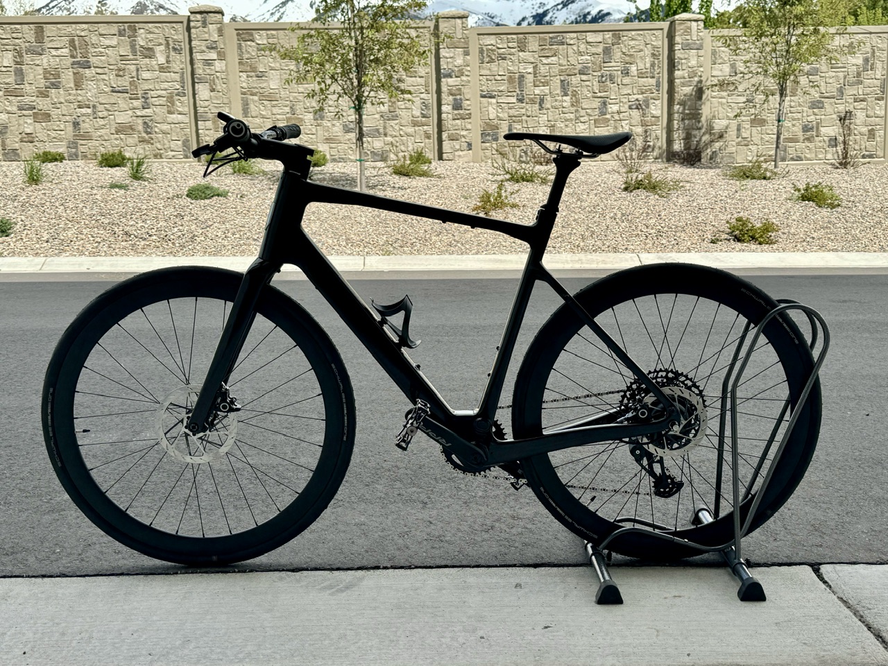

CF Racer1 Road Delivered Today

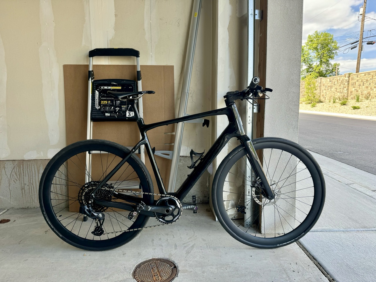

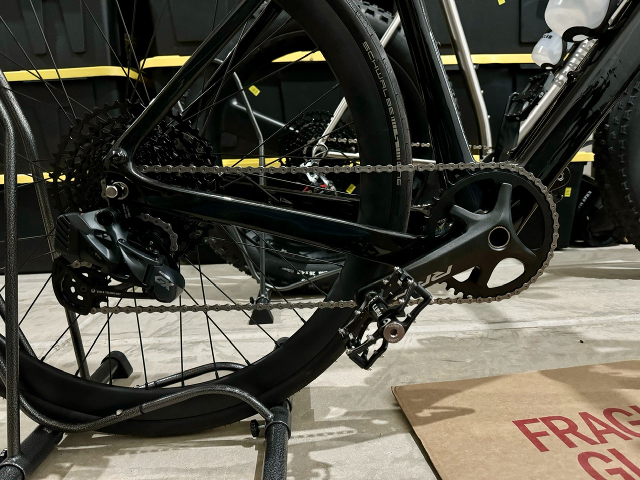

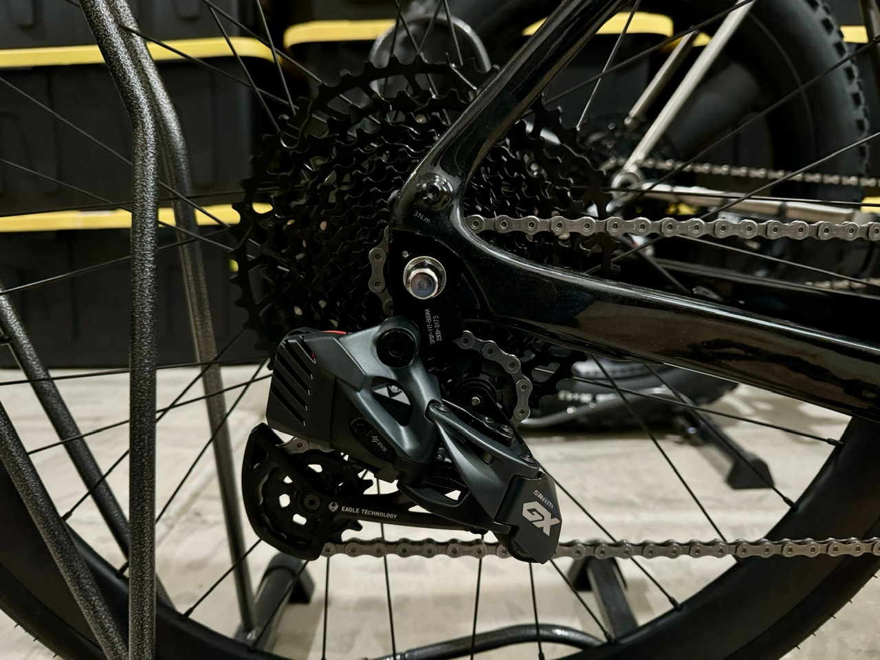

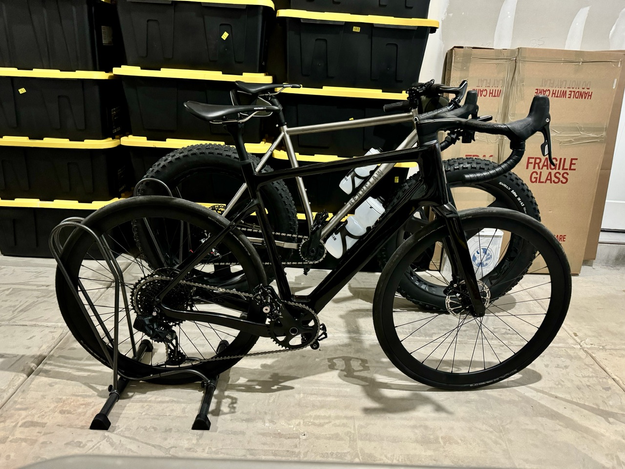

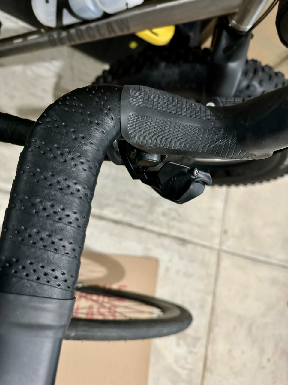

Conversion to SRAM NX/GX AXS is done! The GX shifter is temporarily mounted just for setup and tuning. The front brake lever hits it so I can’t ride the bike that way. I have some SRAM blips coming on Monday which I’ll mount on the underside of the flat part of the handlebars. They will be my main shifters. It all works nicely so now I have 11-50 gearing and electric wireless shifting. Eventually at some point I’ll convert to a flat MTB handlebar but that’s a ways out.

Now have full SRAM kit. SRAM NX cassette 11-50, GX AXS derailleur, Force 1 Carbon cranks, GX chain, and HS2 rotors. The only things stock on this bike now are the electronics, rims/tires, and the seat post.
The flat bar conversion was a PITA. I used an FSA ACR headset, FSA SMR/ACR stem 100mm, and FSA ACR compatible handlebars. I’m not even sure if the headset I used is available anymore. I’ve had it for a while. From it I only used the top bearing, compression ring, and top cap. The FSA headset and stock headset are not interchangeable even though they appear to be. For someone who doesn’t feel comfortable wrenching any reputable bike shop should be able to do the conversion. I am now done modding this bike. My total investment including the bike is around $3700.00 which I feel is well worth it. In stock form this bike is a bargain and the mods I’ve done are just icing on the cake.
