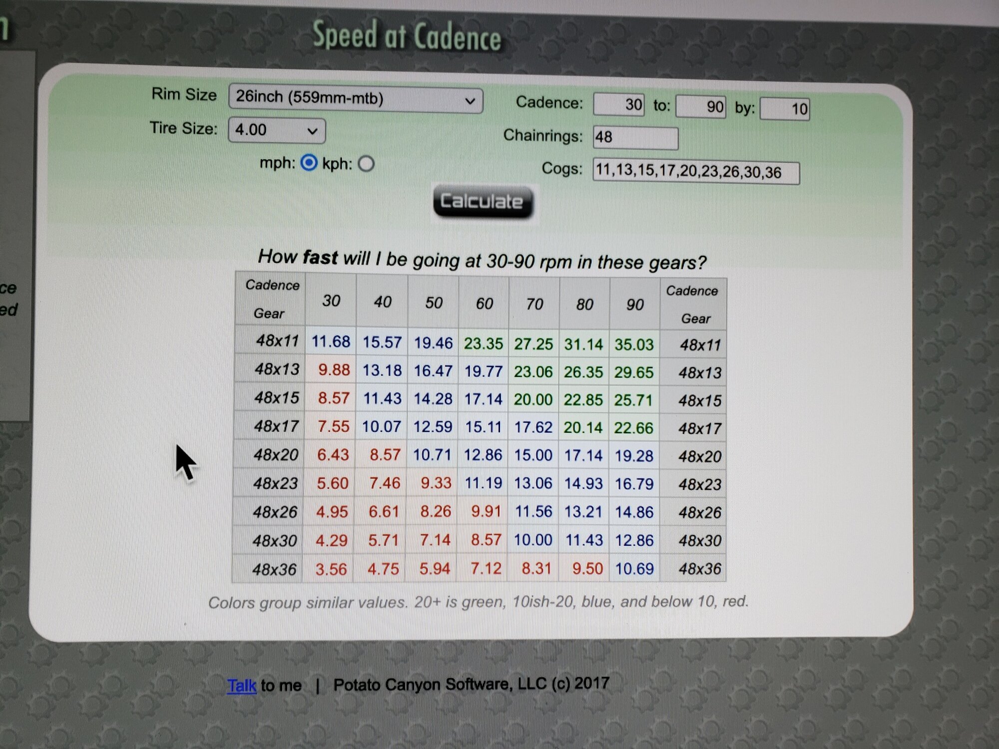

I see you have changed your chain ring from a 52 to a 48 which should help some but I feel if you are "struggling getting up some climbs" you will need to do more. Here is a comparison between your current bike and my bike. No where apples to apples but the gearing principles should be the same regardless of the type of drive unit.

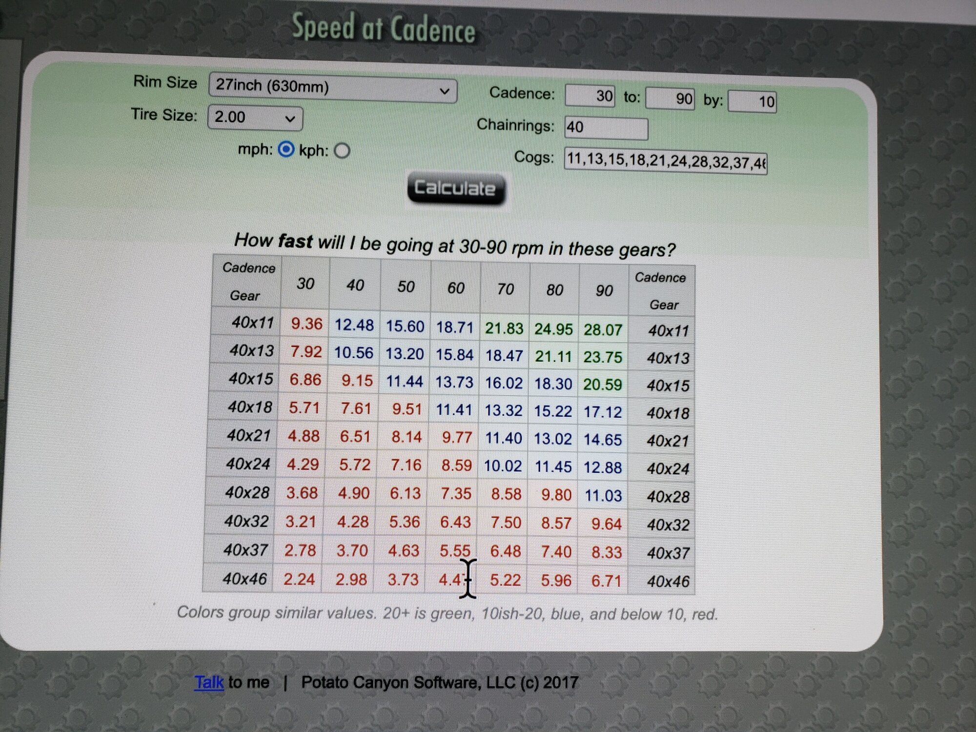

My chain ring is a 40t, upgraded from a 46t. The cassette is 11-46 upgraded from 11-42. I have no trouble climbing 10%+ grades with boost level Sport. I have never had to use Turbo which is the maximum boost available.
The goal of these calculations below was to determine the speed you will be riding at in a particular gear combination. One of my concerns was not to gear the bike so low that I would fall over when climbing. Typically around 3 m.p.h. is the tipping point for me.

This calculator is extremely helpful to make various comparisons easily.
