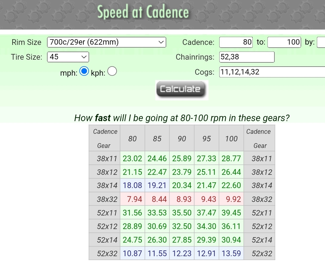

Finally got my bike back from the shop and tested a hill near me. It's a hill with an incline that's just moderate enough you'd pedal on the way down. Bike is stock with a 52t chainring. Went to near safe max pedal effort, and still didn't use the two highest gears/smallest cogs, 11t and 12t, and was definitely at a lower than ideal cadence on the 14t, maybe 80 rpm, vs my preferred 90-100. The 52t x 14t x 80 rpm is very similar in speed to 38t x 11t x 85-90rpm.
I'm in pretty good shape, decently strong, so i think the swap would be good for most, at least those not looking to go 30+ mph. As you guys have said, the stock choice of the 52t seems pretty indefensible. I kinda hesitate to discard perfectly good parts and I just had a bunch of part swaps so I'll hold off for now, maybe keep as a later gift to myself.

Finally got my bike back from the shop and tested a hill near me. It's a hill with an incline that's just moderate enough you'd pedal on the way down. Went to near safe max pedal effort, and still didn't use the two highest gears/smallest cogs, 11t and 12t, and was definitely at a lower than ideal cadence on the 14t, maybe 80 rpm, vs my preferred 90-100. The 52t x 14t x 80 rpm is very similar in speed to 38t x 11t x 85-90rpm.
Just to be clear, which chainring did you test here, 38t or 52t?
You're probaby a stronger rider than I am. Overall, keeping my 11-34t cassette and reducing the chainring from 42t to 38t has been a big win at this stage in my return to cycling. Occasionally miss the 105-inch top gear I gave up but pat myself on the back daily for the 30-inch low gear I gained.

Ah, edited to add that I have the 52t stock chainring.
I find 52x11 on my new CCX overkill but I thought 52x12 was fine for 28mph cruising on flat ground on my CC. Back in my road cycling days I could spin out 50x11 descending hill at >30mph but I don’t like spinning at a cadence of over 90rpm. I thought about putting a 48T chain ring on my older CC but never got around to it. I’ve thought about putting an 11sp mountain bike setup on my new CCX but I don’t need super wide cassette gearing.

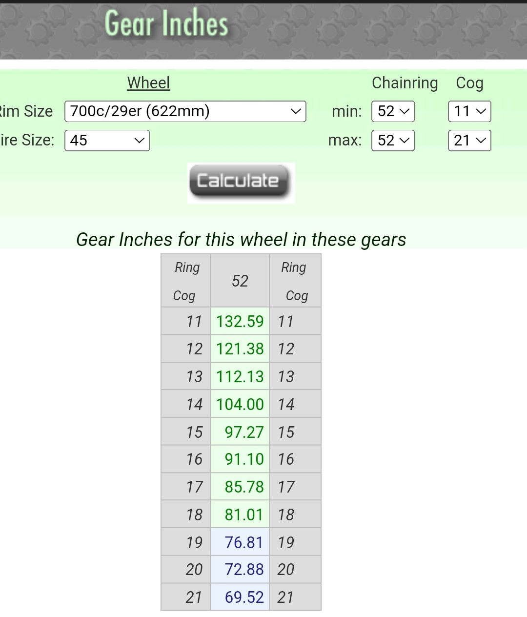

Curious, @Asher and @Dunbar , what diameter wheels are you running? (Actual diameter, please. Somebody changed tire size designations while I wasn't looking.)
I am running the stock IA-2209 innova that came with the bike, 622-47 in the back. I am going to attempt a 622-55 schwalbe I bought, but only after I wear down the stock tire, in 1000+ miles.
In the front I have a 584-60 schwalbe efficiency with a proterra light i25 wheel. But the front wheel doesn't affect the drivetrain speed.
So your actual rear wheel diameter is 622 mm = 24.5 inches?
If so, your top 52/11 gear comes out to 116 gear-inches -- 11" bigger than my stock top gear (105") and 21" bigger than my current top gear (95"). The 52/12 is 106", and the 52/14 is 91".
With a preferred cadence of 70-80 RPM, I'd get a good bit of use out of the 52/14 in the terrain I ride, but not the other two.
Yes but it's the wheel + tire diameter that matters, with tire width and height about equal. 622+ 47 +47 = 716mm = 28.2 inches.
I get ~133 gear inches for the 11t x 52t
Wow, 133" is one big gear!

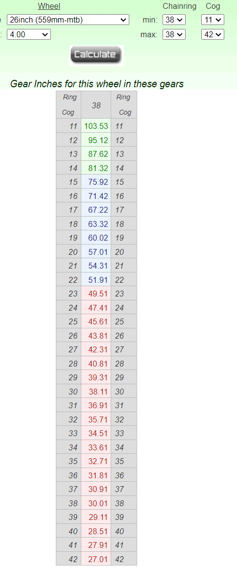

Declaring my chainring downsize from 42t to 38t a rousing success. With the stock 27.5" wheels and 11-34t 9-speed cassette, that left me with gears from 30.7" to 95.0".
Using RideWithGPS, planned out a nearby 4.1 mi test loop with 355' of climbing on grades up to 10.6%. The loop is typical of half the terrain I ride near my house.
Rode the loop 4 times as a final test on known grades. Wouldn't have minded a lower 1st gear on the 10% pitch, but the 30.7" low gear worked well enough. (Kept cadence above 55-60 rpm, and that kept my knees from mutiny.) Never once wished for a bigger top gear, though wouldn't want to go smaller than 95" there.
That's great news. I have 103.5 to 35.7 gear inches on my RipCurrent S with the 38T chainring and the stock 11-32 cassette.
My next decision will be when do I upgrade the cassette and possibly the derailleur (if I want to go lower than 31.8 gear inches). The LTWOO A5 derailleur is rated for a max of 36 teeth on the cassette. I definitely wish for less than the 35.7 gear inches I have now. Question is whether I will be satisfied with a 36t max cassette at 31.8 gear inches or do I just go ahead and replace the A5 with an A7 (like $20 on Amazon) along with a 11-42t cassette to get to 27 gear inches.

How about a 36t chainring? Do you get much use out of the 103.5" top gear?
Forgot to mention that my new gearing allowed me to do the aforementioned test loop 3 times at PAS 1/9. Wouldn't say comfortably, but tolerably. And I'm not a strong rider (though getting stronger).

I do enough mixed riding that I do use the max 103.5 top gear when I commute to work. So far the low gearing is working even on the single tracks. At this time, I'm not seeing the need to change the rear cassette. If and when the derailleur or cassette wears out/breaks then I'm adjust the gearing further.
