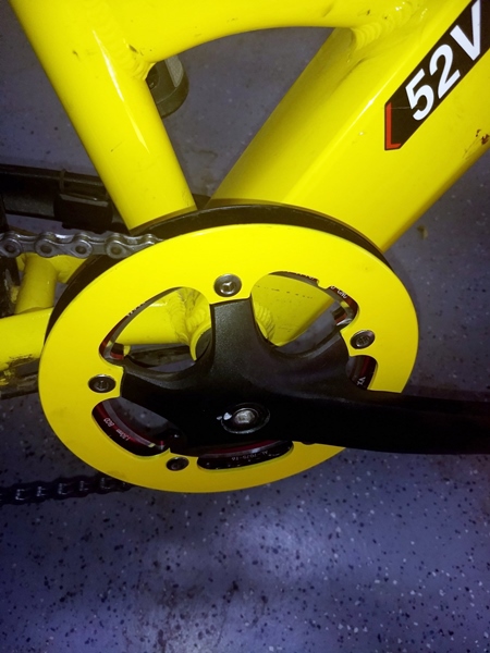

I bought a 38 tooth chainring from Bikeinn to replace the stock 52 tooth. Took 40 days to arrive because it was not in stock at the time. Installation was easy with Allan key and the chain breaking tool to remove 4 links. I re-used the original chain ring guard plates. I put one chain ring guard on first, and the chain ring behind the 5 crank "fingers", then the other chain ring guard in front of the crank fingers. Then I put all 5 bolts in very loose to hold everything temporarily in place. Then I removed one bolt at a time and inserted the sleeves and tightened up. The chain does not rub on the guards even in the lowest or highest gear. The chain just touches the ends of the 5 fingers but does not cause a problem. Eventually I'll get smaller guard plates to give me a bit more clearance, such as when I walk the bike across a railroad track where there is no crossing. I might get a guard slightly bigger than 38, maybe 40 which may protect the chain ring a bit more. They have them at Aliexpress for about $40 for two. Search for "Folding Bike Chain Guard 130 BCD Aluminum Alloy 38T". I notice a slight improvement on hills from the 52 to 38 tooth chain ring but it is not as much of a difference as I expected. With 52 tooth, I could barely struggle up a 6% grade without any assist, now I can barely get up 8%. With assist, it feels like the sensor is getting more torque from my pedalling so it boosts the power more on hills. I haven't had a chance to ride in the highest gear but I expect it will still be plenty fast without spinning out.

If you don't plan on riding on single track trails, a 42T would probably work better. To be honest, I still can go 28 mph + at 92 cadence. It's is pretty rare that I feel I wish I had anything higher than the 38T ring.
Thanks for your help and encouragement. Am now using the 38T YBEKI chain ring you are using. The low grades are easier on my RCS, steep grades are still hard for me in ECO mode. I purchased "42T Bash Rings" from Chain Reaction Cycles in England -- two for 3.18 pounds shipped. Painted outside one with Rust-oleum Gloss Protective Enamel. Used 3mm spacers instead of the stock 5mm ones, but reused the stock bolts. Bent the inner protective ring a small amount with a wood block and hammer as it was close to rubbing on the chain when on the lowest cassette gear.

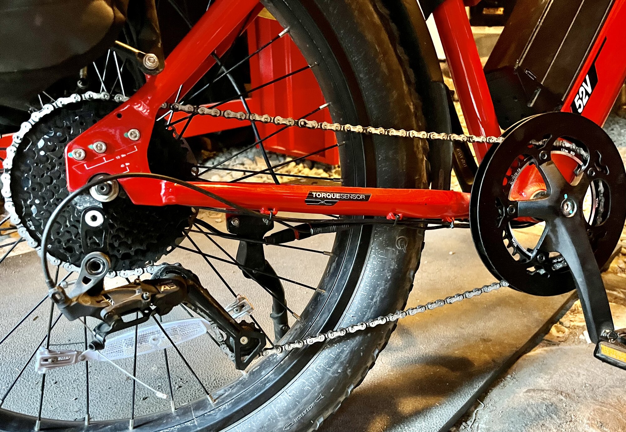

I just put a 38mm front chainring and 11-42t cassette on my RCS. Had to add a derailleur mount extender to get the cage to clear the biggest rear cog. Works fine and looks like about 28 mph is top speed with reasonable cadence.

My impression is that at 34 teeth the L5 derailleur is maxed out. I didn’t change the derailleur per se, rather I installed the extender mount. It is the black part to which the derailleur is mounted, the other end is fastened to the frame. $9 from Amazon.
